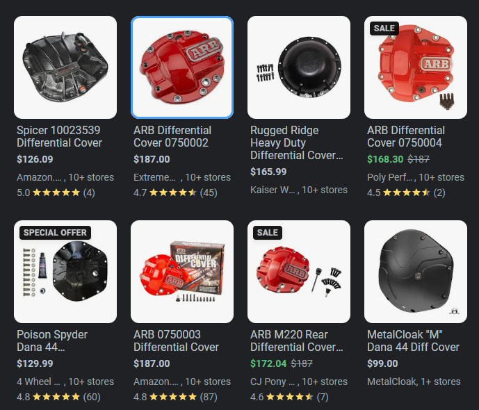

Now if you're talking about diff "COVERS" that's a different issue. Factory is usually stamped steel. Smack a rock or stump on one of those and it will push the cover into the ring gear and ruin your day. There are plenty of aftermarket HD COVERs available in steel and aluminum. ARB, Poison Spider, etc. The world is your oyster.
