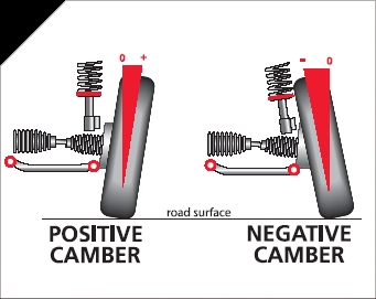

Camber & caster are front end alignment terms. Caster is how many degrees the front balljoints lean back...
attachment.php
Camber is how many degrees the tire leans inward, as looking from the front...
attachment.php

That would make sense. It is turned some because of the wedges on the springs
