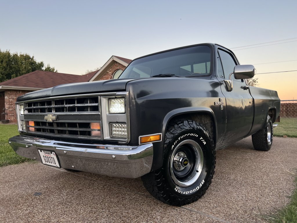

So let's break this down for more detail. How many miles are on the truck (or you think are on the truck)? Is it stock height? What tires are you running (size and load rating details please)? What makes you think the springs and leafs need to be replaced? How about throwing up a picture of the truck to help.

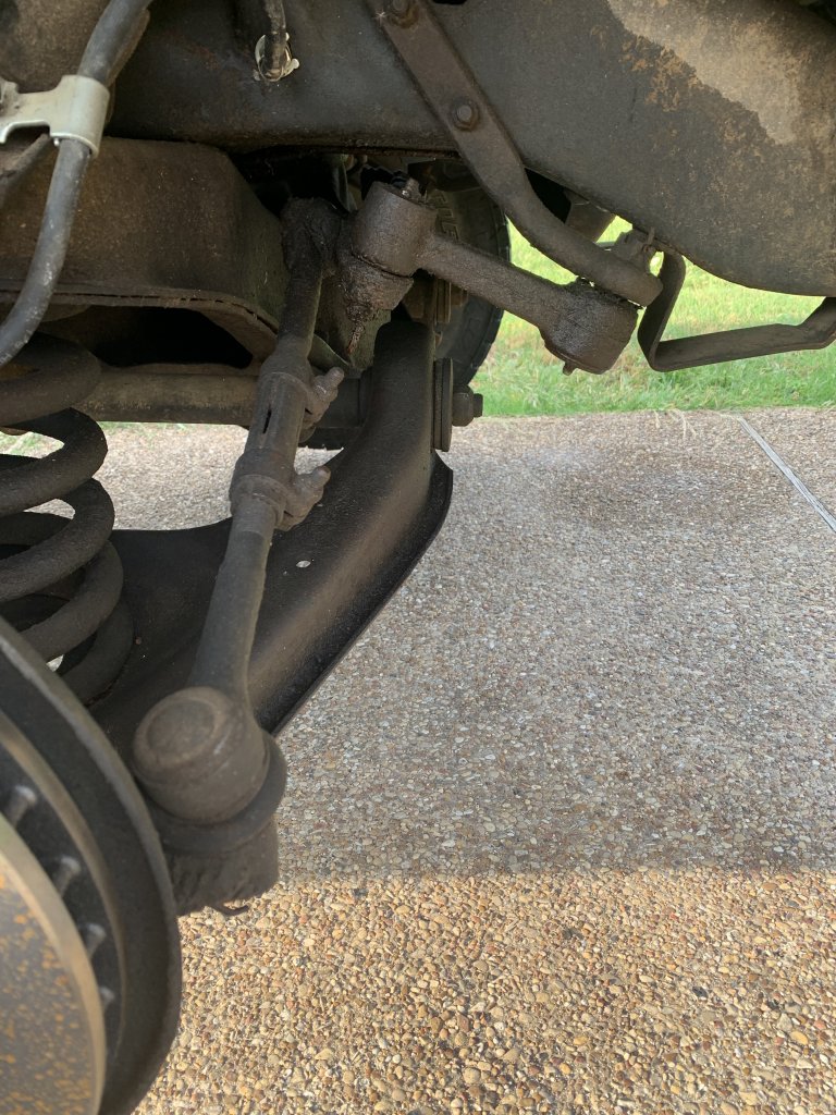

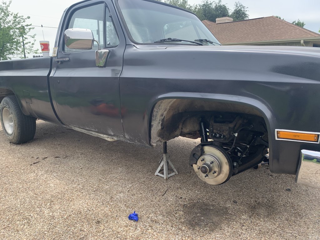

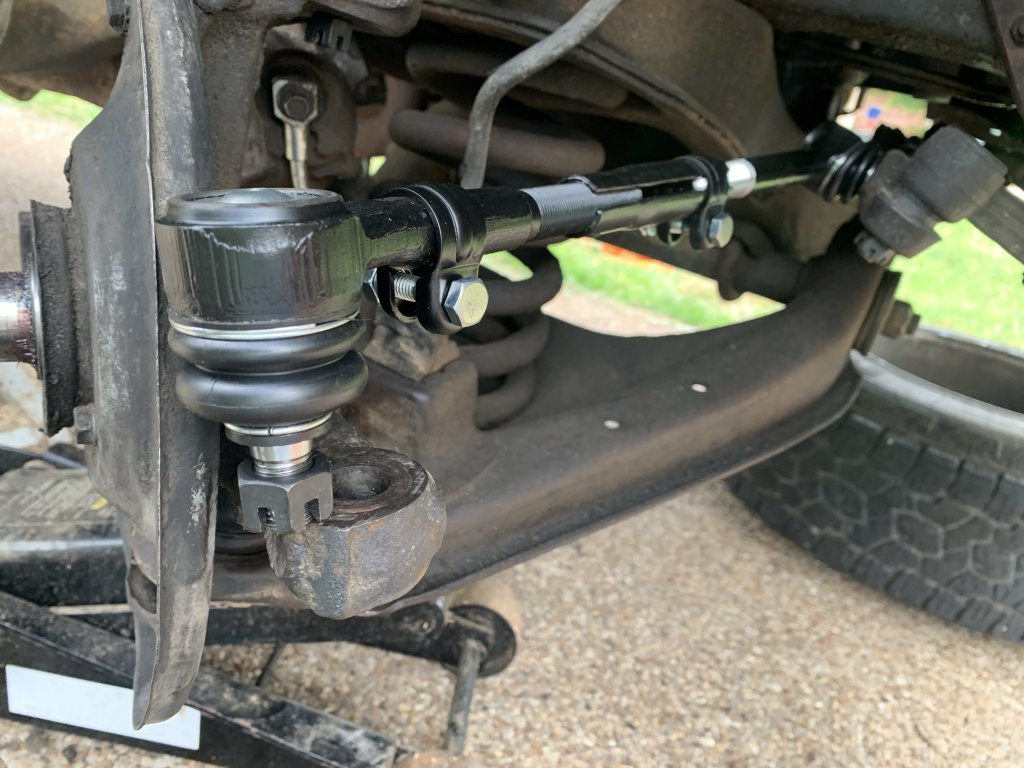

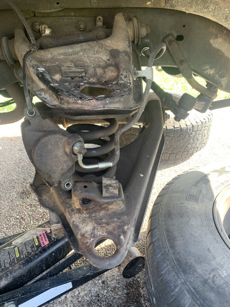

It’s an old work truck. Miles are non relevant. Bought used with no idea how many times it rolled over. I’m thinking 190k at least. Tires are 33x50x15(?) (EDIT: 31x10.50x15) close anyway on 15in stock wheels. My profile is truck but I’ll try to upload the $hitbox it is. It is her daily now but doesnt travel further than 50mi a day. Everything suspension is stock, hell, everything is stock. Nothing appears replaced accept the front end that we did when we purchased and we didnt do the coil springs. Didnt think they absolutely needed to be changed. I’ve changed my mind. Thanks!

Those look like 31-10.5-15 tires.
For those tires and that truck which weighs about 2600-2800 front and 1600lbs rear, curb weight, 25 psi is adequate for full load in front and 15-20 psi rear. Knowing 15-20psi is arguably too low for highway driving, 25psi at all 4 corners or 30psi up front…MAX for best handling.
My 78 (bout the same weight) with the old 235-75-15s was comfortable at 25F/20R, empty truck. Handling was slightly squishy at those pressures but plush. Those tires have a slightly higher load rating per psi than 31-10.50-15s.
What tire pressures are you currently running?

OP still didn't address how big the rear leaf packs are. But looking at those pictures, I'd point the blame toward the tires. Those are way too big and I'd put money on them being load range E (10-ply) which is completely unnecessary on one of these half tons.

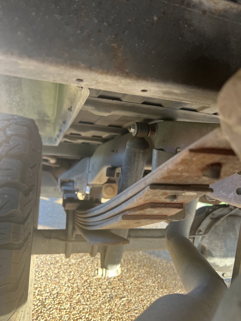

I dont know what the leaf package is, I assume it’s stock. Here is a pic of it.
