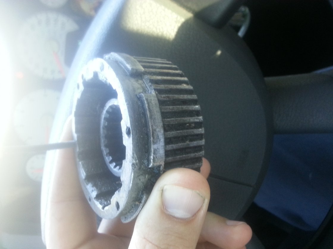

Im looking for a locking hub for 1987 gmc 1500 high sierra. Any
idea on where to find one at.
