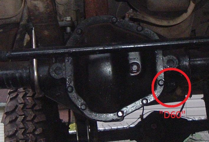

3 u-bolts on the D60, also the D60 has kingpins and no balljoints (newer ones do though). D60 has "D60" embossed on the webbing facing forward.
attachment.php

Less than 1/4 the way down the page on the link I posted shows a diagram of where and what the different stampings mean. I assume the one you're talking about is on the lower passenger side webbing, mine has it too you can see it in the pic. I dont guess it means anything since it is not mentioned in the diagram.
