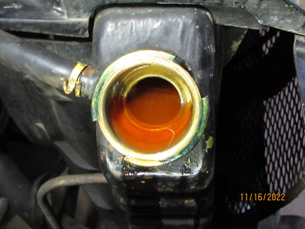

I need some advice on adding/replacing coolant for my 1975 Pontiac Parisienne (‘Cheviac’) and a plug gap query.
I have a weep in the passenger side rad tank fitting that receives the upper trans cooler line flare nut; the rad has to come out to re-solder the female fitting; when I complete the repair, I will have to add coolant. The coolant present is clean, and safe down to – 50; however, it is a dark peach colour (images attached). The coolant recovery tank hose has an odd slimy residue, and the hose material is soft and swollen. Can I add Universal Coolant, or do I have to flush the system? I have universal coolant in rest of my antiques roadshow. The “GM compatible" products available at Canadian Tire are only compatible back to 1996.

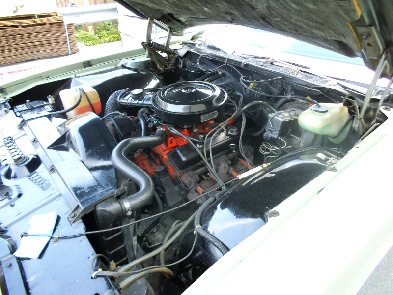

As a Canadian Pontiac the engine is a 400 SBC “Orange Engine” code U (images attached); I will be replacing the plugs this winter with AC Delco R44TXs, (1975 only) gap of 60 thou. I am wondering if a gap of 35 to 45 thou might be an improvement. Thanks, Pete.

looks like someone used Dexcool in that.
If your rad is coming out, may be a good idea to get it cleaned and tested for leaks. Dexcool isnt bad per se, but copper/brass radiators benefit from the abrasive short term use of green coolant. Being it looks clean, its probably not been in there all that long or if it has its been sitting more than circulating.
A good flush and fill with green would be my recommendation. The hoses should be replaced , all that exist due to age and swelling. most of the universal coolants from the store are Dexcool but different label different name. Not all.
But if yoiu want to maintain universal coolant in your fleet, then post up what one you use and we can give a recommendation one way or another. But generally speaking.. if that coolant isnt corrosive to lead and solder, then its probably OK

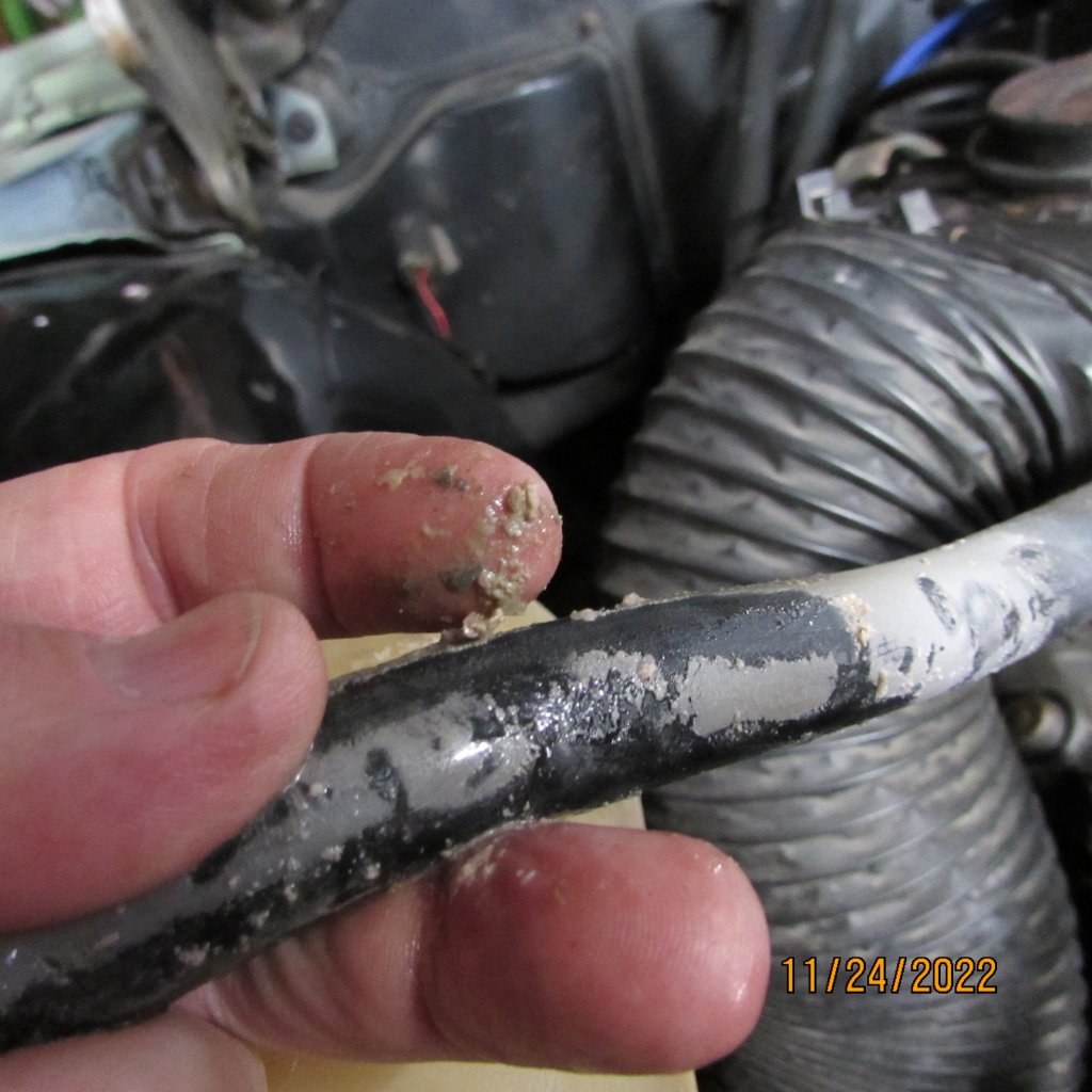

not shown well in this photo but this coolant was opaque, you couldnt see through it like you should be able to. hard water and 2 types of coolant + some corrosion and junk from a boat anchor + a couple years

@Pmac, generally orange colored (or yellow, pink, purple, blue) are some type of OAT or HOAT coolant. Since not all are compatible with others and you have no way of determining what’s in it, even though it looks very clean and clear in your pic, you’re saving potential future issues by dumping it.
As said above, best way is to clean and flush it before you do the (minor it appears) repairs. And then refill with the coolant of your choice.
