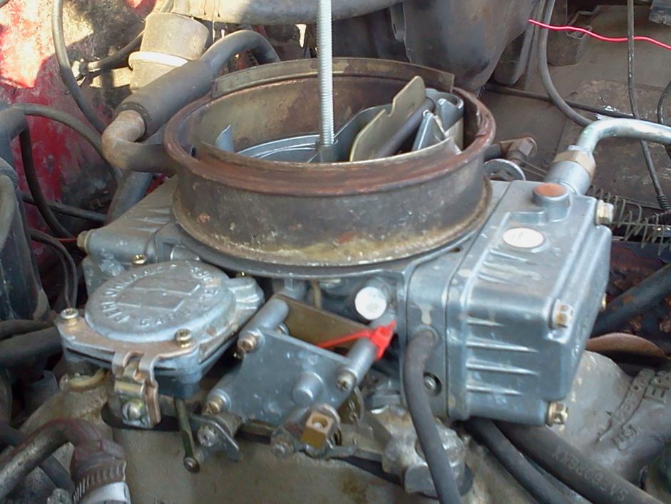

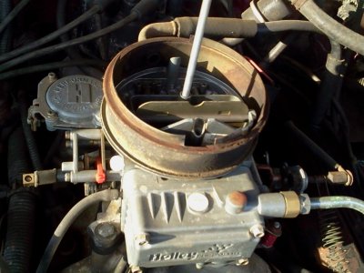

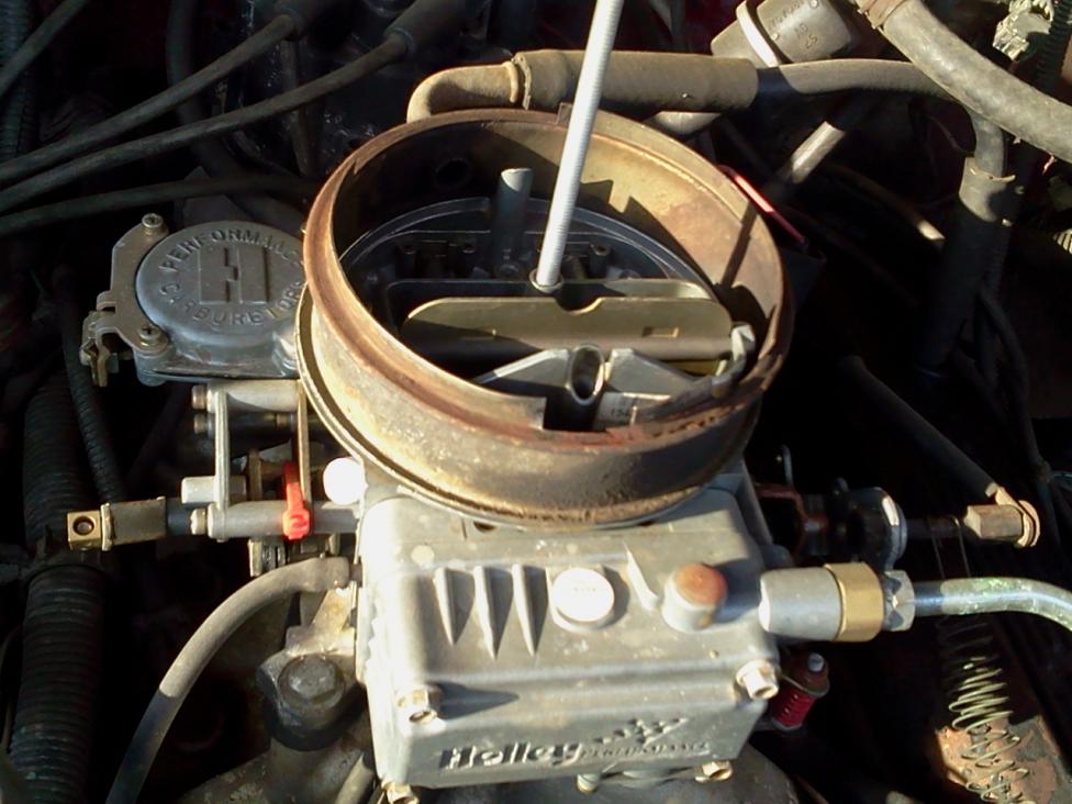

So, I just got home and looked at the carb. Here is a pic: From what it looks like to me, it is a manual choke carb and the guy who owned it before me who converted it to a carb zip tied the choke wide open?!? So am I to assume that if I bought a choke cable and brought it inside the truck, I would have a much easier time getting it started in colder weather? I assume I would still have to nurse it to get it going in very cold weather though.
yup...snot hooked up. you can get an E choke kit for it pretty cheap.
47,132
9,331
Personally, Auto Choke is overrated and it fails, sticks and needs adjusting blah blah blah, I'd rock the manual choke if it were me. 90% choke to start it, then push it half in for about the frist 3-5 miles, then push it in all the way and be done. JMO :shurg:
I'd imagine a choke cable can't be but about $10 and alot simpler to install.. Once installed, hard cold starts a thing of the past.

This is my first automatic choke. I don't particularly like it, I would rather have a manual choke.. but this is what I was dealt.
Run a choke cable into the cab. You can buy a cable at your local auto parts store then get rid of that zip tie. What's up with the carb hat?
47,132
9,331
Yep, being he's already got the manual choke carb, that's exactly what I'd do.
He will find it much simpler to install, no adjustment BS, and really, it's very easy to operate and much much more dependable than Auto Choke.
