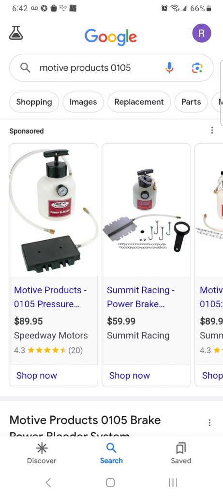

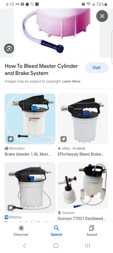

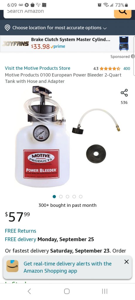

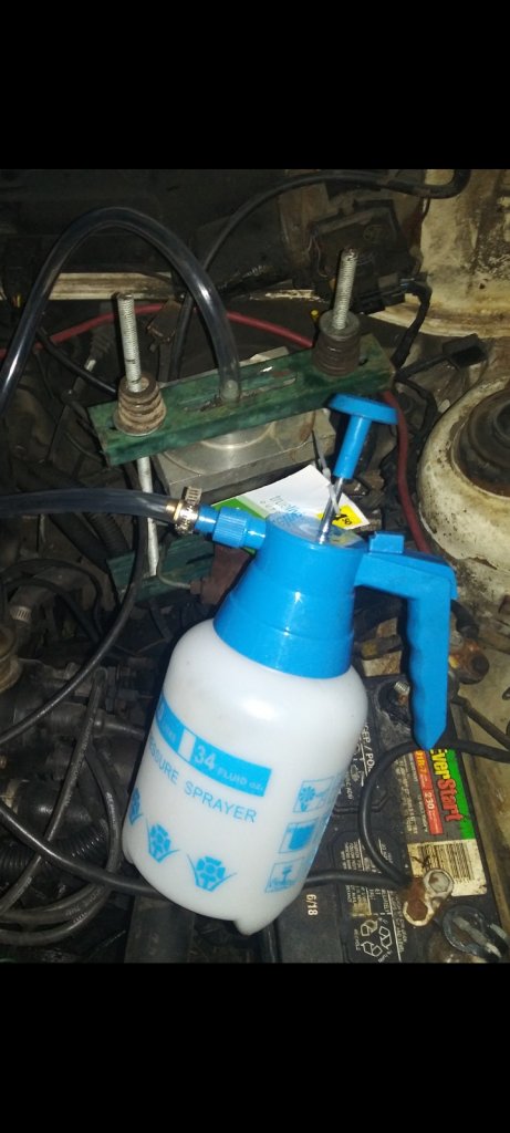

If you are creative you can make a brake fluid exchanger out of a garden sprayer. Brb with details and pics. One is pressure one is vacuum. I've used both at work. I like pressure better. Made one for home use I'll find a pic. Home made a piece of scrap aluminum plate with rubber glued to it some all thread a fitting and a 4 dollar garden sprayer. Internet search motive products 0105 and 1105. If you better pics of my home brewed rig. Let me know.
