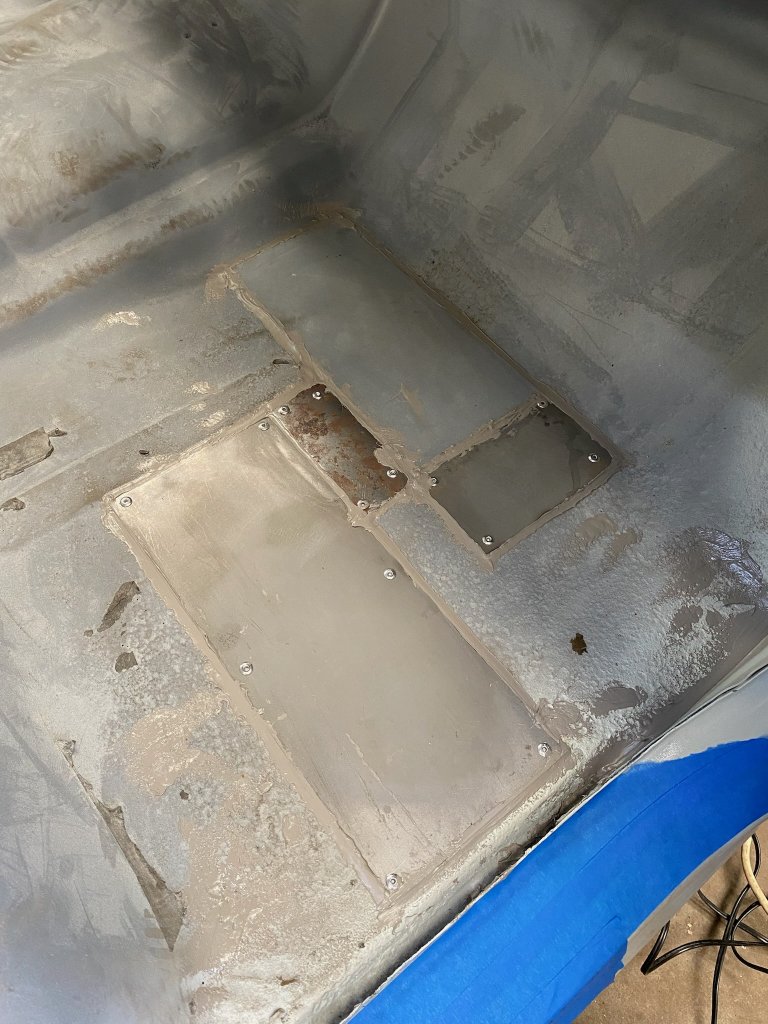

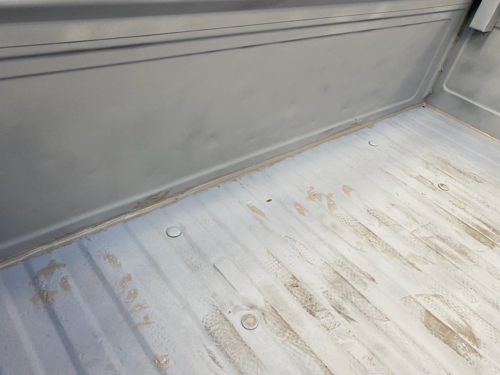

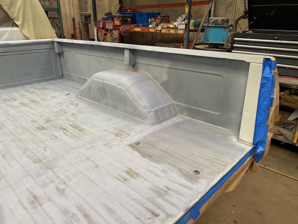

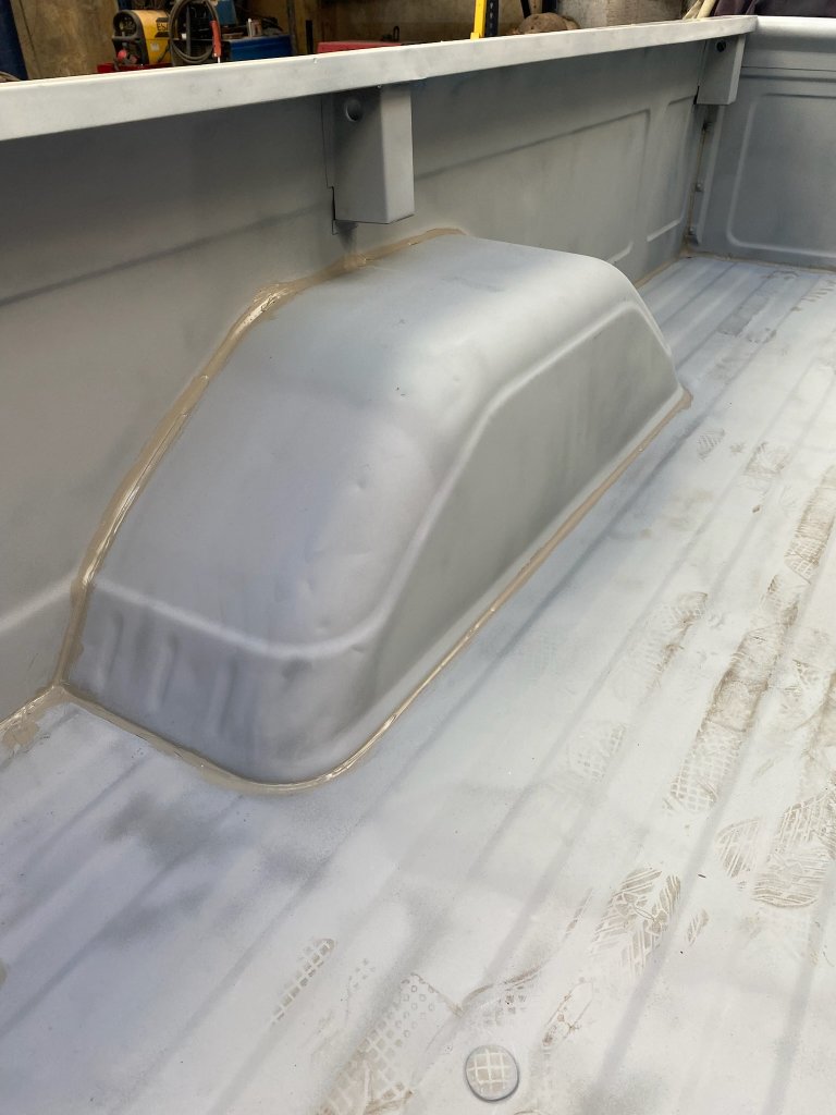

We used NP1. Got it in a bunch of colors at Lowe’s about $7 a tube. Used it on cab floor repair sealing top and bottom and bed seams before rhino lining. It’s been over a year and we are water tight everywhere and no cracking even in Texas heat.
