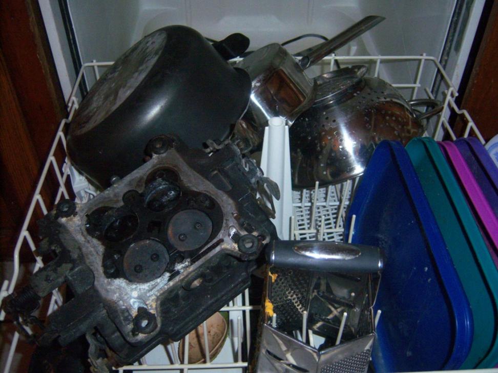

yes thats a dishwasher rack. I was rockin on my rebuild until I discovered I was missing gaskets, they are pictured on the box. The inside of the carb through the bowls had silt so I figured I would try this and see what happens.
My thoughts...... its like a parts cleaner only without chemicals, my parts may come out sparkley clean. I have never herd of anyone doing this.

I put the smaller parts in the silverware compartment, I want them clean too. As soon as my dish washer stops I will update.

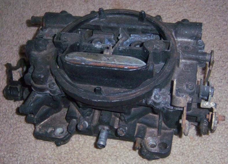

47,128
9,299
Beleive it or not. I did this just last week. That old burnt carb off the burnt brown truck. I wanted to see if the dishwasher would clean that **** off of it. I even used the Pots and Pan cycle. Didn't work to well, but its clean as hell. So are the dishes, so no harm done.
