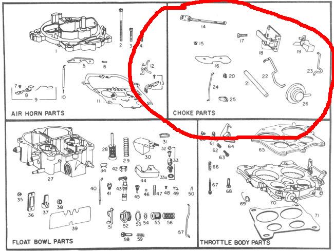

Looks like you are missing every part of the choke. The butterfly plate, all the linkage, the choke thermostat. I don't know if you can buy that stuff new, most likely have to find a carb at a junkyard. And if you don;t know what you are looking for and how to put it together then don't waste your time.
I think you will be better off just getting a replacement carb.

The problem is he doesn;t understand the parts and how they go together, that's the only reason I mentioned getting a replacement to make it easier on his brain. :lol:
So if we are going to talk him into doing it himself let's get some pics up for him to give him an idea. :shitsweak: :slap:

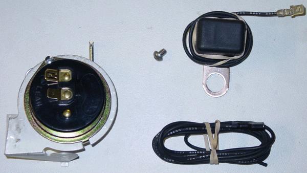

Dude needs these:
attachment.php

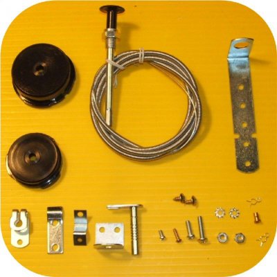

And eithier one of these: :crazy:
attachment.php
attachment.php
