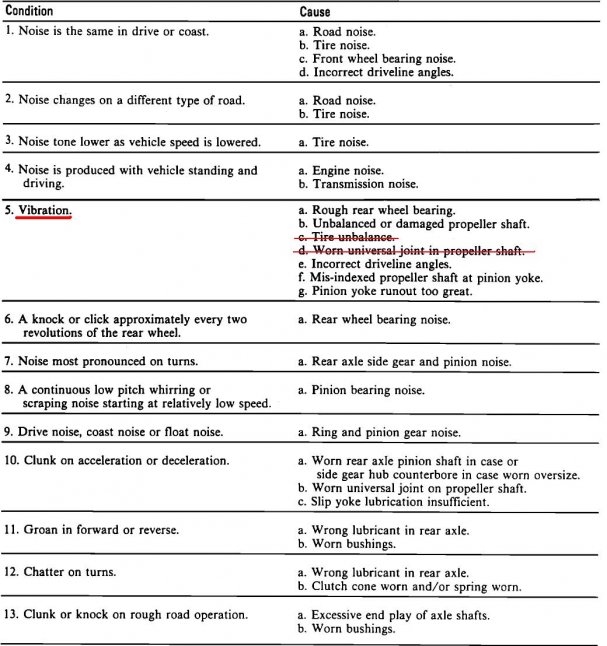

Assume the axle was bought as a used (as is) part - correct?
Have you checked the outer bearings for excess play?
Gm service manual lists "rough bearings" as the first thing to check when diagnosing a vibration problem in the rear axle area.
