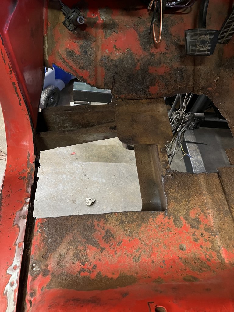

Cab is currently on a rotisserie (which is awesome). I will begin the cutting and replacement of floor, rockers and kick panels (one side at a time). Looking for advice on stabilizing cab to keep square. Was thinking of using boat stands with the cab still on rotisserie to keep level or putting back in the frame. What’s the safest way?

When I cut out major sections like rockers etc. I weld angle iron across the inside of the door opening as low as I can and still be able to work.Cut your angle and grind the welds after you are done

And if you are cutting out a lot on either side, like rockers, floor pans and cab supports, it wouldn't hurt to weld in a length of angle iron across the cab to tie both lower a-pillars together.

That's a dam good idea,I never thought of it and never had a problem,but if a person welded angle across both door openings and then welded angle to that across the cab front and back of the door openings,that cab would be stable enough to do anything to.
