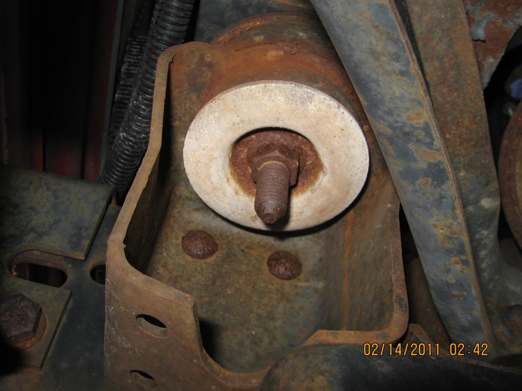

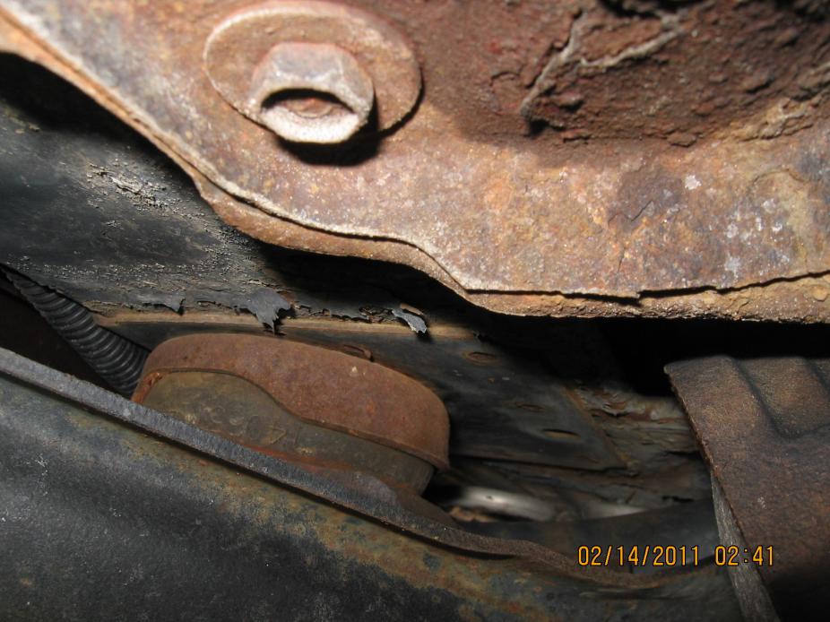

They should match the rest buddy. Here's pics of my front mounts. Looks like the grill has to come off to get to the bolt on the top. :popcorn:

That is the instructions that came with it, so you think they would fit the radator support?
24,809
6,738
Absoloutely, they should work just fine.
