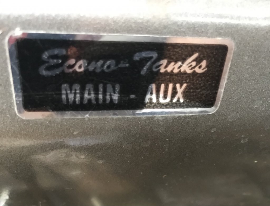

Here’s the decal in the cab there’s a large toggle switch below it. Then it has a smaller identical decal below the toggle switch.

^Definitely an aftermarket option.
Does it appear that the truck was originally a dual tank truck? (Likely not because that would be a lot of effort just to not have to pull around the gas station to fill the other tank)
Hard to believe anyone would order (dealer or customer) a big block dually without the second tank.
Curious to see how well it works. Considering it looks like a legit aftermarket option at the time, it should work?
