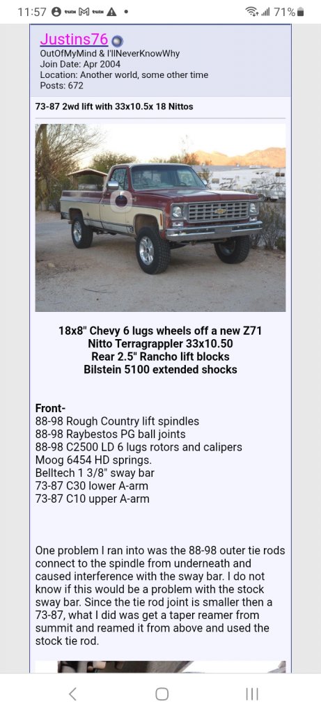

See attached photo, I know lifting a C10 isn’t common but I was able to order 4.5” direct replacement lift spindles so they make em for someone……Anyways, I put 32x11.5x15’s on it and I don’t hate it, but still a lot of free space in the wheel well so left with a blah outcome to some degree. Anyone ever lifted a C10 4.5 inches and have tire experience. I’m certain 33x12.5’s would fit but if 35’s or maybe 36’s would fill the wells better, let me know. Already swapped the stock 3.08 to 3.73.
