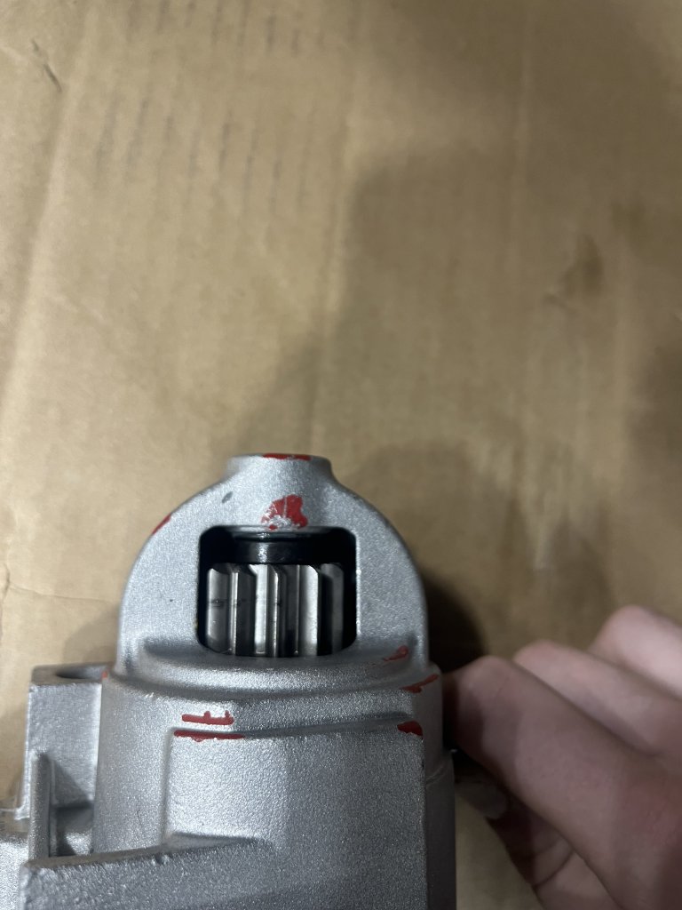

So does the starter grind/make horrible noises or everything functions correctly and you're just worried about it only engaging halfway? Cuz if it were a 168/153/wrong starter thing, it would make all kinds of terrible noise when trying to start.
If it's purely just engaging half the teeth but working fine otherwise, I'd contact that guy at American Powertrain back to see how his is but honestly, I wouldn't worry about it. I've had starters in the past that didn't quite get 100% engagement and worked fine for a long time.
Has it ever been 1/2 engagement? Seems so little
They are the same starter just a different nose cone. We used to swap nose cones regularly depending on what we were building. And if I had 2/3rds engaged I wouldn't even be worried about it.
2/3 meshing. Less that 1/2 engagement. Black line on pinon is how deep it goes into fly

Seeing as how ther are only 2 components in this issue, the starter and the flywheel, and since the starter is bolted to the block and can not be moved forward or rearward, the problem has to be the flywheel. That's the only component that's new in the starting situation. I've never seen a flywheel with that smooth of a surface on the block side.
6,310
10,735
Measure to the black line,looks wider than the tooth width on an automatic flex plate. I'd probably need to see it in person but,from where I'm sitting I don't see a problem. The same starter is used manual or automatic. If the engagement is the same width as a flexplate starter gear,I'd quit worrying. That ring gear looks removable, if it wears out,when you put the new gear on don't put it on as deep. If you are really worried move it now. I wouldn't,but I'm not you. I went and found you a video I didn't watch the whole thing I don't need to. If you decide to move yours look for tack welds I tack them.

It’s a billet fly wheel. Both surfaces are well “finished” and no it’s not installed backwards. But I’m with you it’s probably an issue with the fly. I’m planning on starting it tomorrow and seeing how it goes. I’ve also done a rough measurement on the end of ring gear to block and it’s up to spec or not enough to make a difference. Might be that this fly has a thicker ring gear but I’m not sure. I’ll do some measurements tomorrow!
Thank you very much! My plan is to try the starter Tommorow and see how it goes. Originally I didn’t know it was possible to pull just the ring gear off. That’s why I was so worried. I’ve been working on this car for way too long and just want to be able to drive it.
