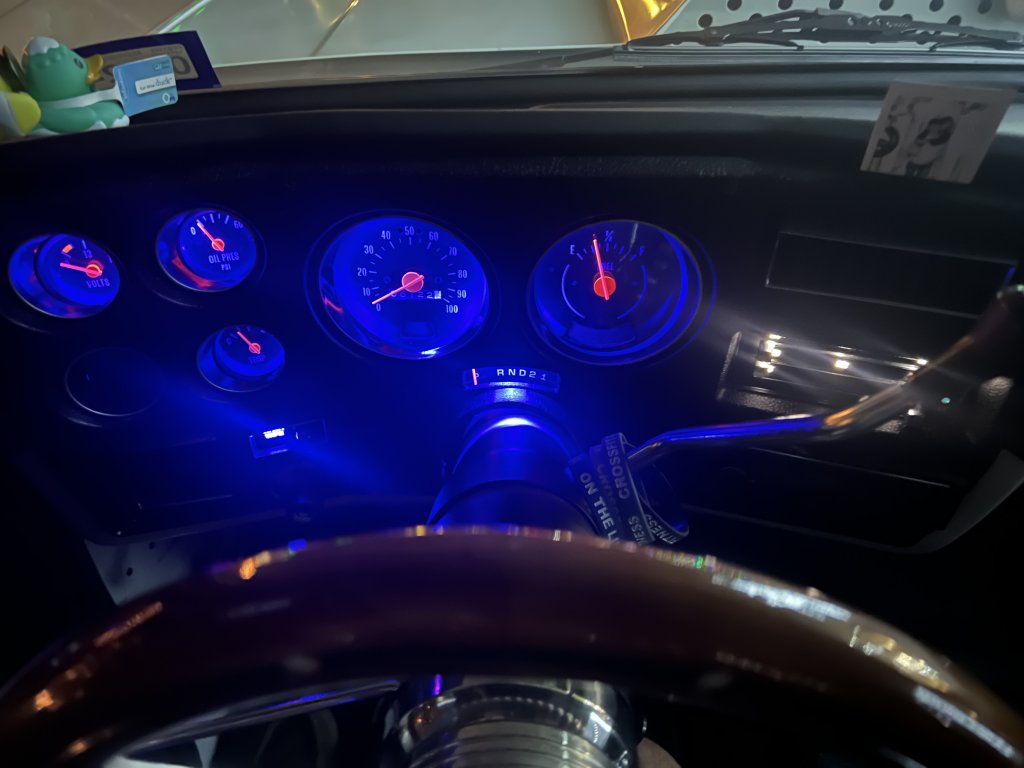

These are dimmable, excellent

Any chance you have a picture at night time on full brightness. I’ve been debating swapping and may order these if they will dim
I will take a pic tonight and post it to you, but they are BRIGHT, I really like they, and they dim well
