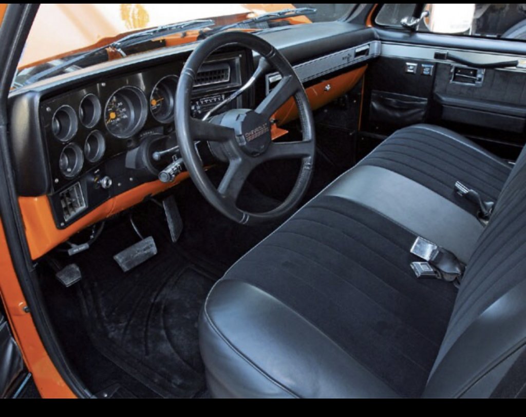

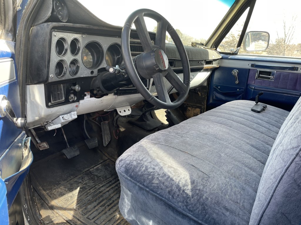

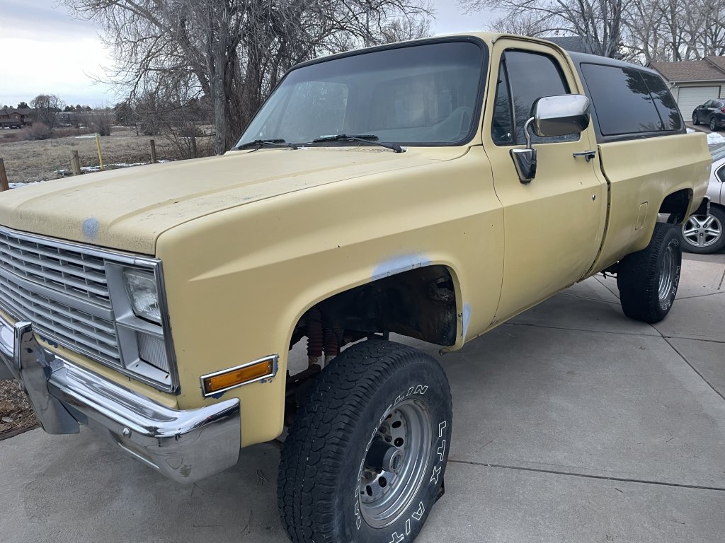

So, I’m planning to start my square restore soon and I’m considering the interior first, then exterior. With so many vendor choices available, it would be valuable to know what and where I can get the most bang for my hard earned bucks $$. Would you please kindly identify vendor, part number and approximate price; and why you may or may not have liked that purchase?
For the interior, Im considering purchasing a new seat cover, carpet or rubber floor mat, tangerine orange paint, headliner and trim, dash top, sun visors, air conditioning parts, etc…
For the exterior, Im considering purchasing paint, sheet metal patch panels, visor, wheel well chrome trim, emblems, rubber parts, etc…
My goal is to turn the canary yellow truck into something similar to the two tone blue/white truck; however, since my truck originally tangerine orange, I’m going with either orange/black or orange/white two tone.

I went to the local junkyard this afternoon to look around, saw prolly half dozen squares, everyone was hammered, pretty much nothing left to pick over. I need an AC cover box which I saw two good ones but my back to sore to climb into the engine cavity to remove. Maybe another day.
