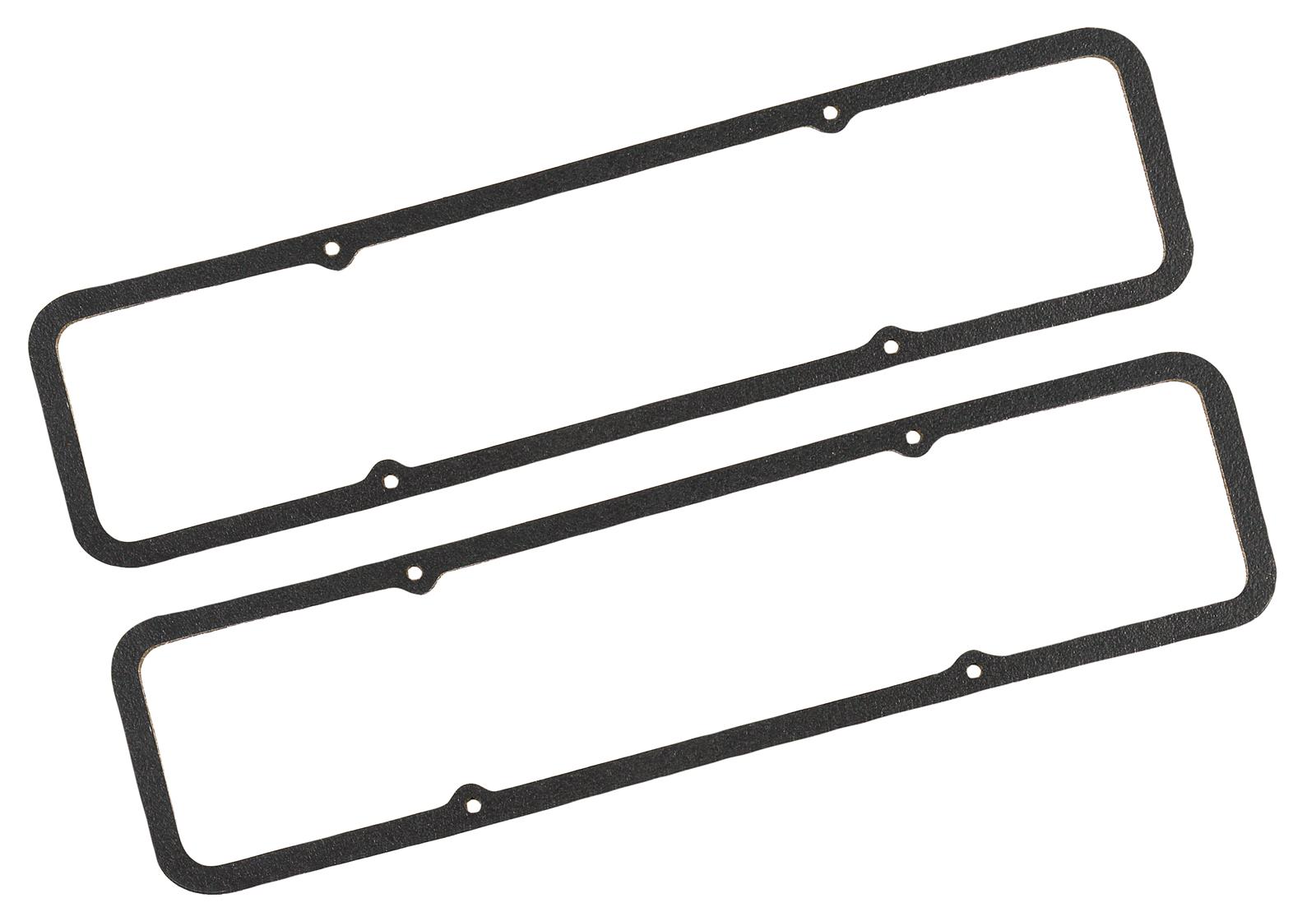

With all that said, my favorite choice for this exact scenario is the Mr Gasket Ultra Seal gaskets. They are a cork/rubber hybrid and work very well. I have never used additional sealant with them, and in doing so, they are indeed reusable just like the description says. Basically if you use them and they still leak... you simply need better quality valve covers.
