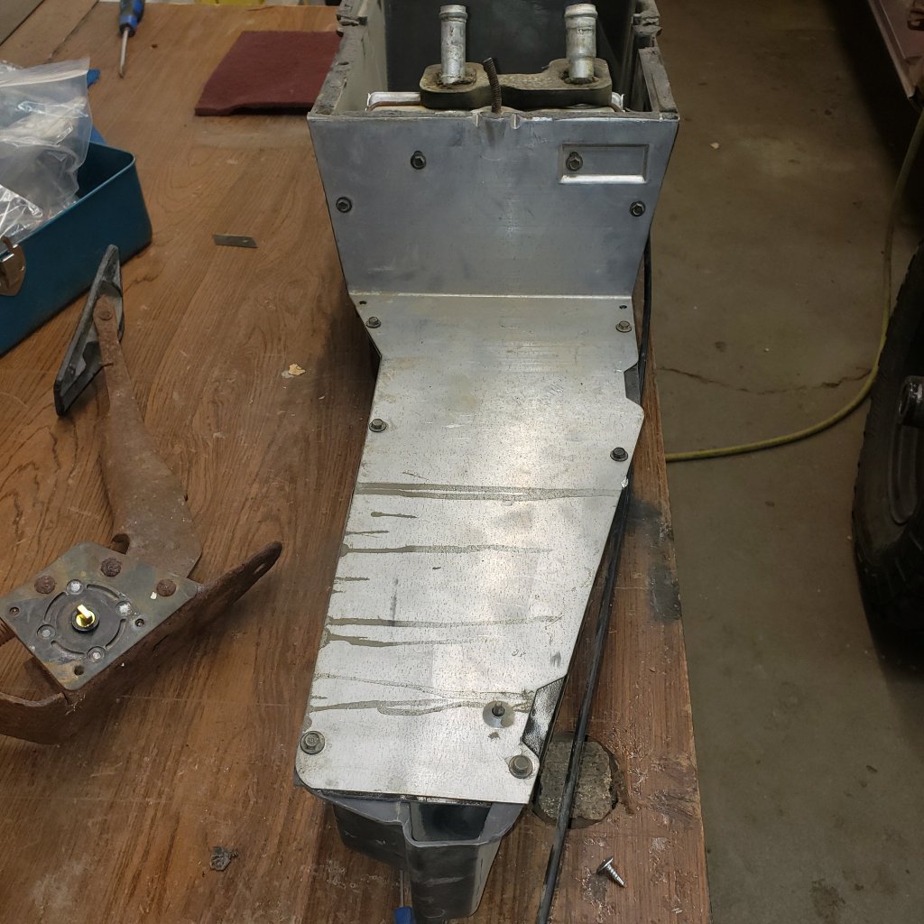

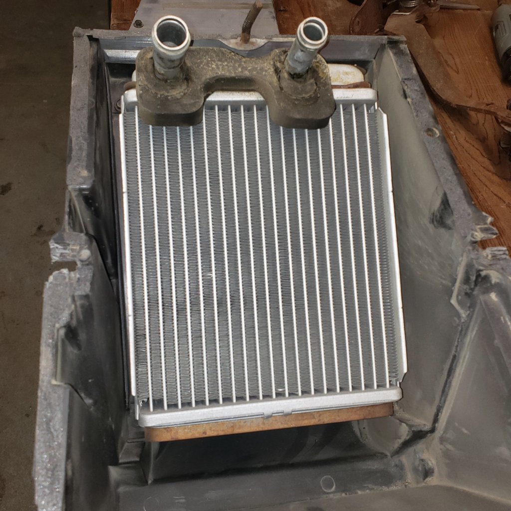

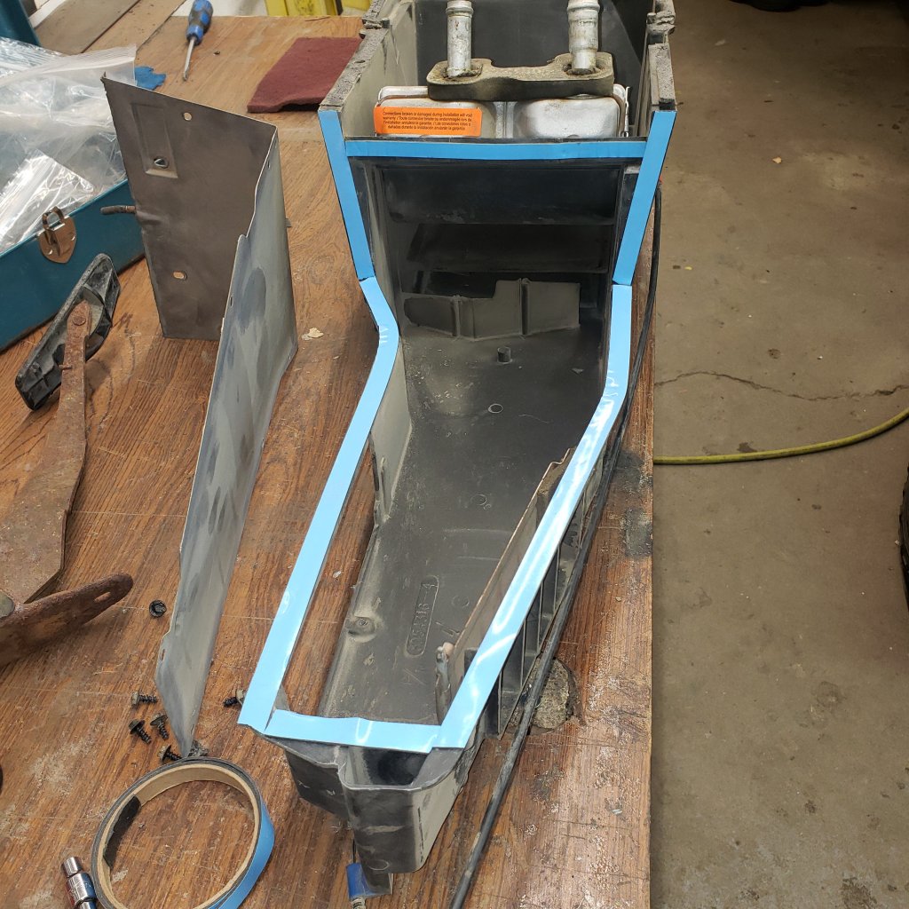

Just working on my heater box tonight before I install it and thought I would post some stuff on what I found and my new heater core.
The metal plate to the left I the second picture let alot of air blow past and was quite wrinkly when screw in. So I added some good two way tape and seamed to seal it up good. This is a non ac box so yours may differ.
