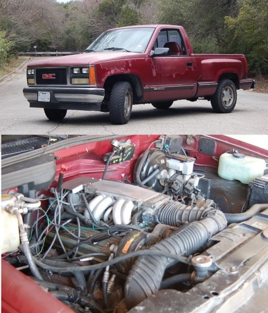

Looks like you got it taken care of. This was my fun truck until my roommate burned out the trans, been looking for another with no luck and the rebuilders around here are butchers.

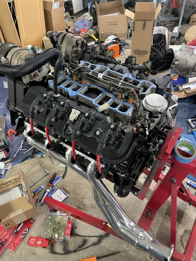

I am using the Bosch D3's in my L29 454. They are WAY nicer than the garbage stock injectors that came on it. I have gone to 30lb TPI ones and they fit very well with the custom machined tip extensions that they put on these ones. I bought a full set from South Bay injectors. They were crazy fast on the shipping and look to be in great shape.

Yes, I have the 30lb reman ones. The stock L29 injectors are 19lb and they top out pretty quick with any kind of extra power output.
