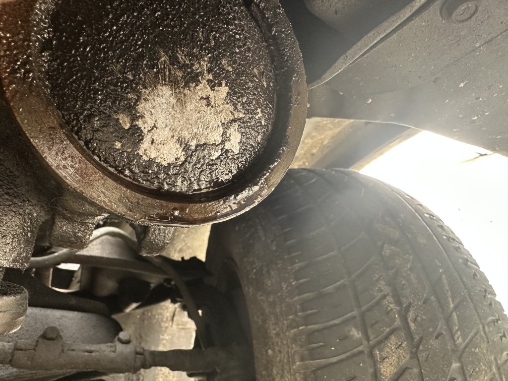

2. Was going to drive around the block in the neighborhood (that’s once in a blue moon, January I had no problems) but yesterday it didn’t go in reverse so just rolled out in the street and drive only went in second I guess but not third (automatic). And stalled at stop after 5 minutes driving. Had to be pulled back to the house. Today reverse still not switching in gear, neutral it will go forward along with the other drives. Got it jumped off left in on few minutes stalled again and really started rolling back. Also noticed that the end of the gear box was leaking steering fluid.

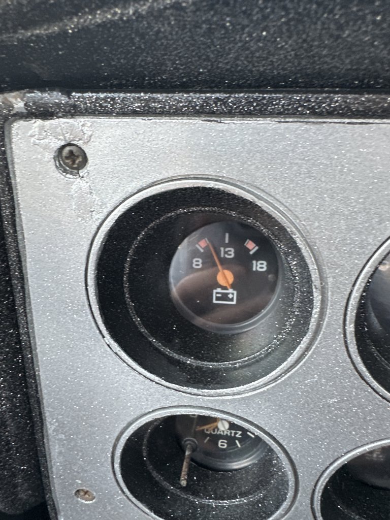

But it’s of course locked in the others, park and neutral still a no go , battery amps are around 12 on the gauge and goes down a little when trying to crank pics below, haven’t check battery with a multi meter yet

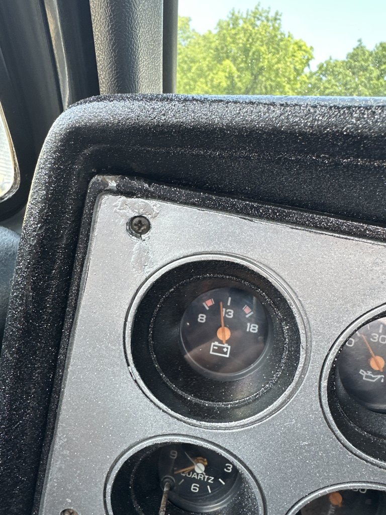

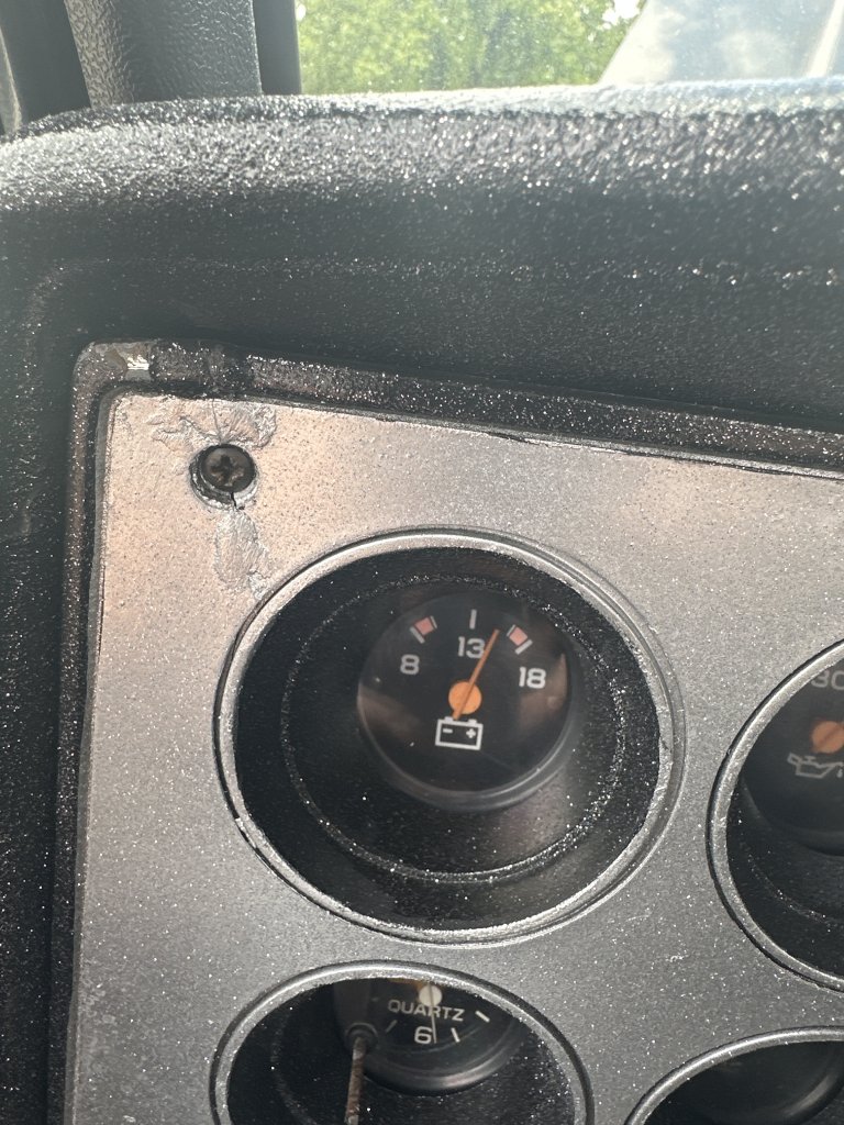

She cranked up and gauge is this

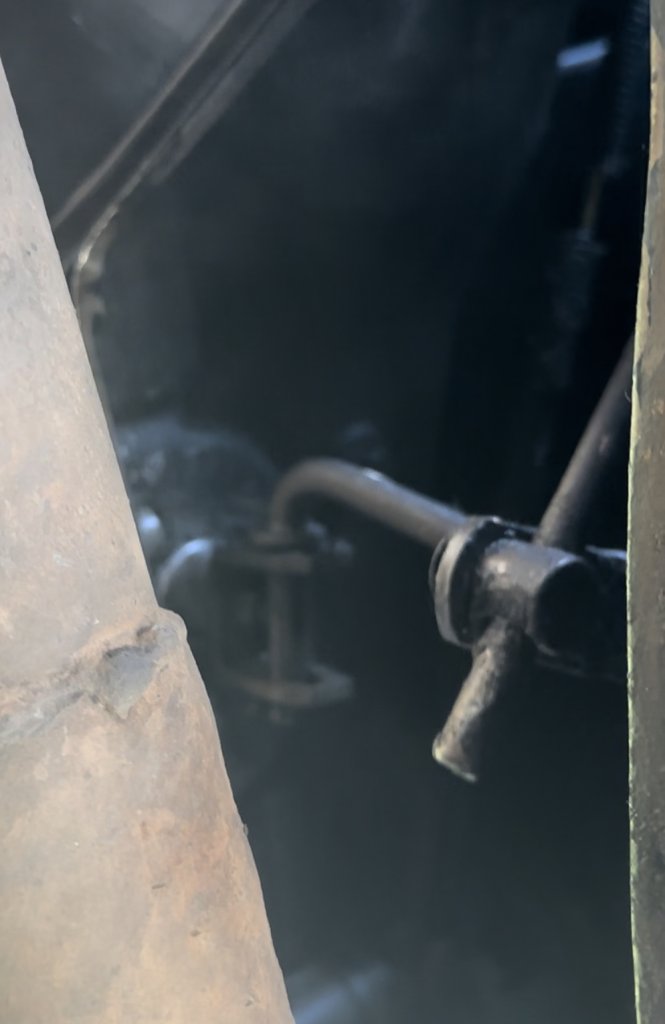

Po put nice new battery cables, wires are correct on the starter. It starts up like it should now, just wondering about it not shifting, this really was all the sudden, a couple months ago. I drove it around the block in January no problem, no stalling, no up or down shift problems. Then in April got it cranked (took a bit cause that’s before the stuff I just did just now in may), would go in reverse, no neutral unless the engines off and it will roll other than that it will go forward. Same today when I cranked up. That safety switch should be fine, if I’m not mistaken to test, I can only start her up in park and neutral, key won’t move if it’s in other gears. The linkage moves when going thru gears, I wish I could upload video, what other pics would you need
