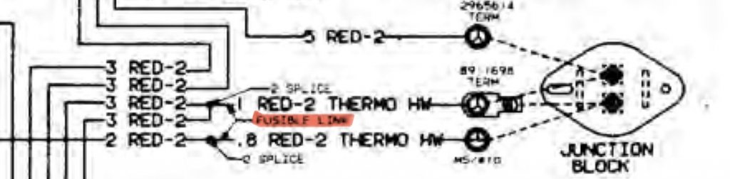

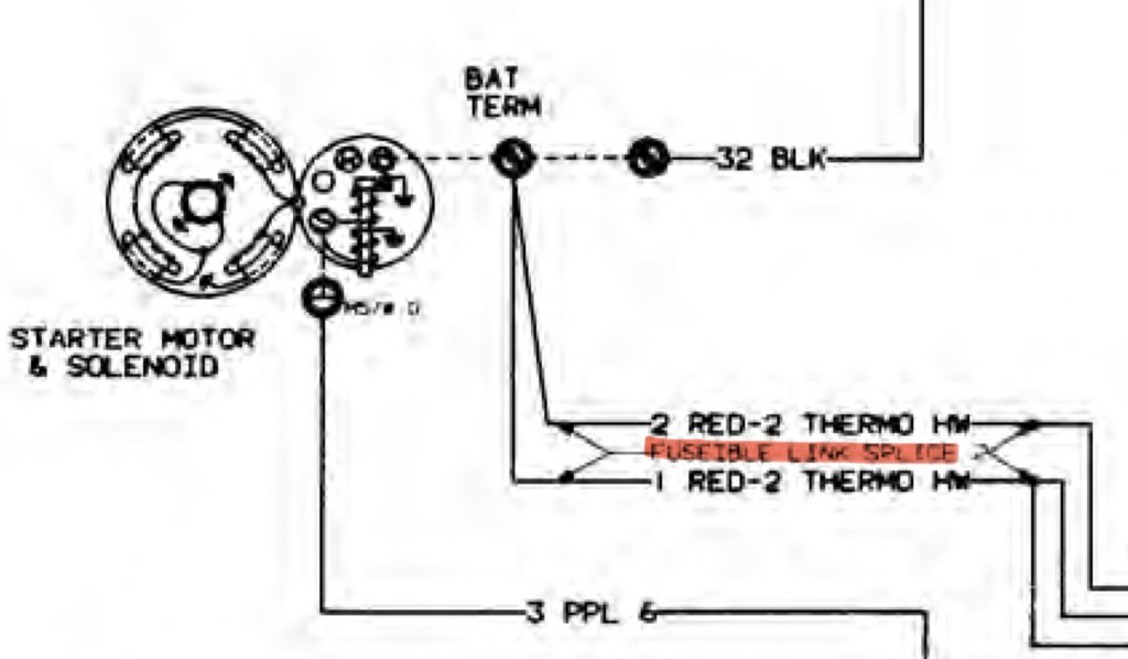

You need to get a wiring diagram from the reference section of this forum. It’s on the home page. It will tell you where the fusible links are. I took a snapshot of parts of it and posted below, but you really should have the whole diagram if you’re chasing down wires. The fusible links are on the primary power wires coming off the starter post and on the junction block on the firewall. If battery powered things like dome light and headlights work, but ignition switch things don’t I would be more inclined to think the problem is on the firewall wiring. You can look for signs of burned wires, but get a circuit tester if you don’t already have one and check to see if there is power on those wires feeding the ignition switch.
