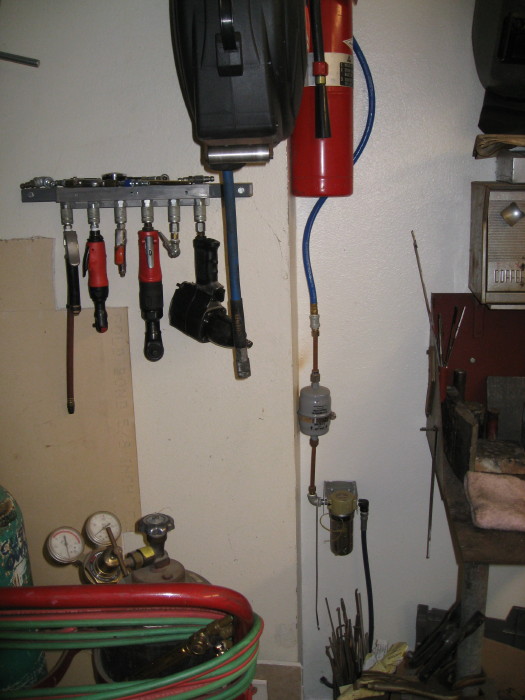

My impact gun and 3/8" ratchet are Huskys, and after reading good things about the HF air tools I got their 1/4" drive air ratchet. All work well.

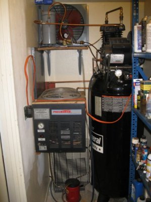

I also have the HF 60 gallon two-stage compressor. It keeps up with my air tools and blasting cabinet without any problems. I tried a smaller Campbell Hausfeld single-stage compressor and it wasn't nearly good enough for an impact gun. The larger HF compressors are made in South Carolina in the same factory that makes Bel Aire compressors. The only issue is they use a high rpm motor/pump assy to get the rated cfm so they make more noise than low speed compressors. I have mine in a separate storage area off the garage so the noise isn't a bother for me. I also cut down the noise by inserting rubber pads under the pump portion of the unit and removed the pulley guard which rattled like mad.
You mentioned painting. Moisture is a big problem in compressed air, compressing it is just like wringing out a sponge and guys go to great lengths to get dry air for their tools and spray guns. I'm running some of the air from the first stage pump through an air-to-air cooler before it goes into the second stage. The second stage air goes through a refrigerated cooler (cooling the air drops out the moisture) then on the other side of the wall it goes through a moisture trap and finally a coalescing filter before ending up in the hose reel. I installed automatic drain valves on the compressor tank and both coolers so every time the compressor shuts off it spits out any moisture. Bit of a job to put it all together, I kept adding things until it was right.
