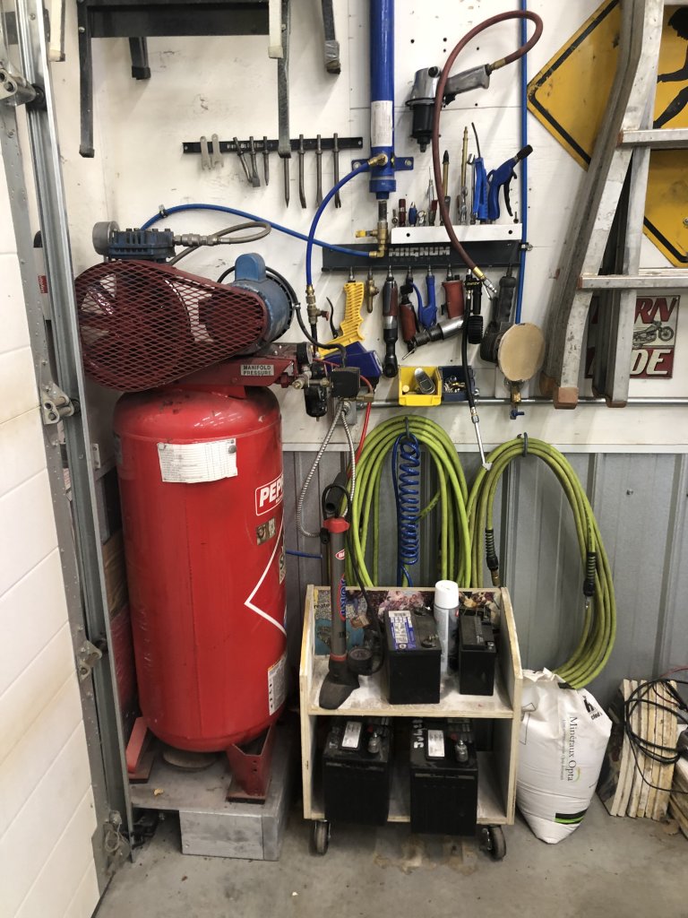

And unlike steel or copper pipe, I've seen no condensation in PEX. The compressor has an automatic bleeder on it and a copper precipitation coil (looks like a moonshine still) to remove condensation right after the tank.
Just a note, the condensation doesn't necessarily go anywhere, so if it doesn't sweat out in the lines, it is making it to the end use point/tool. But having your setup right after the compressor should get the bulk of it out, and anything critical needs a dedicated dryer anyway. Just mentioning here in case anyone gets the impression that running pex eliminates the need for dumping moisture, it doesn't. If anything, it makes it more important to get the moisture out before it gets to the lines.
Good point. Thanks.
