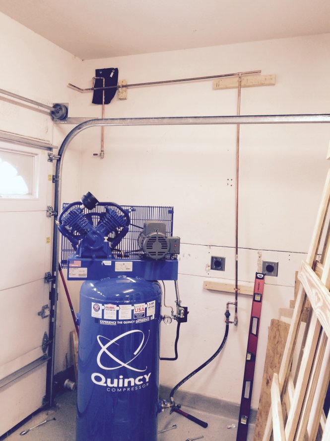

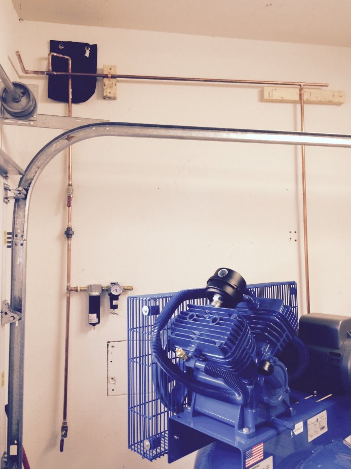

These were "in progress" pictures of the install, but you get the idea. I used a hydraulic hose to connect the compressor to the copper piping with a union (temporary steel union in this picture, I changed it out for brass).
The little "hump" at the drop to the regulator is another step to help keep water out of the line. I've never had water out of the ball valve on the drop or out of the regulator, even with that short of a run. Both ends of the main run are stubbed and capped for future expansion. The main line also has some amount of slope to help water drain to one end (though it just collects in the capped line at the moment, the way it's set up).
