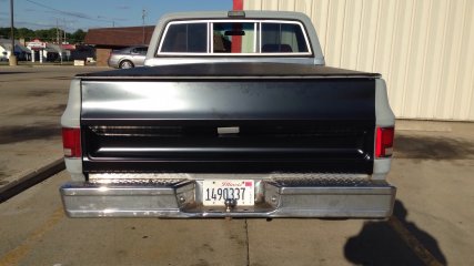

Yeah I got a new tailgate that I'm gonna have to work on, passenger side sits almost flush with bedside and drivers side sits too far away from the bedside but the body lines are super close!

Yeah, that's pretty typical for a reproduction body panel. But that's the nature of the beast unless you want to pay out the nose for NOS or you get very lucky and find used OEM pieces in great shape.

I may just take a grinder to the passenger edge and take about a 1/8 to 1/4 inch off and have to grind the lower hinge portion on drivers side to get it to scoot left a little! I noticed the tailgate stops on that little cup and won't let it slide over more. If that makes sense!
