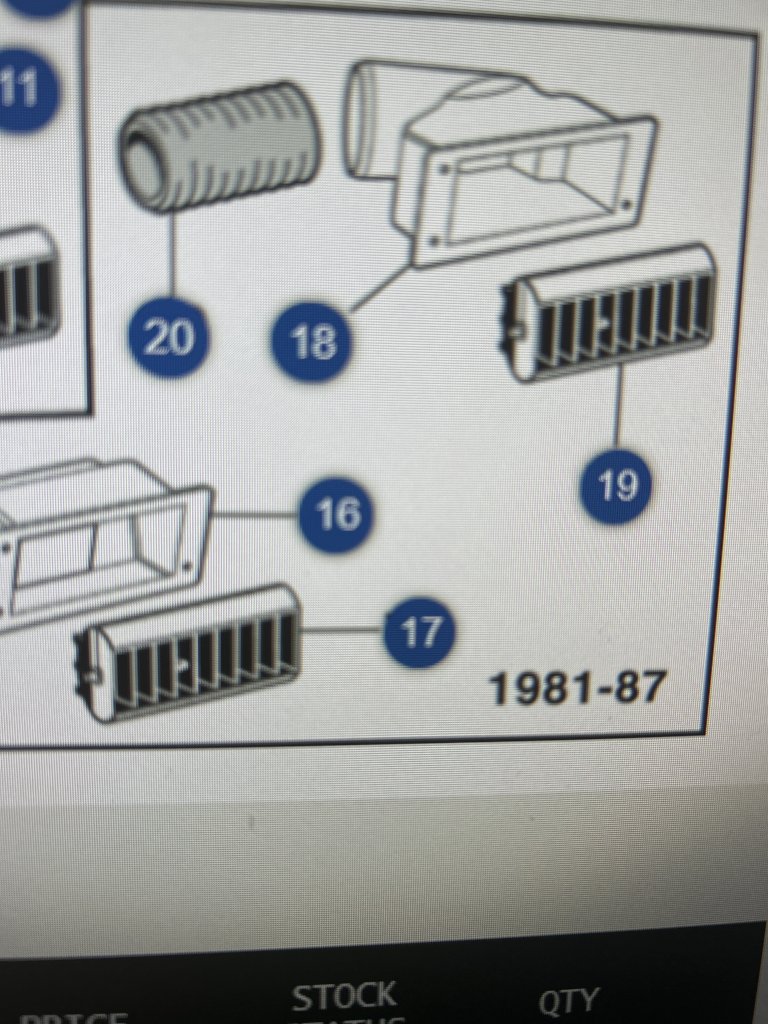

Any know the diameter of the duct (behind glove box) that goes to the passenger side vent? #20 in photo. Mine is completely gone. Back order on LMC. New to forum. Got truck end last summer.
My truck is a 77. I just measured the duct at 3.5". Found it at Classic Industries, they are calling it 3.25" ID so looks like that's the one. Part# for 77 and 87 at LMC is the same. Classic sells 6' roll for $65, think I'll wait and let the A/C on that side blow out from under the dash till LMC has it back in stock for $20.1981 C10
