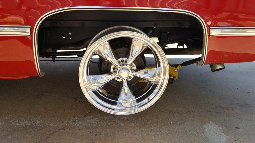

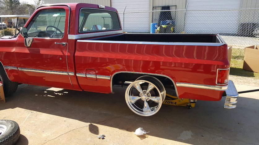

Ok I am running a set of 20x10 torque thrust 2, photos attached.. didn't know if someone has about same set up just trying to figure out some tire size options got a tire shop allowing me to mount 4 tires to see what fits best truck has been lowered with Springs and spindles thanks for any help

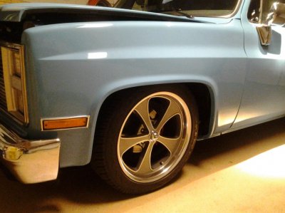

1500 r10 pavement scraper
Fronts...255/45r20
backs...305/40r20
I have riddler wheels....
I tried a variety of tire sizes before installing these. Just be sure that the tires you select are weight rated for the truck. A lot of people put the wrong rating of tires on trucks and they end up wearing out fast. These are what I have on my 87 square...with a 5 front...7 rear drop and it handles fantastic, but I am still able to break loose the rear and smoke em up almost too easily.
