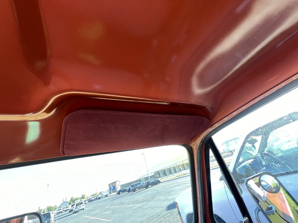

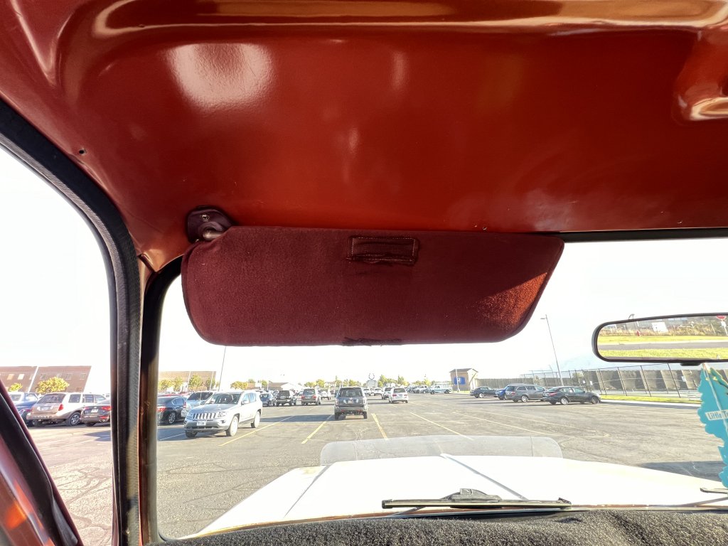

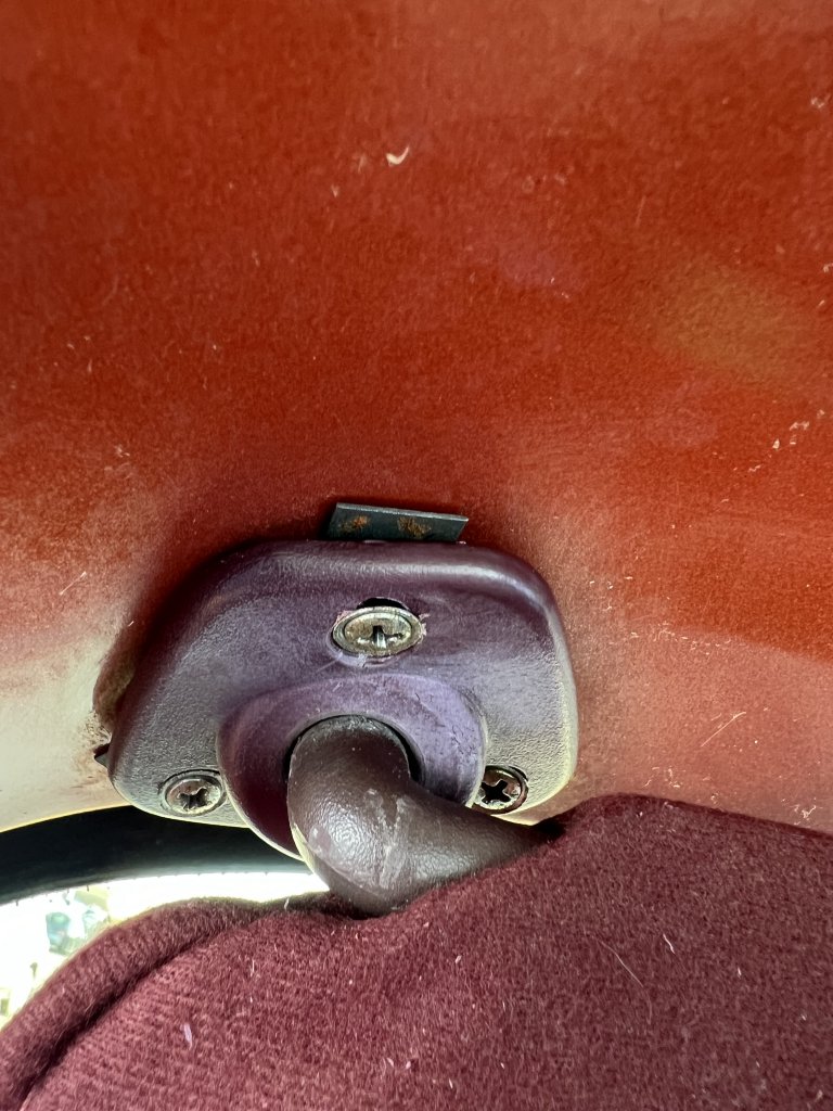

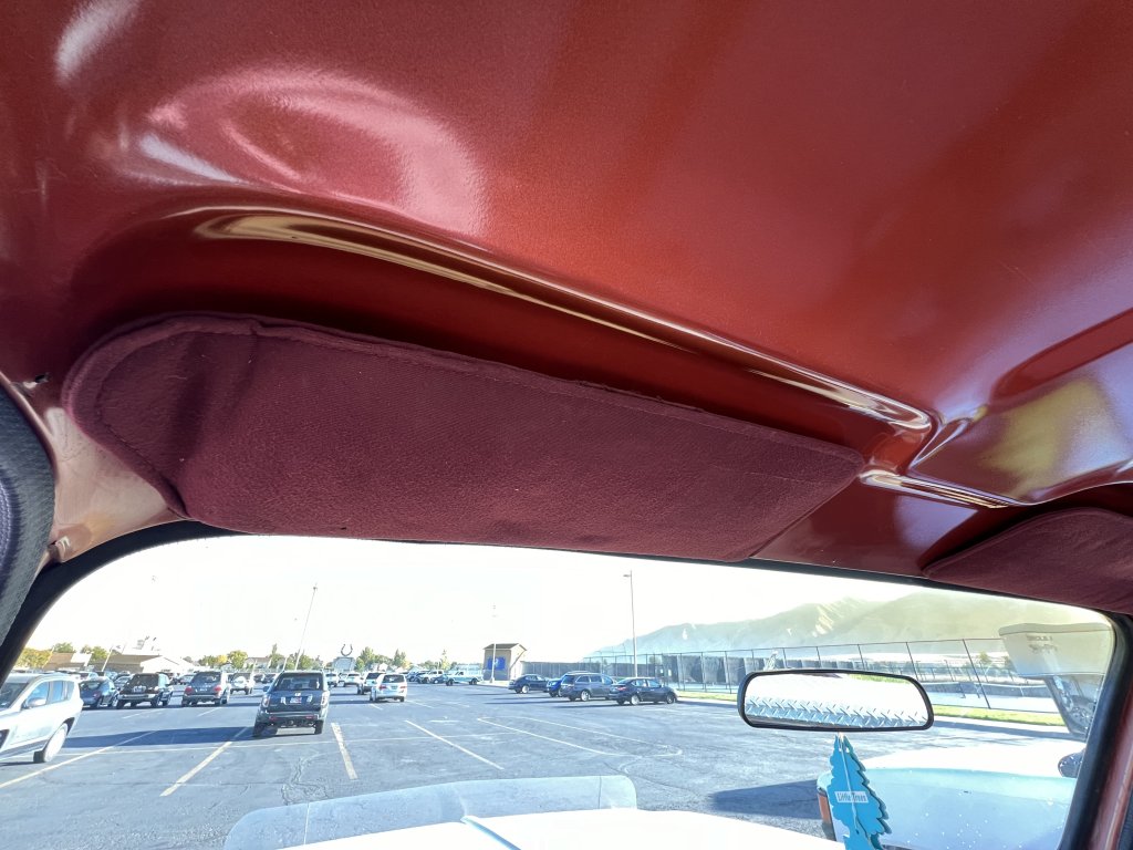

Hey yall I figured I’d post this here since I haven’t seen many people talking about it, but the 90s visors fit in pretty good. The bolt pattern has to be drilled barely wider, but they’re a good fit. Mine are a little snug against the ceiling, you can fix that by either putting spacers between the visor and the roof or bending the plastic arm. And before yall say “oh its not oem, its not original”, its better than the cracking leather ones
