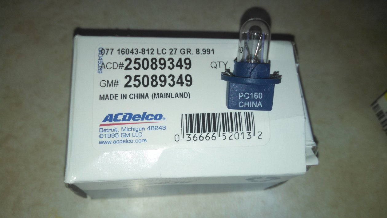

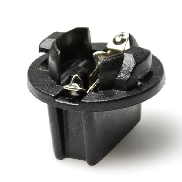

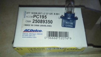

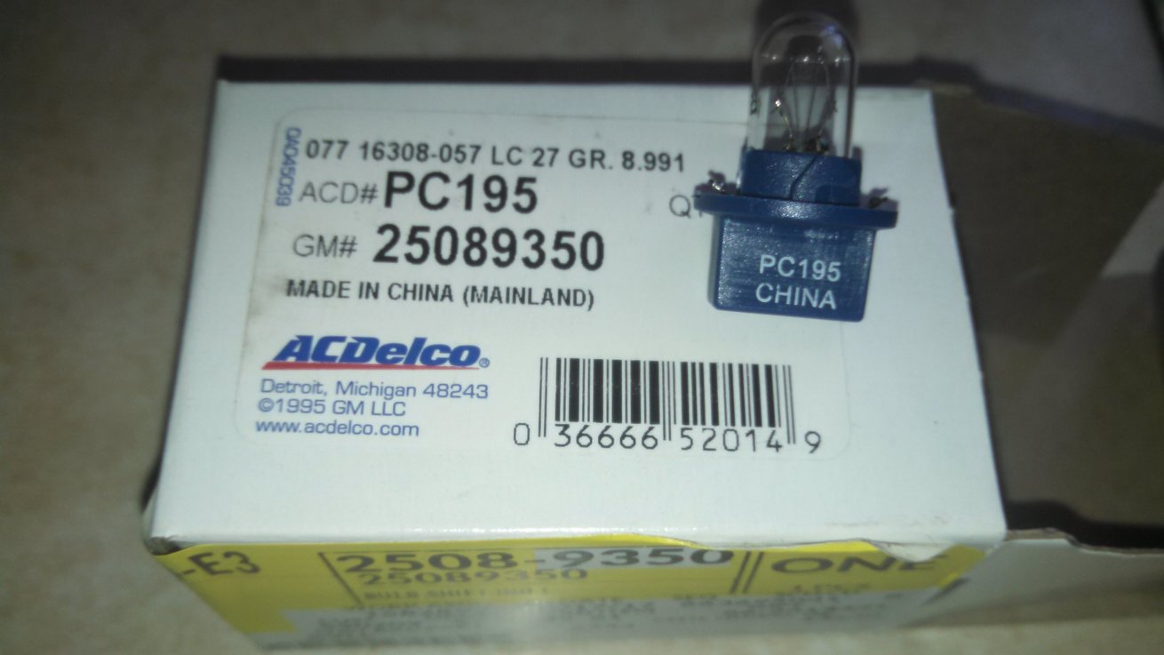

I received the order of 2 lamp/socket combos from GM, which they indicate go into the 91 suburban cluster
here are pics of them and their part number. BTW, they are expensive
part 25089349 is $7.16
part 25089350 is $9.79
shipping was $10.35
ordered from GMPartsGiant.com
I prefer the socket from supperbrightleds.com for $1.10 or so each:
cheaper
lamp is separate from the socket

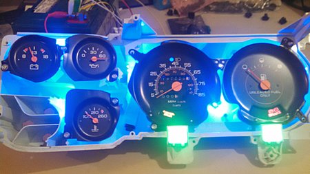

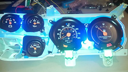

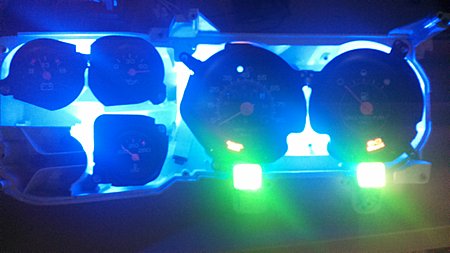

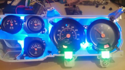

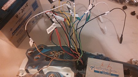

Built a test harness for the suburban cluster tonight.
I used test leads with alligator clips on them. Cut them in half and soldered to the wire leads of the extra male Instrument Panel plug I bought. see last pic
I tested everything except for the speedometer (since I don't have a sine wave/pulse generator) VSS input.
Grounded oil, fuel and water leads. Oil and fuel moved to 0, while water pegged max, all expected
LEFT and RIGHT turns turned on.
HI BEAM also lit up
I added blue LEDs to the lights and they work. I had one light which did not work with one brand of socket and I looked and saw a missing copper segment. I found another socket and did work (one I bought from GM)
I got the BRAKE to light up, by grounding the lead. Same with the CEL (Service Engine Soon) light. 4x4 and SEAT BELT lights lit up by touching 12volts.
The only lead that did not work was the ALT wire. Then I pondered things and I think it goes to a light source in the lower left gauge position. I will test out the circuit board and follow the trace for that wire.
So I tested the suburban cluster and it works. Tested very well on the table top and saved me from trying the test in the vehicle

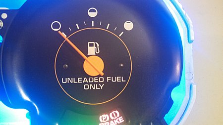

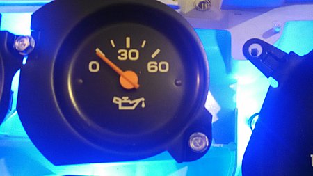

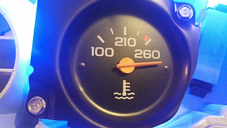

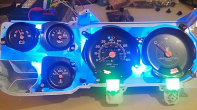

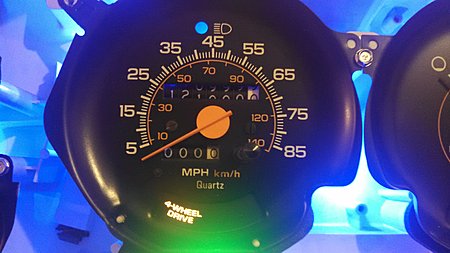

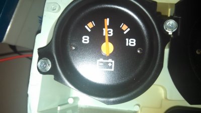

gauge pictures all powered up - except for the speedo
Completed task #7 from the TODO list: DONE Cluster tested
Need to install the Tach now

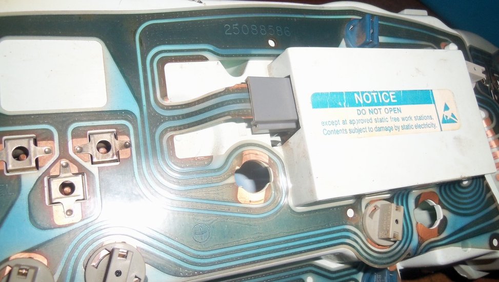

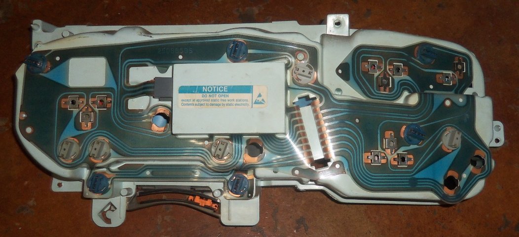

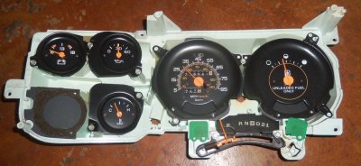

I don't want to completely hi jack your thread here Doug, but this is on topic here too so we'll just consider it an addition to your thread.
This is my Instrument Cluster from a 91 Burb C10 Silverado OEM TBI 350 and 700r4.
It all seems in good shape though I've not tested it like you have yours. I see no reason it won't work since I was driving this truck that just had a blown head gasket and all the gauges seemed to work fine with what little I drove it, and it sure let me know when it overheated.
This one has a Red Battery light where the clock would go. Not sure if it's a working light or not but it does have a bulb socket behind the red battery overlay. :shrug:
The only issue I have with this one, is the trip odometer doesn't seem to want to reset. If I push the knob hard, I can get it to change the 10ths but it won't grab the other 3 so I can reset it to OOO.0.
I was going to take the speedo out and see if the Trip Odo can be worked on or replaced separately. I can't see to figure out how to get that damn plug on the back side out. I don't want to force it and break something. So do you know what the big trick is to get that plug to release?
I did release that plug on mine, but don't remember how at this point. I will take a look as the cluster is only part way install
dougbert
47,128
9,299
That would be great if you can recall how to do it. I just don't want to hurt it. If I can fix the trip then I'll put it on eBay for sale as a working unit. If not, I'll sell it here here cheap for parts. I'd like to hold onto this for way in the future ideas, but needing cash so it's gotta go pretty quick.
