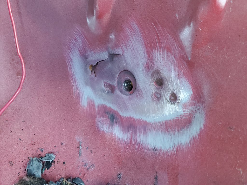

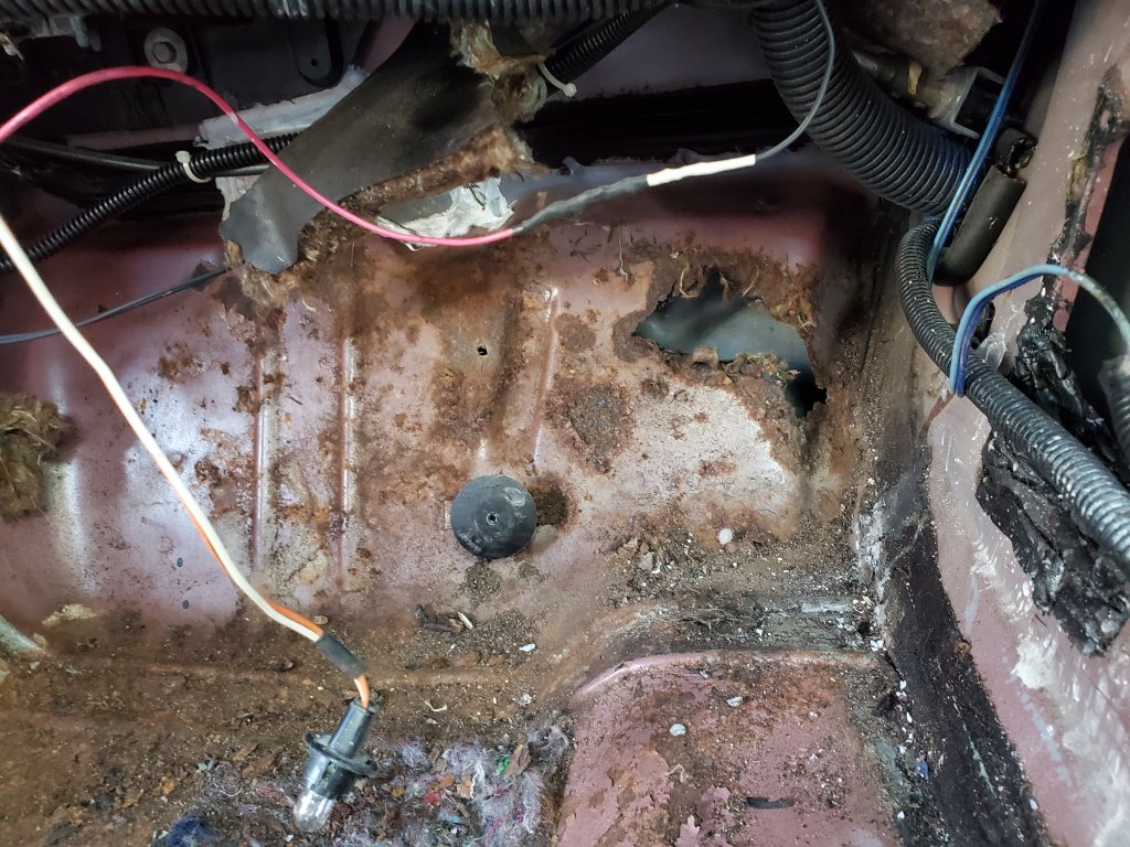

Passenger side is so much worse. And then there is a random body tear around passenger rear seat belt mount.

That body tear is interesting. Pressure buckles in other areas of the floor are not unheard of, but I don't remember seeing that before.
IMHO, the floor looks real good compared to what I often see.

Body tear is because of exhaust hanger hanging there. Even more things coming apart, but radio works.

Welded and sealed where back side is accessible. Where not accessible, panel bond.

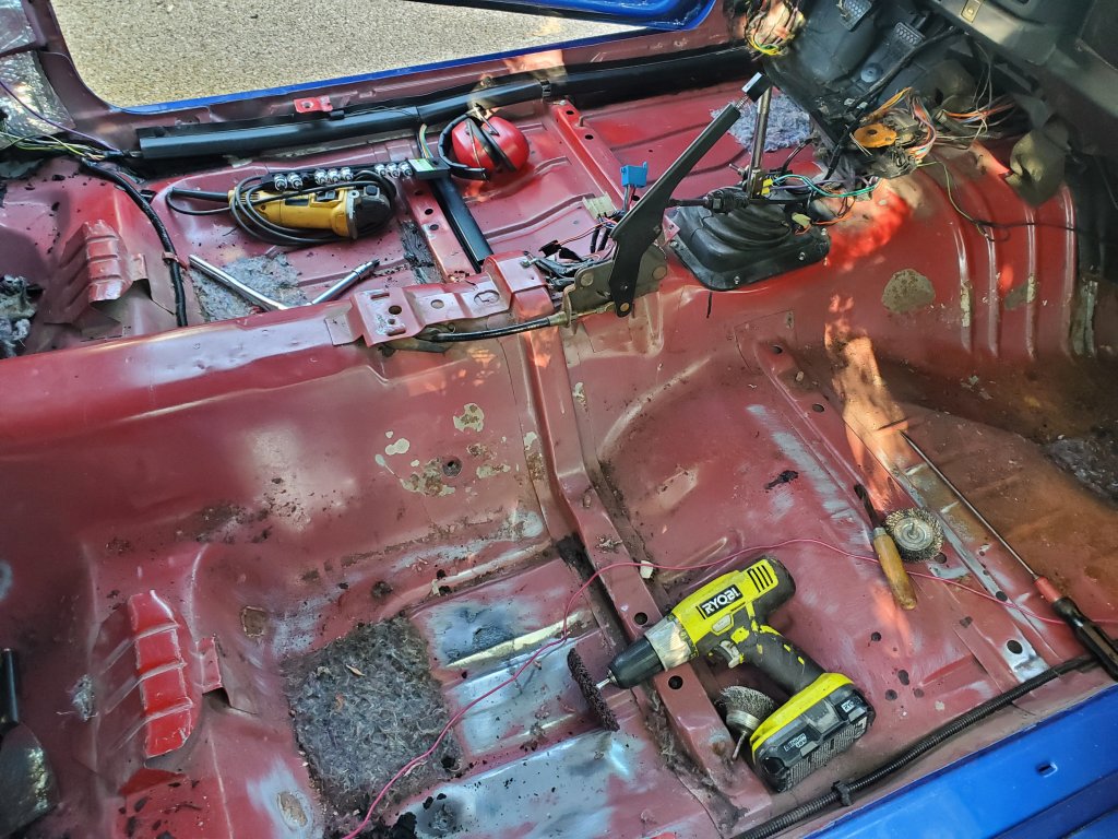

Getting things actually put back together. Removed newer repro shifter boot and installed older oem from a 3000gt parts car.

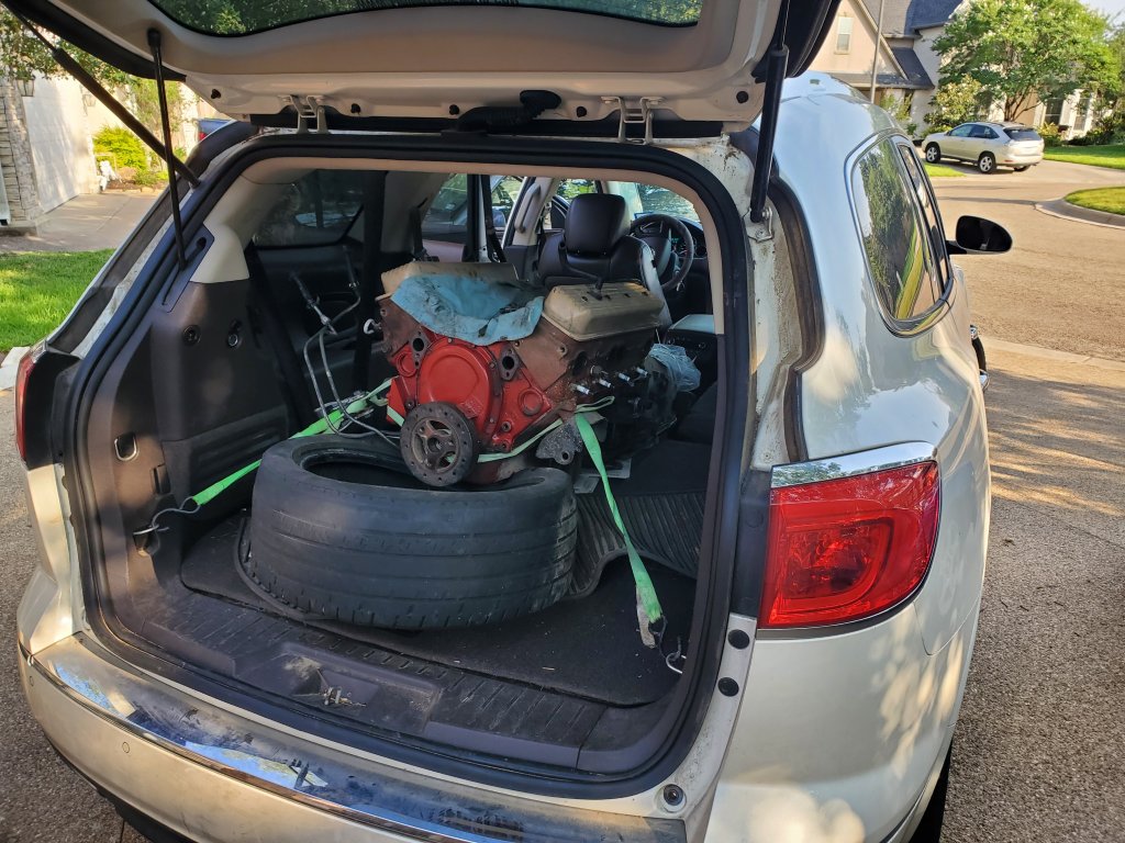

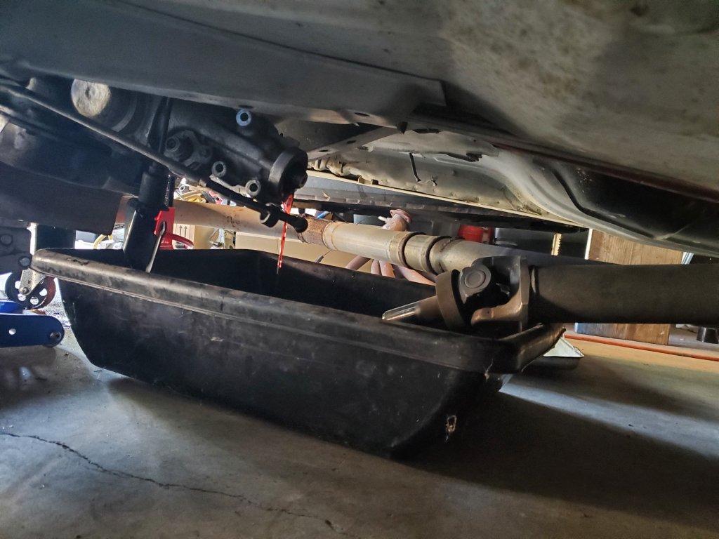

Update on 87 camaro. Stuffed motor/trans in the back of an enclave. Will be going in 84 or 85 el camino. I went with lazy method on trans/driveshaft. Left driveshaft in place and transmission full of fluid. Then placing the pan under trans pulled it up with hoist. Drive shaft removed and trans partially drained all in one.
