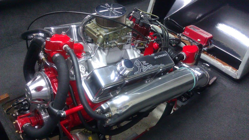

I didn't think I was asking for a lot. A truck in the '84-'88 model year range. I wanted something pretty much stock because I wanted to do mods to it that I always wanted but never got around to. I didn't need a 4x4 any longer but it had to be a 350 and preferably with a darb. Why a 350? Because I've had this boat that was even a bigger part of our family than D SUB was if that's even possible. In fact, they were kinda one in the same. Wherever the boat went, D SUB was pulling it. It's a grey on grey '86 American Skier Tournament barefoot boat that I've completely redone, including a 383 stroker that I designed and built. It runs pretty strong. And why the carb? Because carbs are cool and if you know what you're doing a carb can outperform EFI. I'm really old school and all the new tech crap on vehicles makes people lazy, piss poor drivers. Sorry, purely IMHO which doesn't mean spit at most places so flame away if you want.

I figure on rebuilding the carb. Problem is that I know Holleys really well. Don't know squat about QJ's but willing to give it a honest chance to see what it'll do. I bought the Cliff Ruggles Rochester book and started reading and now I'm on the fence. I still think I'll rebuild it just to get it running like it should be but I'm thinking I want a Holley. My question is do you stick with a spreadbore or go with a squarebore and an adapter? Any and all opinions appreciated. I also have a 2601 Edelbrock intake left over from my boat when I built the 383 that would bolt right on. It's the Air Gap version of the standard 2101 Performer. That's a no brainer. By the way, I have a pristine forged crank from my boat motor that I could also use to build a really stout 350 or 355 if I decide to not go for a 383.
