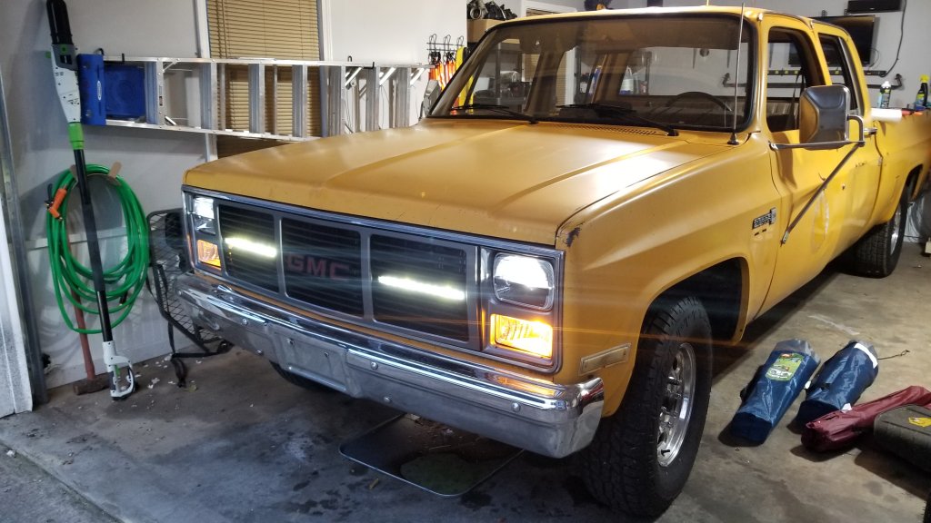

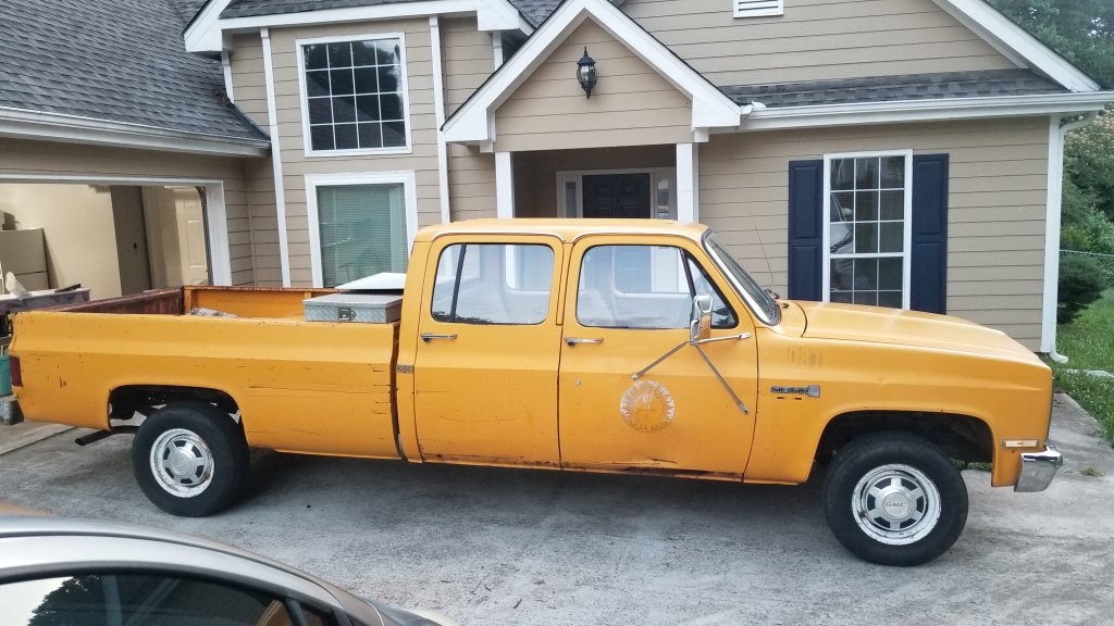

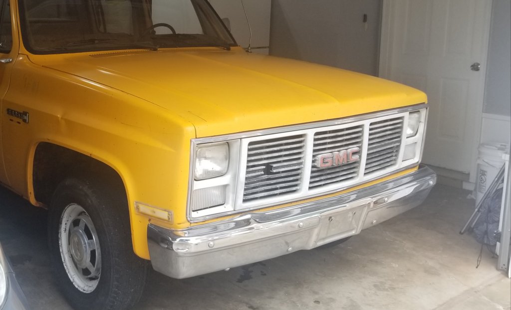

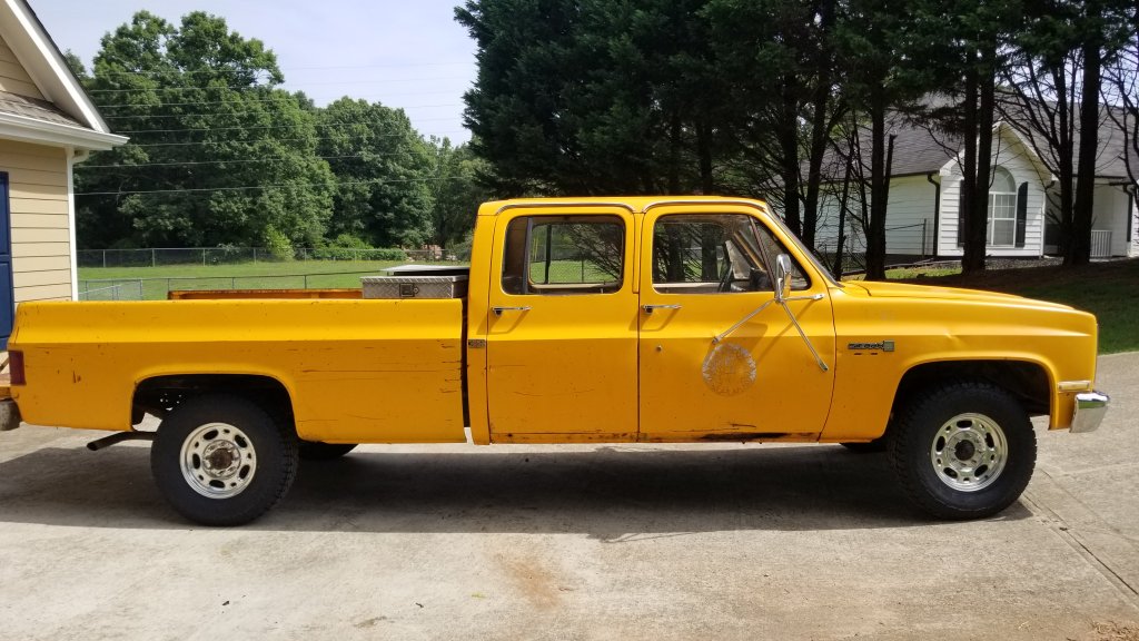

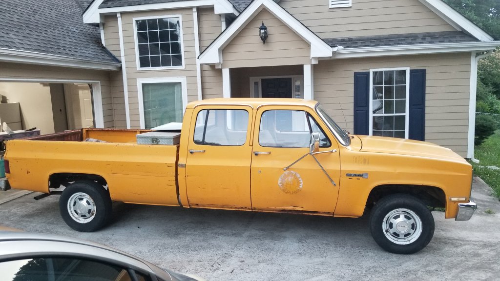

Hello! I'm 28. Growing up, I've always liked the square body crew cabs and was finally in a position to obtain one approximately a year ago. Always have been a GM guy, bought a camper, ended up buying a 2018 ram 2500 cummins. Took a job across the country in Georgia. Sold the camper and ram. Once I was established and able to start rebuilding my life out here in Georgia, I began my search for a crew cab. My intention going into this was to build a truck how I want it, make it a swiss army knife. I stumbled across one about a 4 hour drive away. The guy said the tires leaked air that needed to be filled up daily. My buddy and I hopped in the car to see it. The frame had no rust, however the rocker panels, some of the floor, and a cab corner is rusted, no biggie. Drove it back home in the rain at night, with a missing drivers window. Truck is a SBC 350 with a th400. Engine does not leak oil, however the trans does leak a little tranny fluid.
First thing was first. Get new tires.
The truck was running too rich and the electric choke did not work. Some of the vacuum hoses were routed to the wrong areas. Once the vacuum lines were sorted out, I tuned the carb and fixed the choke.

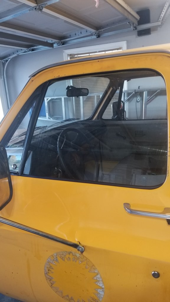

Once it got running right, I put in a new drivers side window, painted the upper half of the drivers door (getting new front doors eventually), rebuild the drivers side vent window, and installed new weatherstripping.

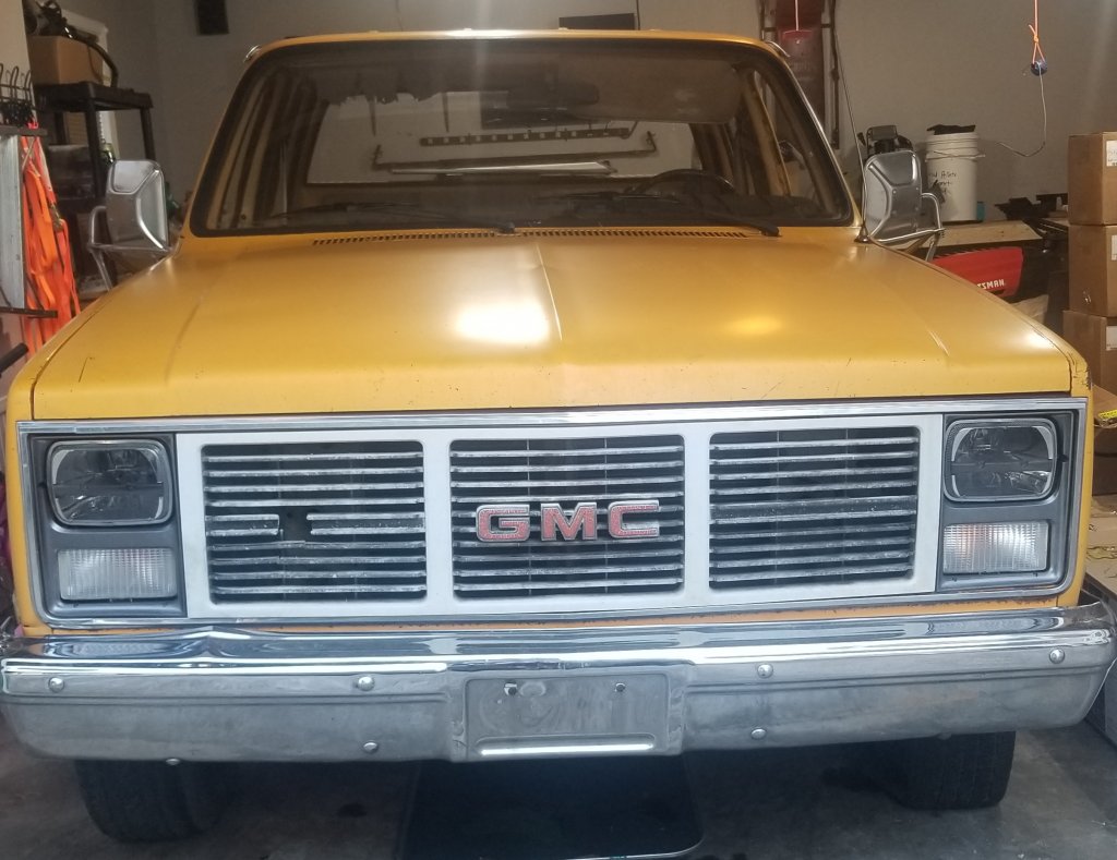

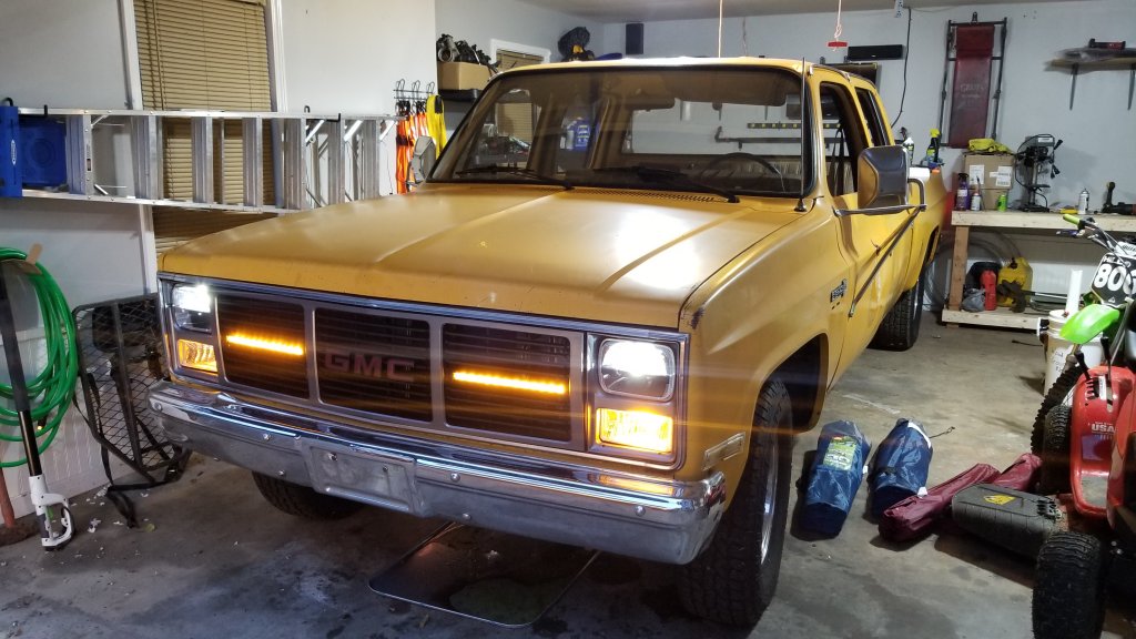

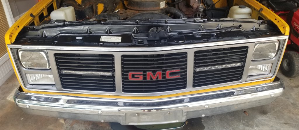

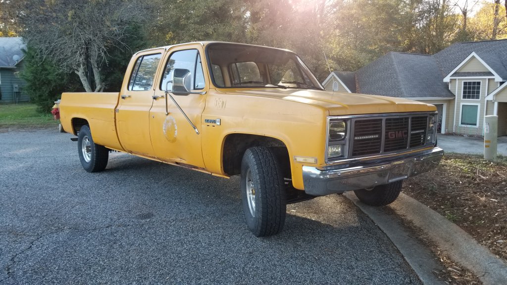

The old grille was cracked and faded. Some of the pieces were missing from the cross bars. I put it all back together with epoxy. Since I could not find some parts, I found some light bars that fit perfectly in its place. I repainted the grille and installed it. One headlight was out, so I purchased led headlights and new turn signal housing with LEDs. Installed an electronic flasher.

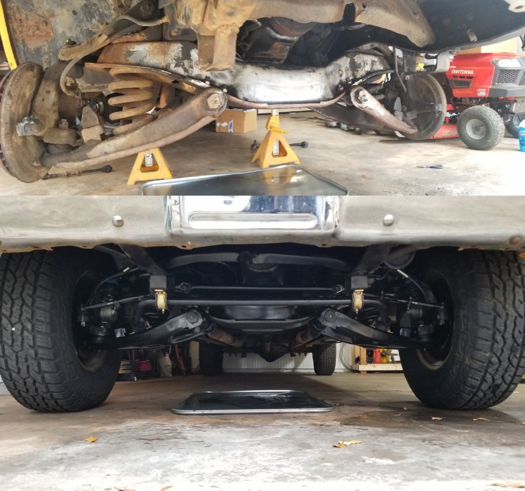

I decided to completely rebuild the entire front suspension,steering, and braking system.

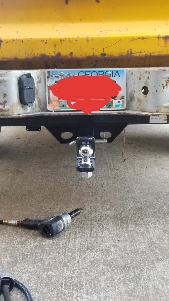

I installed a class V rear bumper hitch and wired in a 4 pin and a 7 pin connector.
I installed a second fuse block that runs on switched 12v

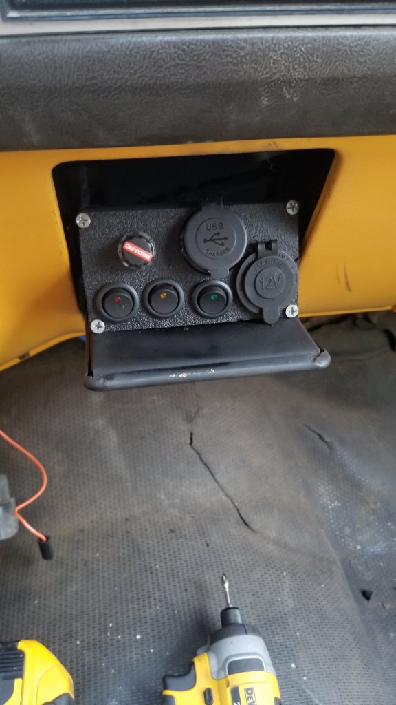

I turned the center ash tray into a switch panel that consists of a remote brake controller, 3 auxillary switches. A usb charger, and a 12v plug.

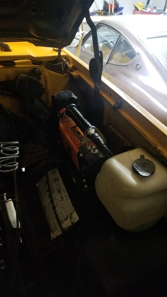

I am currently installing an on board air system, with a 6.35 cfm air compressor and a 9 gallon air tank.
My power steering pump is leaky and needs to be replaced, which the new one is sitting on the workbench.
The future plans are, loadlift air bags, b&w turnover ball gooseneck hitch. 40 gallon suburban tank, cummins swap, 4wd swap, interior sound deadening, new interior, rust repair, AC install.

I'm not sure if you know this... but either someone sold you only half headlights or companies are really cutting back on costs...
