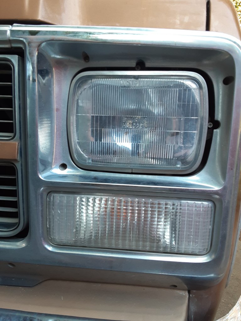

I have a 80 K10, I took the front trim off when I painted the truck. I cannot figure out how to install the clear rectangular lights under the head light. I have new lenses and existing OG metal housings.
Unfortunately I did not photograph the break down process. I assume the metal valence needs to be installed first before dealing with the bezels ?
If someone could walk through the install process , it would be appreciated,

Round eye, or squircle?
If the latter, see the below.
5 torx screws hold the trim on and I did not pay attention to how the turn signal mounted, but it goes in before the bezel.
3cup top, 2 in the bottom- not sure if they show in the pic.
The valence would need to be installed before the bezel.
