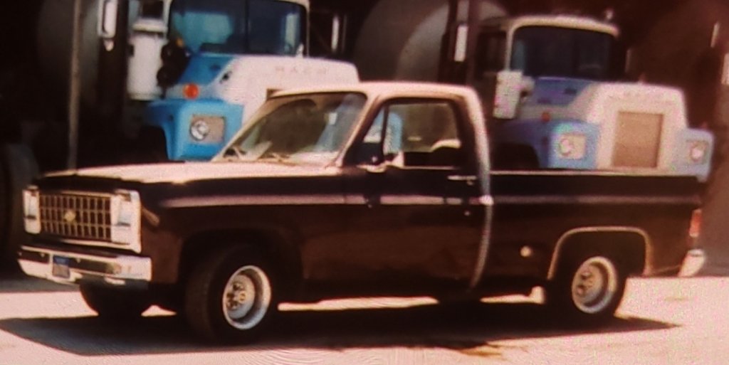

The rect headlight bucket is spot welded on from the factory but the mounting plane is the same. I converted a 74 to 80 back when, just used the chrome headlight door to locate, definitely no core support replacement necessary, just swap the bucket
