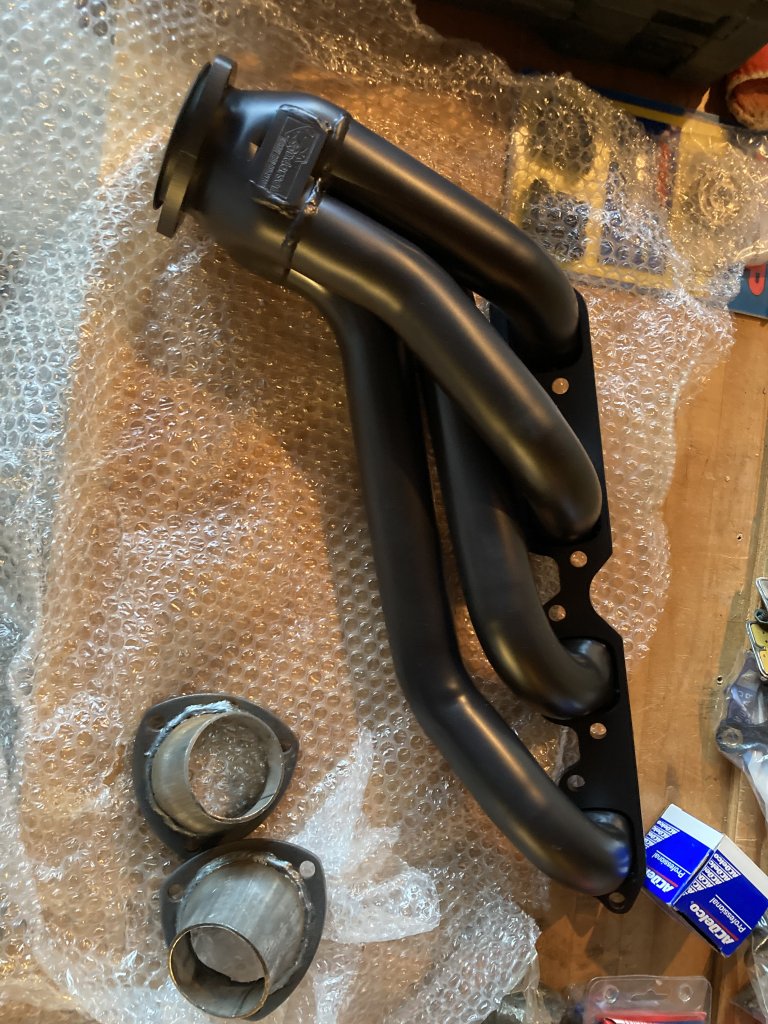

C10 old school headers do fit, original motor mounts work. Everything else from the past will not happen.

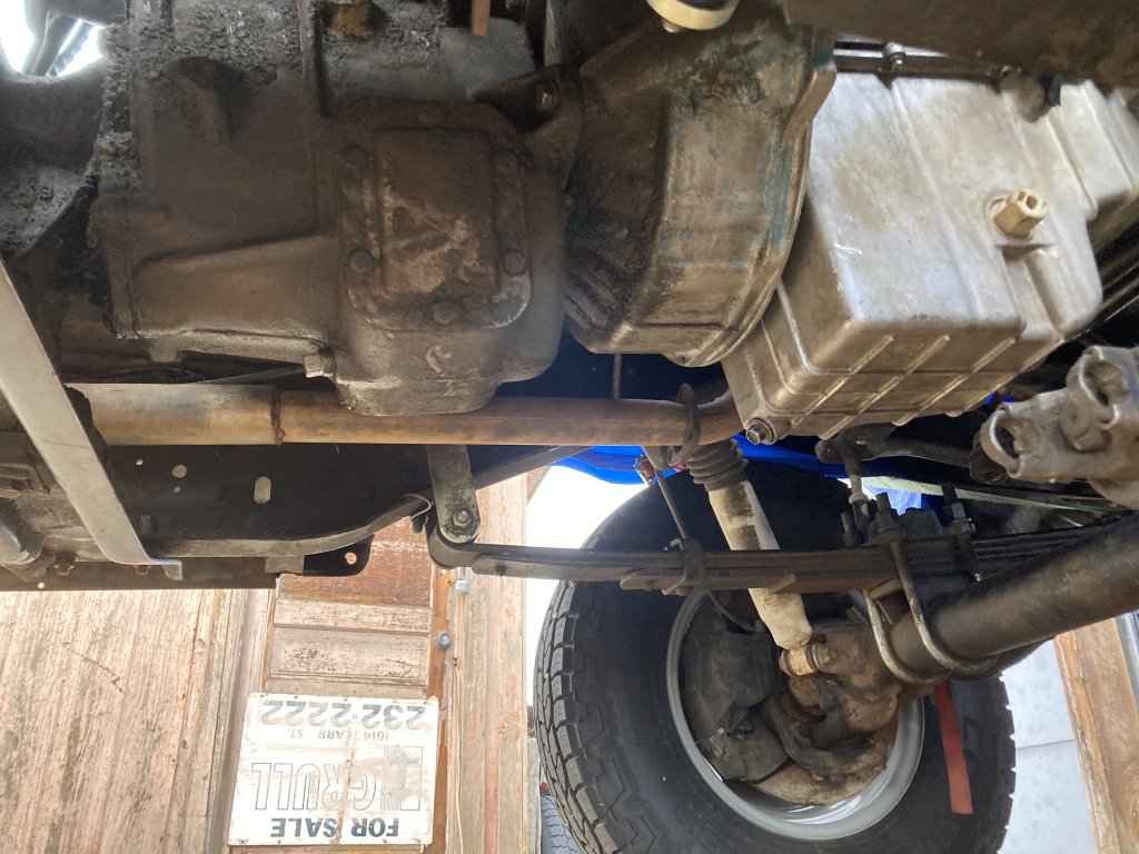

Did this swap in 2013 in my C30. look up 8.1 on here and it will come up. Swap is easier than a ls based swap. Just pullout your 350, swap over your flywheel/clutch/engine mounts and bolt it in. If you want air the frame will need notched or swap the van/medium duty truck stuff. One thing to remember is you’ll have to change everything on the front of the truck including the balancer. There is aftermarket stuff available. look up Amos Garcia on facebook. Makes some good stuff. Front crossmember will need a notch to clear the drivers side of the oil pan. Bigger radiator might be needed(used 6.2 diesel radiator). stand alone harness from Howell

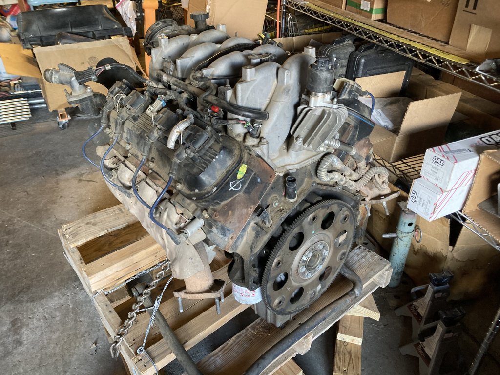

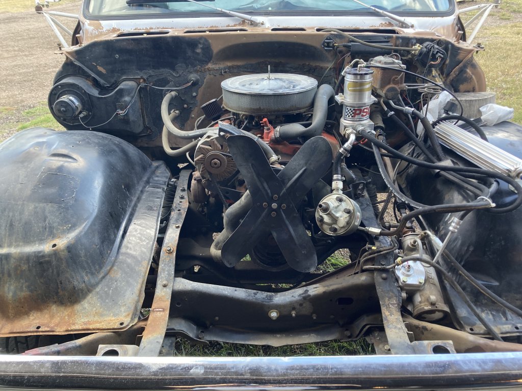

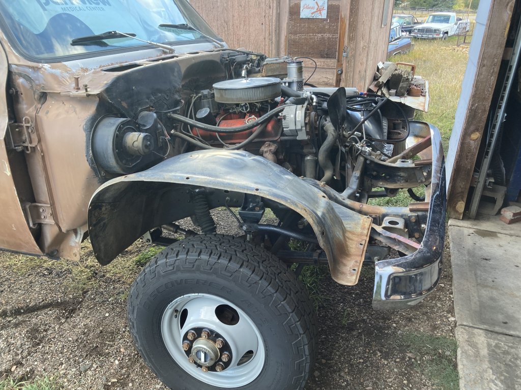

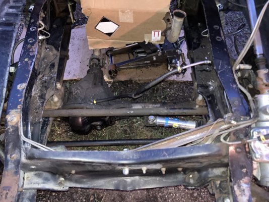

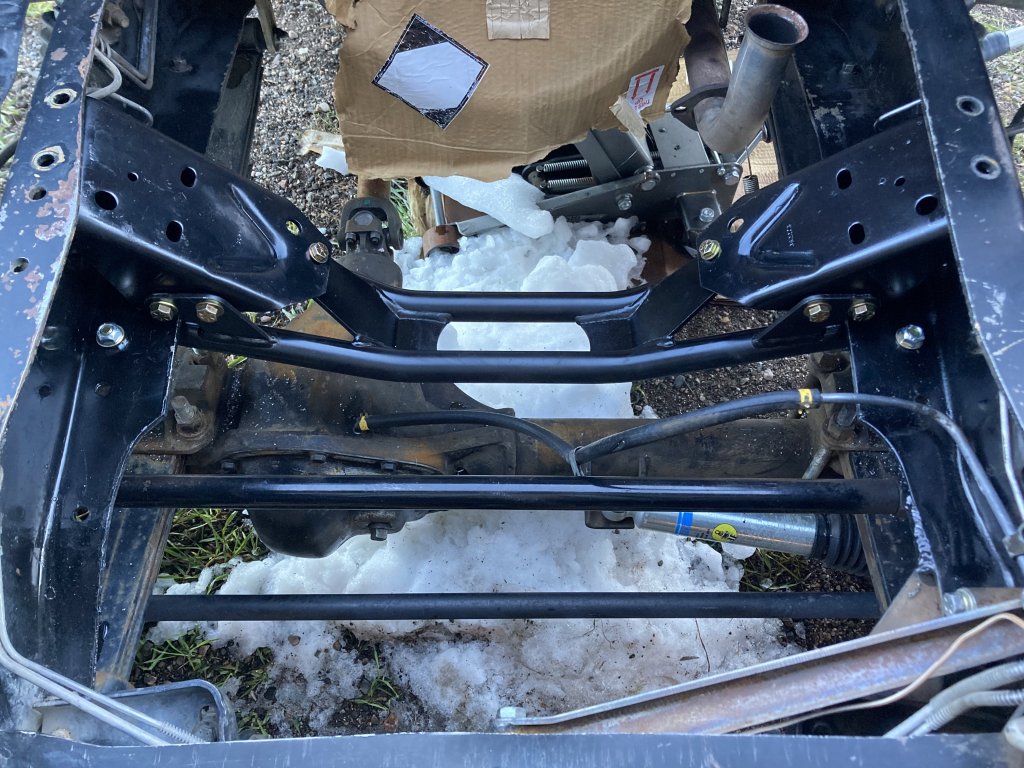

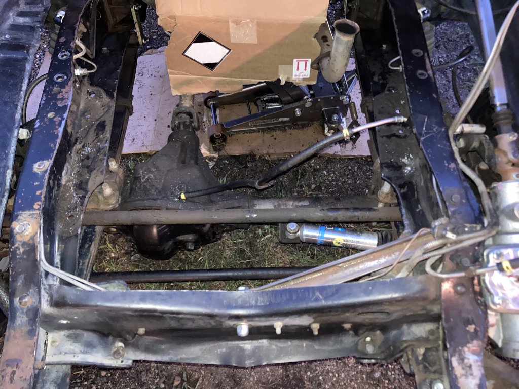

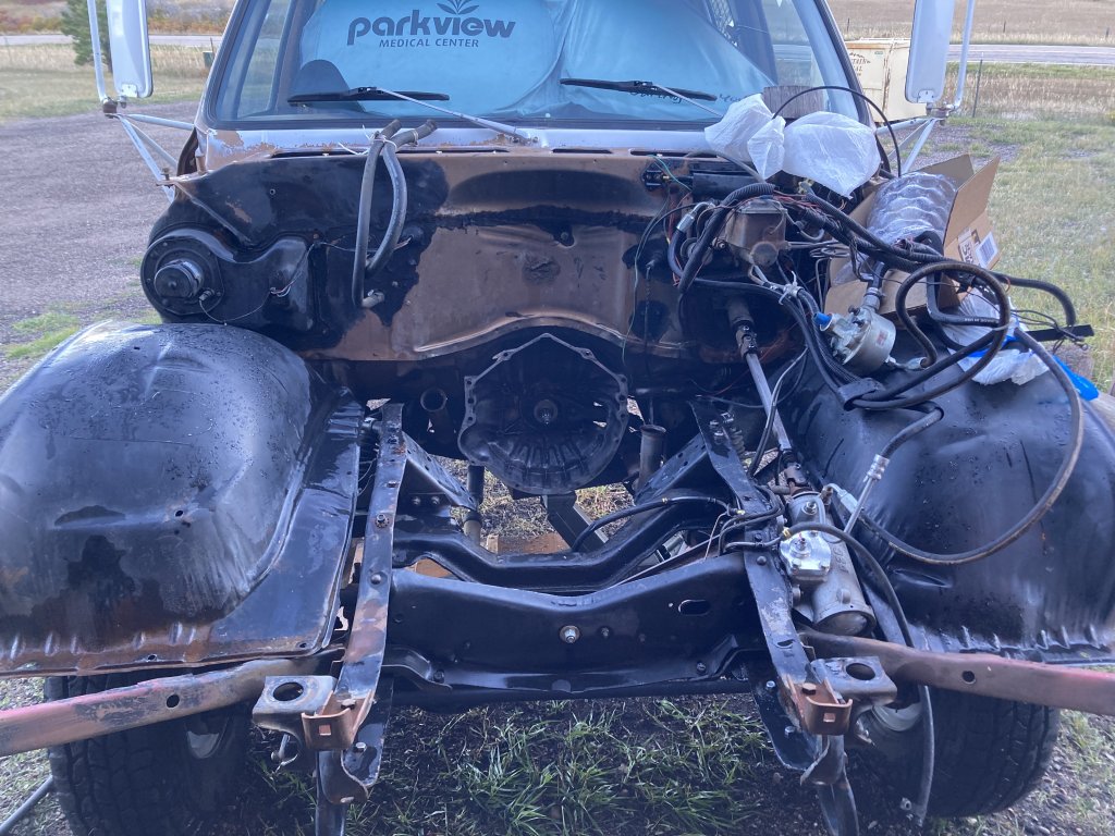

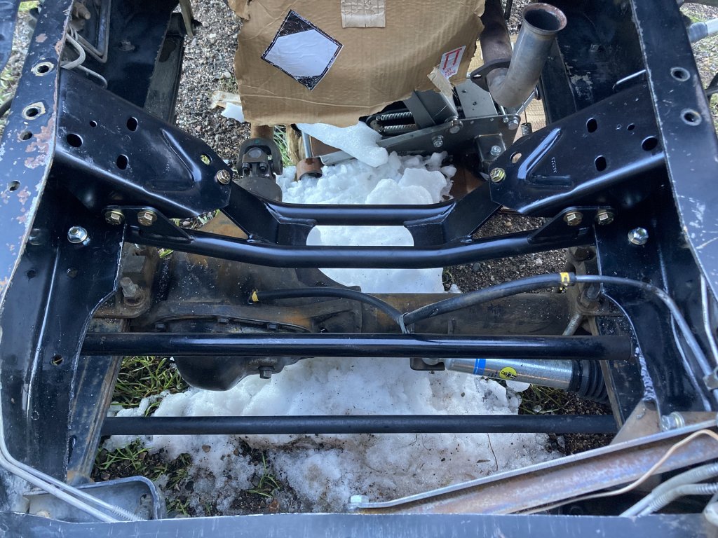

Slow train slow life but I’m back to work on the dually. Just can’t give up on the old truck. Got handful of parts for the swap and a list of things to order. The 350 looks small in the engine bay. I can’t wait for the 8.1. Anyone have a part number for the bolts that go through the bell housing and into the block? Thanks

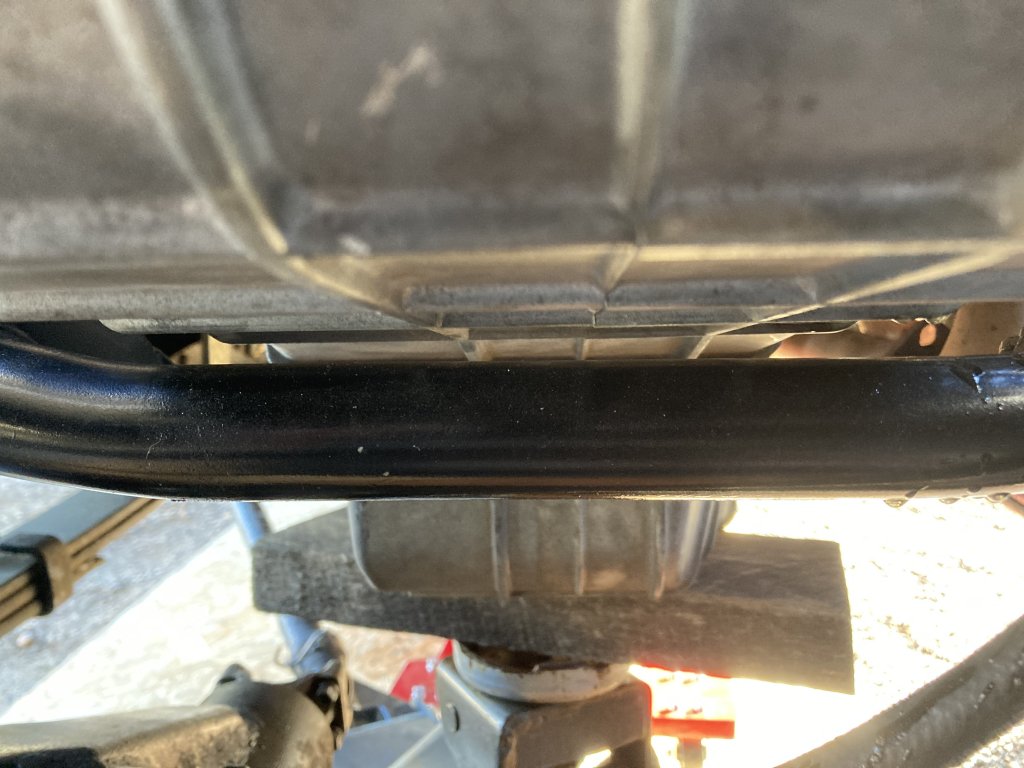

more progress

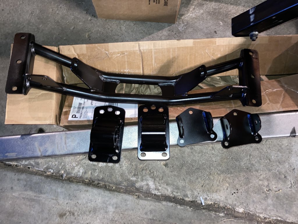

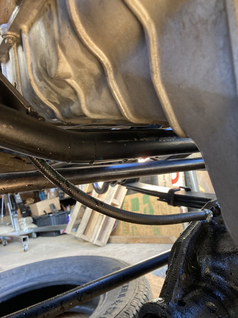

ORD engine crossmember and motor mounts

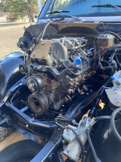

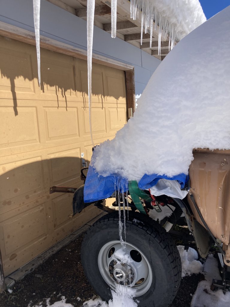

Some snow and some progress

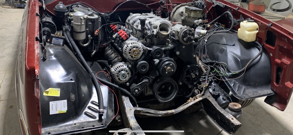

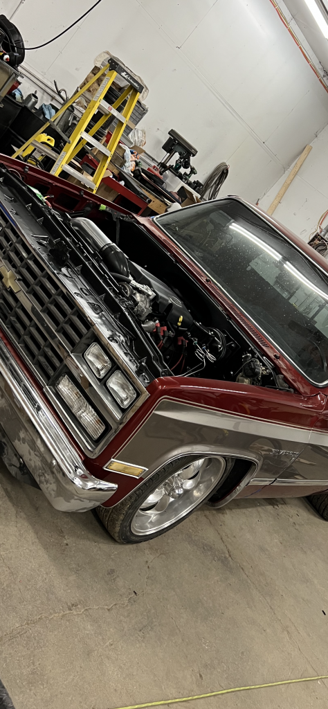

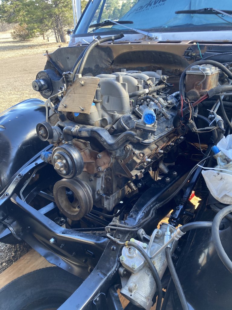

finally got the 8.1 in the truck

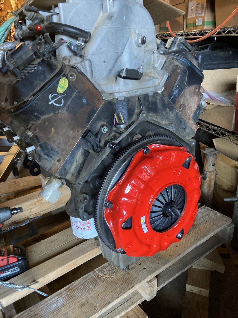

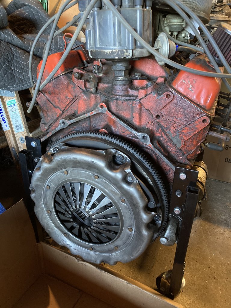

I removed the transmission so I could lower the 8.1 onto the motor mounts. Today I got the new flywheel new clutch and trans all bolted together
