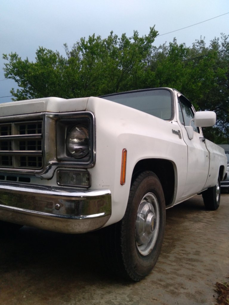

So, I need some new tires for my 78 c20 that currently has stock suspension. Im looking into getting new wheels at the same time. I want a wide wheel and tire look in either a 16 or 17 inch wheel. Ive been thinking I want to go for the 10 inch wide wheel but im concerned about the fitment on the front of the truck. Ive seen some other 2wd squares on the web with 10 inch wide wheels front and rear and supposedly theyve had no problems. I want matching wheels and tires on all four corners. From my research, the tire sizes that are more affordable and easily available are 275/70/16, 285/65/17, and 285/60/17. IF I was to choose any of these tire sizes and pair them with a 10 inch wide wheel, what offset and backspacing would I need to ensure they dont rub? I could also possibly go with a 9 inch wide wheel if I go 17's because those seem more common than the 17x10. Im just hoping the overall look would be very similar. My first choice in wheel is the procomp 69 series vintage polished wheels, or possibly a steel wheel in white. I like the idea of a wheel in something other than steel because in theory it should be easier to take care of and prevent corrosion in the long run. If anyone has pictures of an 8 lug truck with a similar setup please post pics and tell me how it went. Thank you in advance!:cheers:

For a little while I had 33"x12.5's on the rear. The wheels were 16.5x9.75". I'd have run them on the front too, if I'd had a couple more decent tires.
After that, I ran a full set of 16.5x9.75" wheels with really old 12.00x16.5 tires. They were very close in size to the modern 33"x12.5" tire. They barely cleared the front fenders, but they did clear.
Your truck looks like it might be slightly lower than mine in the front.

I think you will find that the most you can safely go on backspacing is 4 1/2” To 4 3/4”. Otherwise you will run into the tie rods. The larger wheel diameter you stated may give you an added advantage. Compare your current wheel to the tie rod, then measure your backspacing.

yea my truck does seem to sit pretty low in the front, im not sure what thats all about.
Alaska 79 K-10
when you say the most i can go is 4.5-4.75, do you mean i shouldnt go more towards 5 inches or more towards 3 inches, just so im clear?
So if i was to find a wheel in a 17x9 OR 17x10 with 4.5 to 4.75 backspacing i should be ok?
It looks like bucket fit a 12.50 wide tire on a 9.75 wide wheel so theoretically with a smaller width and diameter tire i should be ok?

Here's my '85 K30 with 16x10's 4.5" of BS and 305/70R16 tires (photo #1).
Those measure out closely to the 33x12.50x16.5's I had on my '80 C20 3+3. The 16.5x9.75" wheels back in the day had 4.75" of BS. A 33" tire with a 16x10 will definitely rub in the front. On my '80, I added Air Lift air bags to my front coils and got about 2" of lift. I added a 2" block to the rear. I had to do a minor trim to the front fender lip.
Photo #4, I had the old 33's on my Brown/Tan '85 C20 before they went on the 3+3. No lift on that one, but had to trim the fender.

So how about a 275/70-16 on my stock appearing 16 inch wheels? Theyre probably somewhere between 6-7 inches wide if i had to guess. I know a lot of guys run skinny 16 inch wheels from some of the more modern chevys with 285-75-16s on them, granted they usually have a lift, but my point is the 275 tire should fit ok on my wheels. Another idea i had is some dodge 17x7.5 steelies with some chevy center caps with a set of 285-65-17, but i cant seem to find those wheels locally.

275/70 should work fine. 285/75 does indeed fit on stock width rims and you should be able to fit that (more common I believe) size if that's what you prefer.
