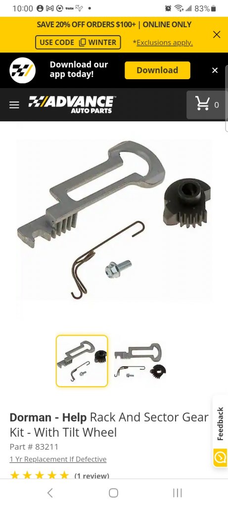

Thanks. Does anyone have a good youtube tutorial for this? I looked but could only find a video for a later model. I searched some threads here for ignition rack, it seems like people are describing taking more apart than the guy did in the video I found. Though I couldn't really tell because he jumped around a bit. The ignition rack was not his main repair.
Any other parts I should get to while I'm there? I've got the turn signal (for the 3rd time. Standard brand turn signals suck), and I already swapped the ignition switch. I have a new lock cylinder, though that does not appear to be the problem. What else? Also, anyone know where to get a replacement rack? I didn't see it on Rockauto or Oreilly. Thanks
