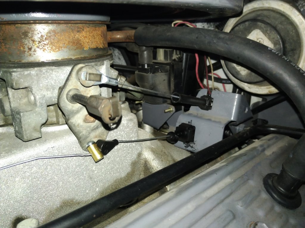

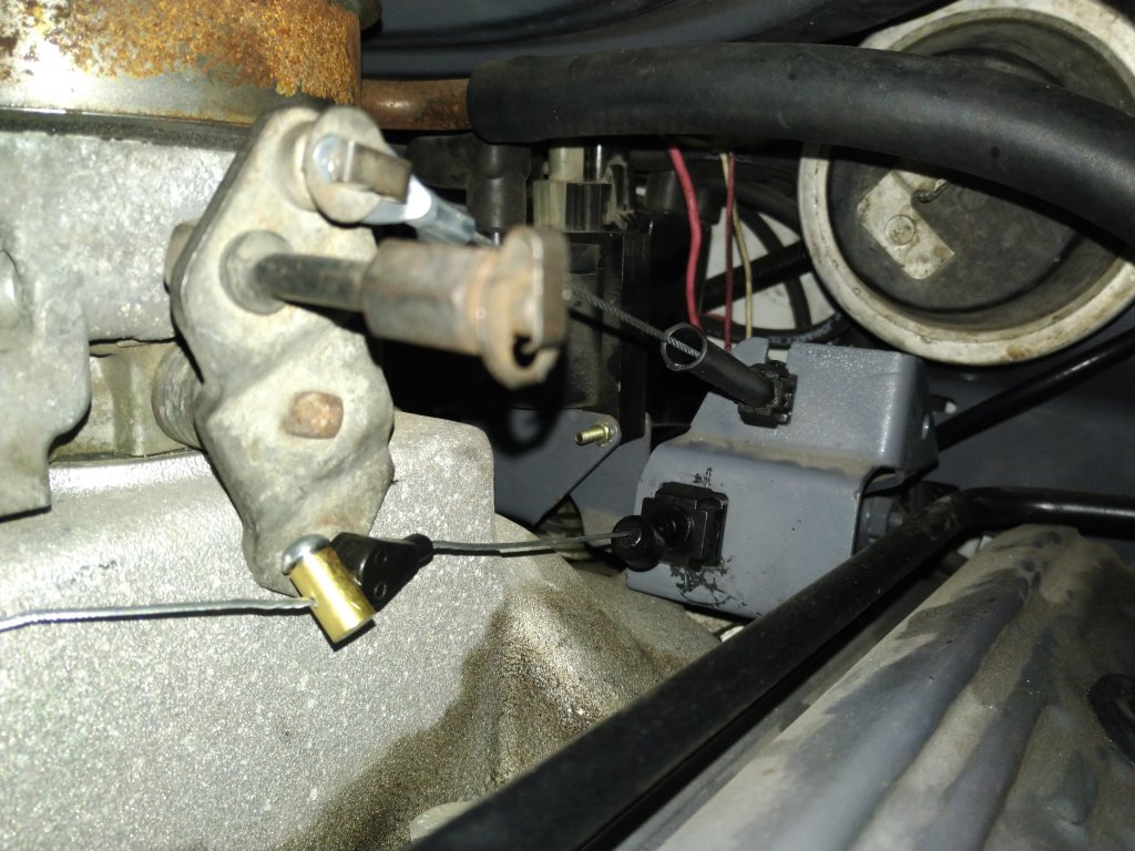

Here are some pics of mine..ran through the process of adjusting. Had some issues with the gears today going in and out. If popped the hood and manually did wot a few times, seemed like it would shift fine. After a few miles of easy driving, would go to downshift and be back in 1st hear with no upshift..It's a 350 tbi mated to a recent rebuild of a 700r4. Anything look out of whack? Think I need a different bracket for the cables?
Thanks

Sticking in first is often the valve it self in the valve body getting stuck. 700r4 Jr kit has the spring and spacer if that is the case

What he said !! ^^^ . Either that or a kinked cable but usually the valve is hung up. Sometimes you can free it up by removing the cable and using the connector rod to jockey the linkage and sometimes you get just a little bit more push and it'll free the valve and it might be OK forever. Just never know. But yes the Transgo Jr kit fixes alot of them minor details that can go wrong.

Burban is in the shop again. Guy that did the rebuild said he did a shift pro Jr style shift kit in it and is now having to take the unit out and inspect the guts. Hoping it's not in long, but thankful for warranty work.
