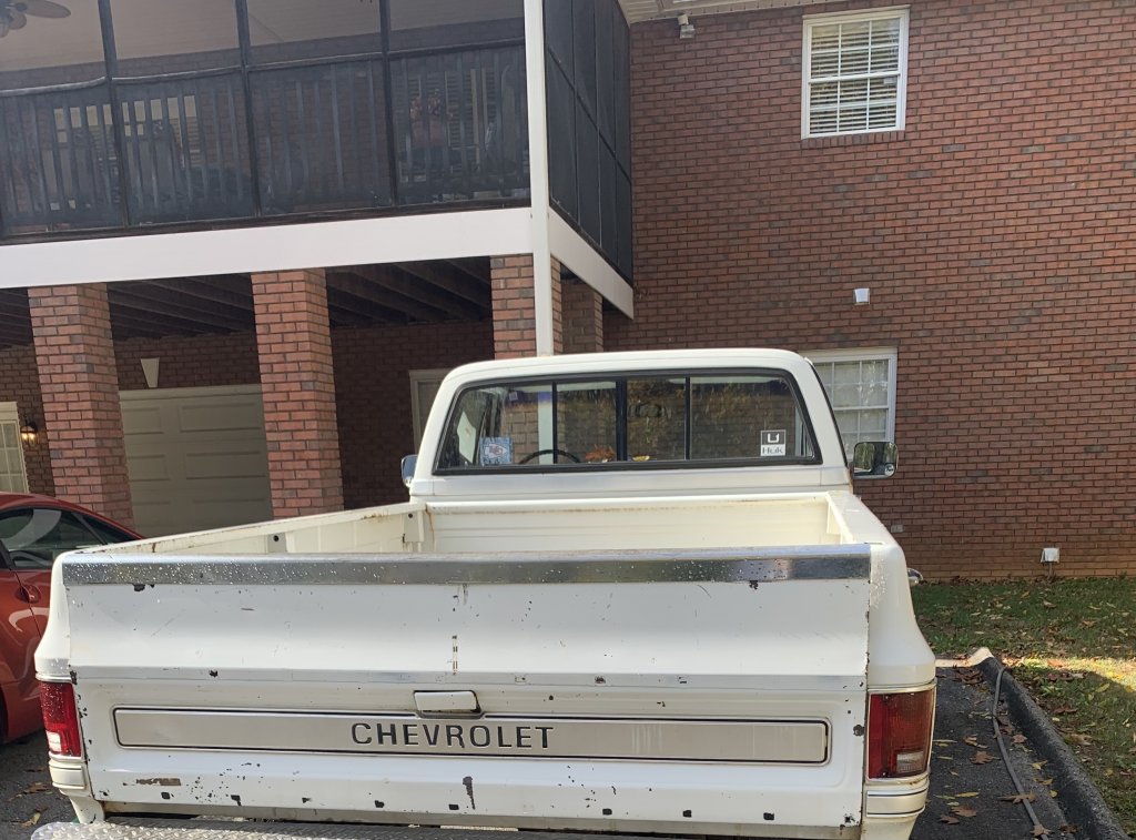

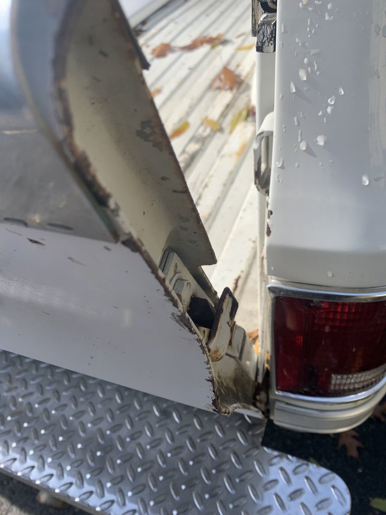

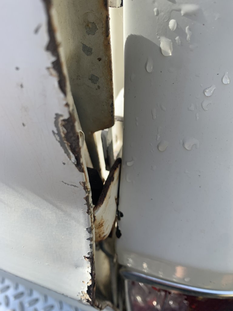

Hey guys so I recently picked up this 70’s tailgate for my 87 which didn’t have a tailgate and I’m having fitment issues. My question is, if I ordered some 70’s hinges for the bedsides, should that take care of the issue? Thanks

Near as I know it should fit.
Why does it look like the opening is too narrow? Are you sure the bed sides are straight?

You will need the trunions from the 70's tailgate to make it work. The newer ones are smaller diameter I believe and that looks like your issue.
