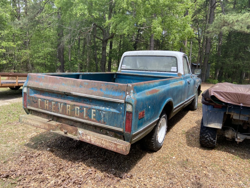

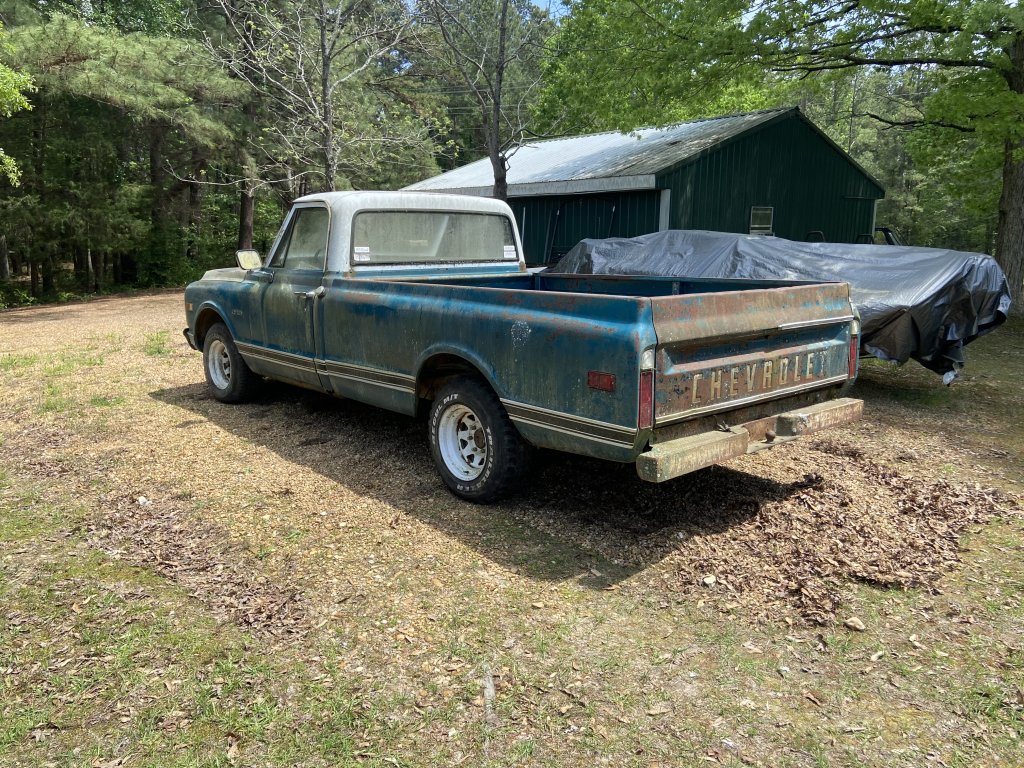

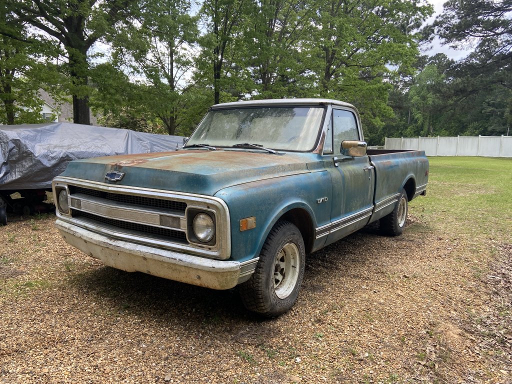

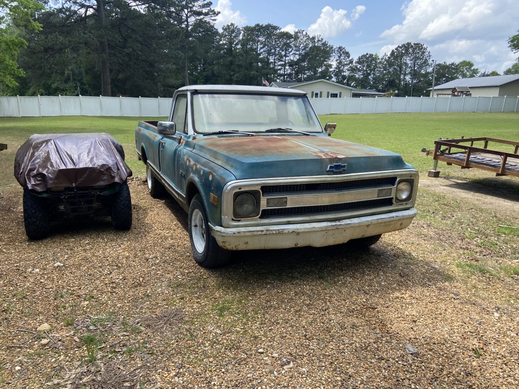

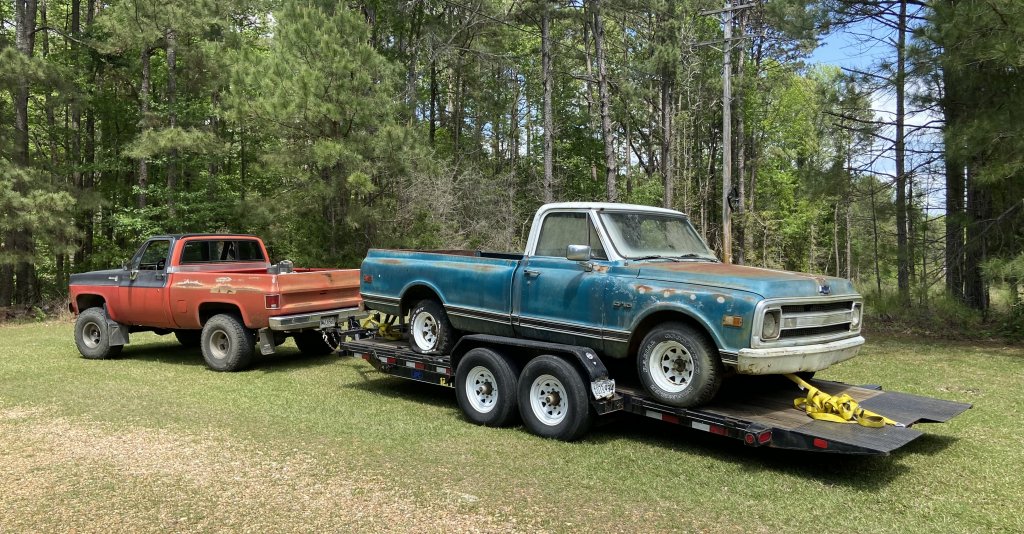

Picked up a 69 C10 this weekend to go along with my 77 K10. Yes it’s a long bed, I can live with that since it’s in good shape for a 69. I really like it’s patina, so a short bed conversion would end up ruining that. Not to mention, a long to short bed conversion can be pricey. It will need cab corners and rockers on both sides, most trucks of this vintage do. Not sure what direction I want to go with it yet. It has a 350, (not running) and 3 spd standard trans. Thinking for starters I will make it run/drive/stop and drive it as is for awhile. Then down the road do a full frame off with LS conversion. Only time will tell.

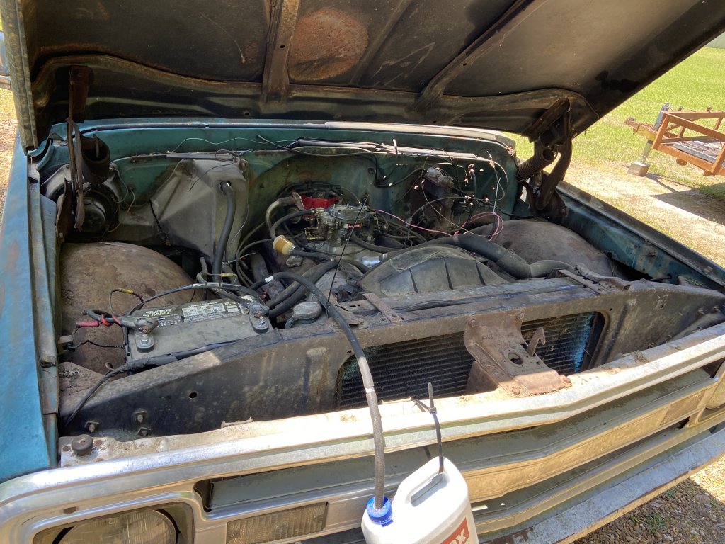

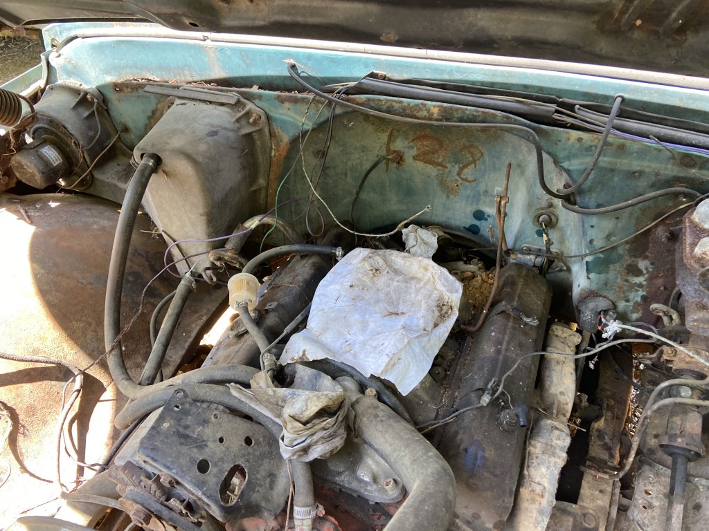

This truck has sat for over 4 years. I spent some time yesterday doing some forensic diagnostics. Found the purple starter wire had shorted out against the exhaust manifold and was burnt to a crisp. I fixed that and moved on to the normal things one does before cranking an engine that has sat. Oil and filter change, new plugs, removed old points distributor, primed the oil pump, installed an HEI distributor, replaced the carb, then ran a fuel to a can of gas. With just a quick splash of gas down the carb it cranked right up and ran great!! I wanted to go ripping around my yard but the truck had no brakes. Over all it was a great day.

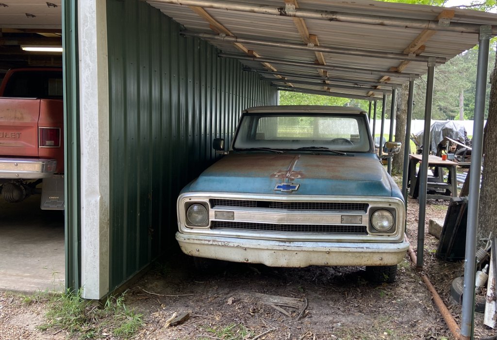

Built a cover off the back of my shop to store the 69 until I have room in the shop for it.
