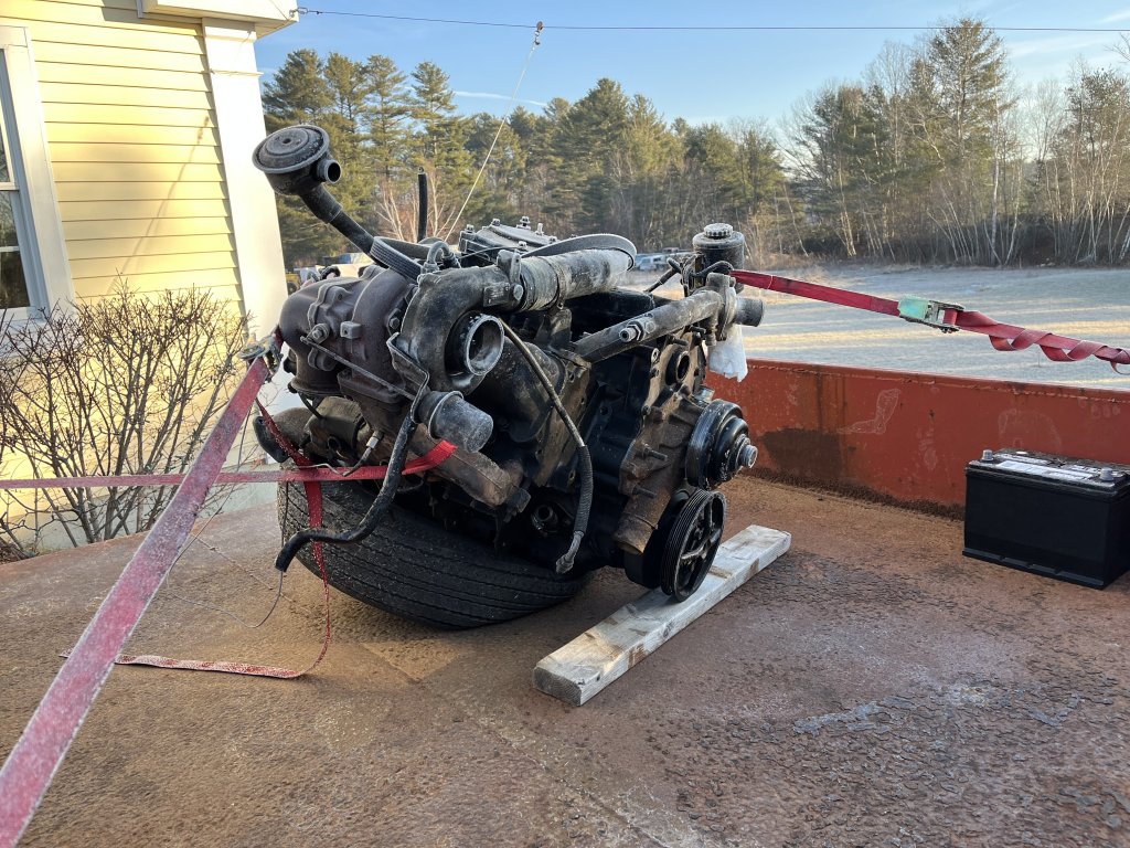

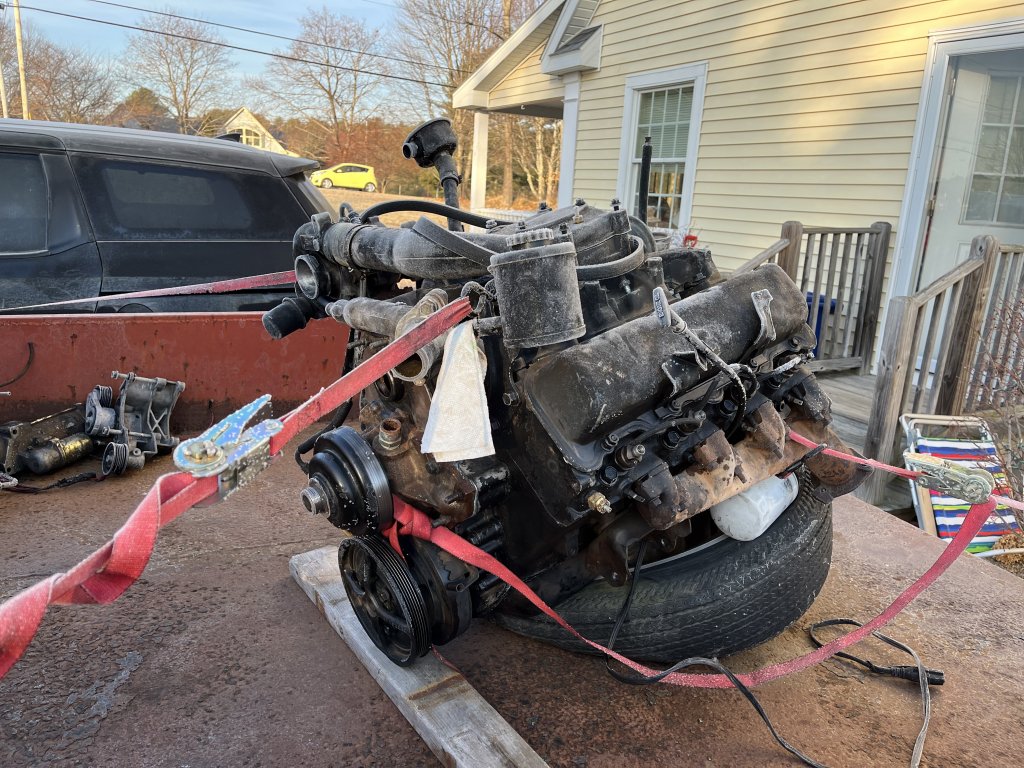

Figure I’ll start a slow and long build thread for my new project. I’ve been daily driving my ‘76 K25 for over a year and the fuel mileage is just killing me. 6-8 mpg depending on how much warm up time or plowing in the winter etc. it’s getting old. I know it’s a complete package combination that’s adding up to that terrible mpg. Non lock up th350, full time np203 4.10 gears etc.
I like the economy of my 6.2 in my suburban so pretty early on I was thinking about a 6.2 swap. I’ve got two spare 6.2’s but have been thinking about a turbo just because it’s out and I want one. I know and don’t expect any level of impressive power. Just want a turbo. I came across this 6.5 locally with supposedly a blown head gasket. But it’s complete minus the injection pump(I’ve got two spares) for cheap money. Like what I’ve seen just the turbo manifolds going for so I figured what the hell.
My idea is either check this 6.5 out and if it’s decent, head stud it, gasket it and run it or if it’s too far gone, just swap the turbo stuff on one of my 6.2’s. At the same time, I’m putting one of the good 700r4’s behind it. (Go crazy all you guys want about that. I’ve had good luck with them and know how to make them live happy lives) and also the np208 transfer case to get part time 4 wheel drive to try and get as much mileage as I can while still having a work truck. I don’t tow haul heavy and when I do, I know how to run it.
This will be a slow build as I don’t even have space in the garage for it right now but figured I’d make an actual thread about it.
