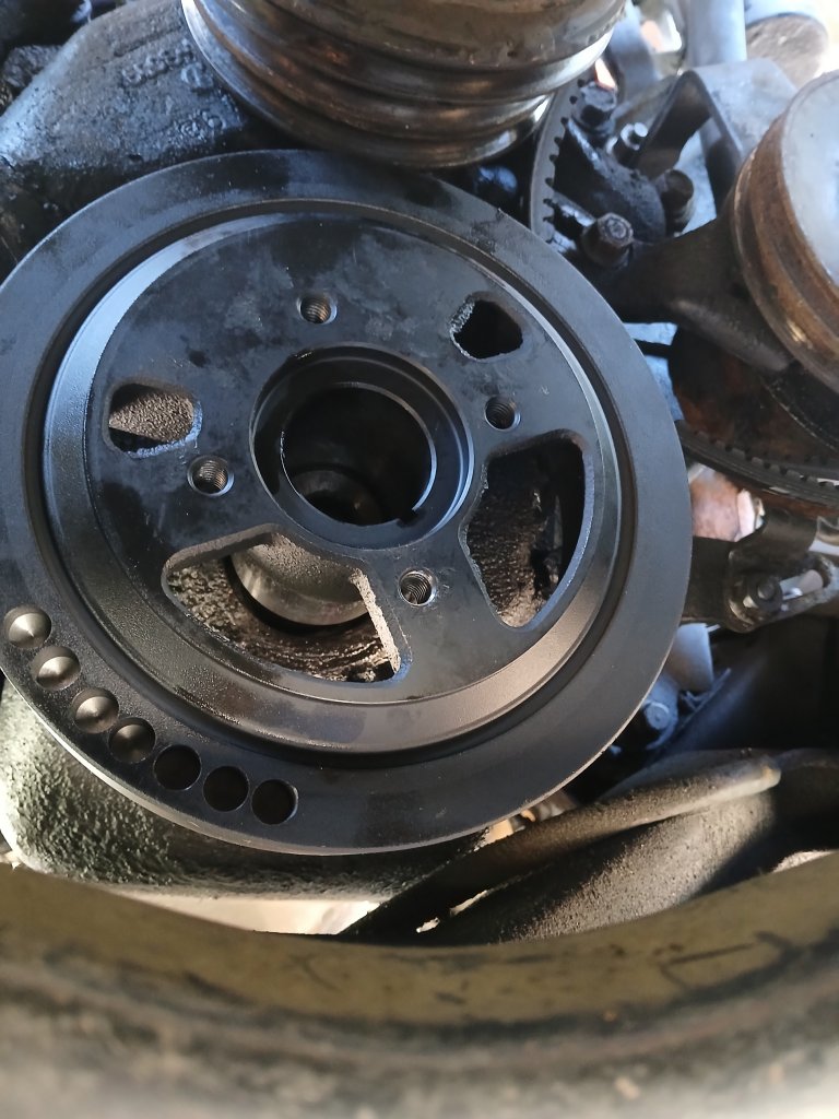

Working on an early 6.2 diesel maybe 81 or 82. Currently replacing balancer and I'm needing to find a longer bolt to install it. Does anyone know what the thread size and pitch is on the crank bolt? And even length in metric? If not I'll find out and post here what it ends up being. And hopefully save someone els the trouble.
Or am I trying to install this incorrectly? I'm doing it how I would a small block or big block.

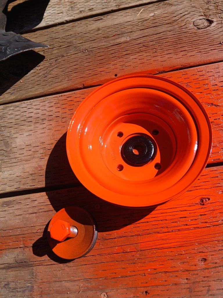

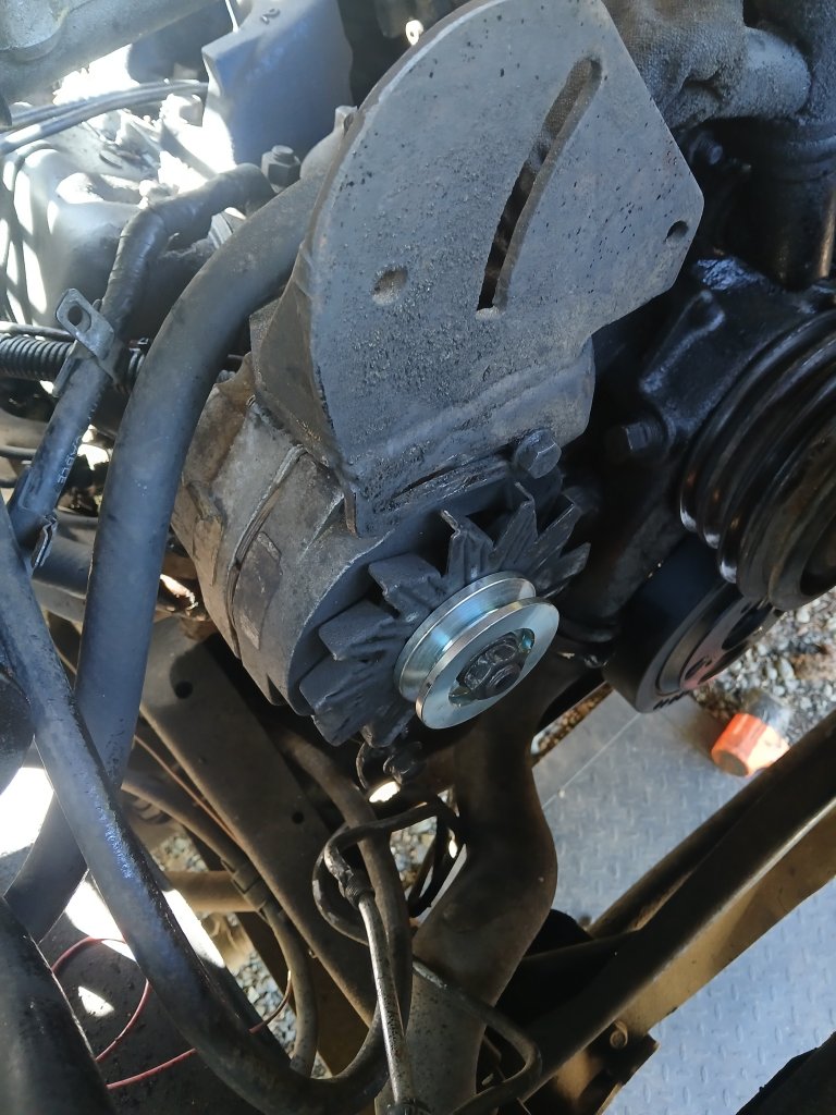

New alternator pulley lol. Painted crank pulley and hardware.

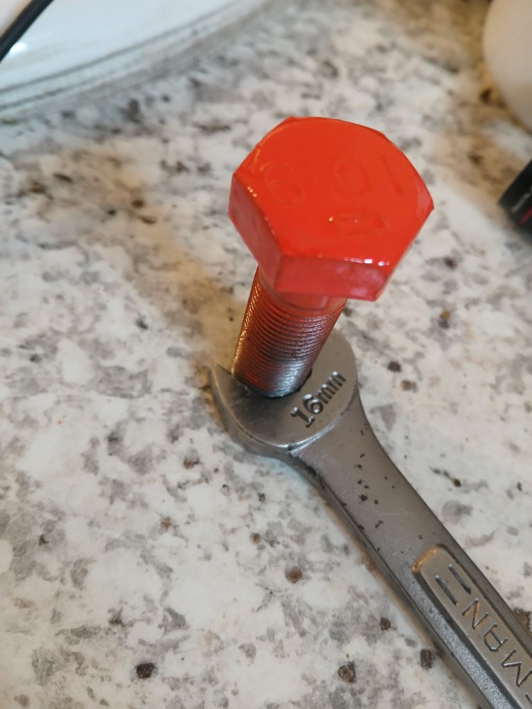

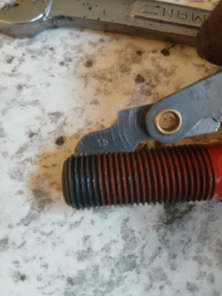

Looks like 16mm X 1.5
Good call Bill, I think I'll call Napa and find out about an installation tool.

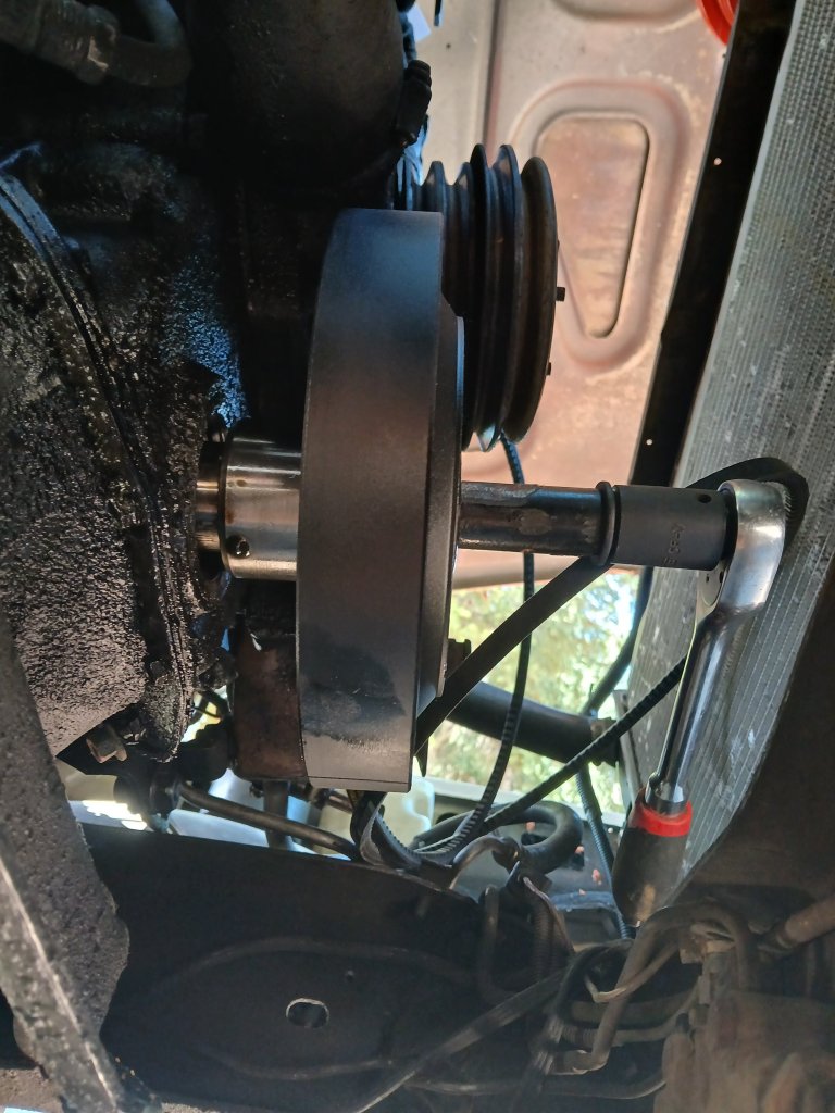

Bolt came in and I finally got to it yesterday. The new bolt Only threaded half way down but I found this super thick spacer that fit perfectly and it pulled/pushed it on most of the way and then finished with original bolt. Worked smoothly and my belts are running smoothly now. New Sound when engine idles. Not sure what it is yet. Hoping it goes away. It's probably pissed at me lol. Engine has some miles but is happy for the most part. That setup worked so good I painted it and labeled it.
