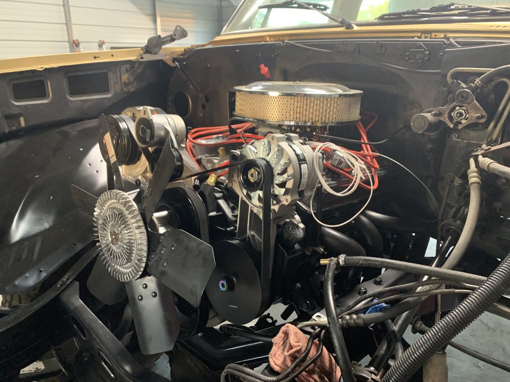

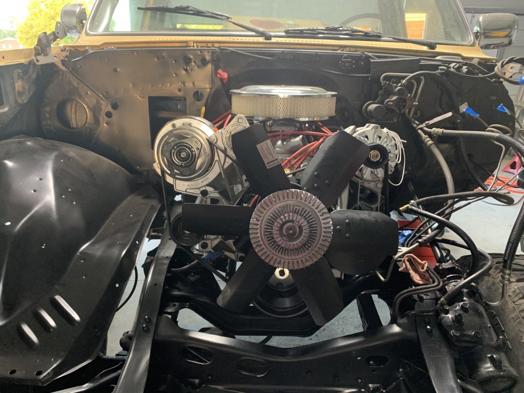

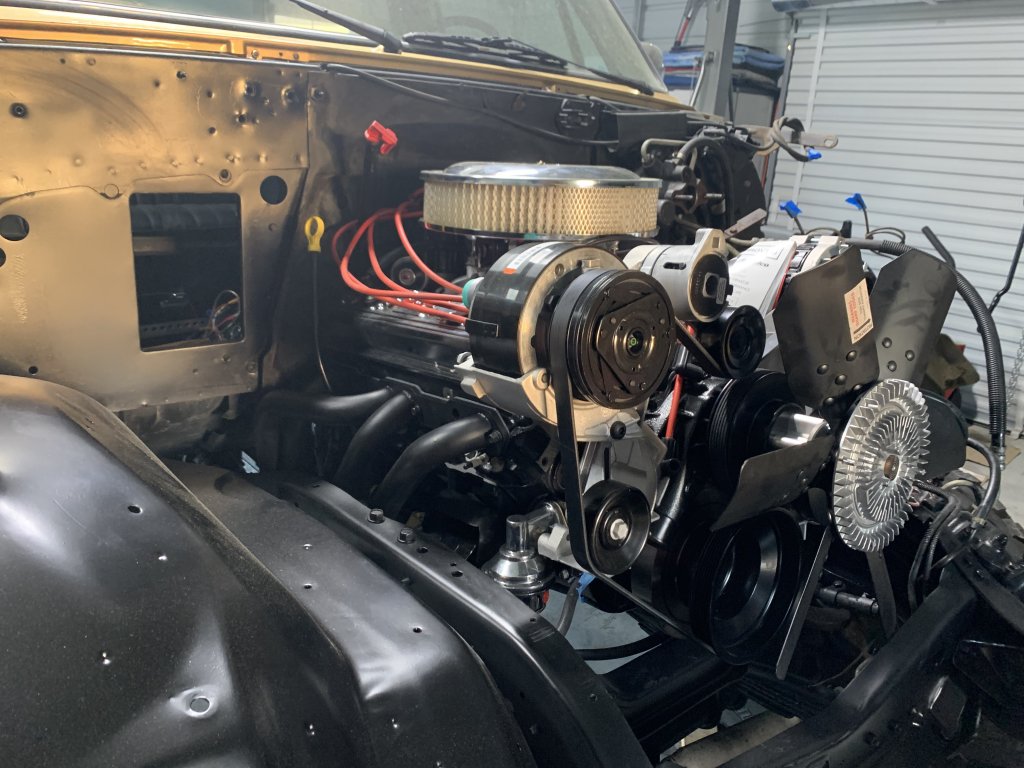

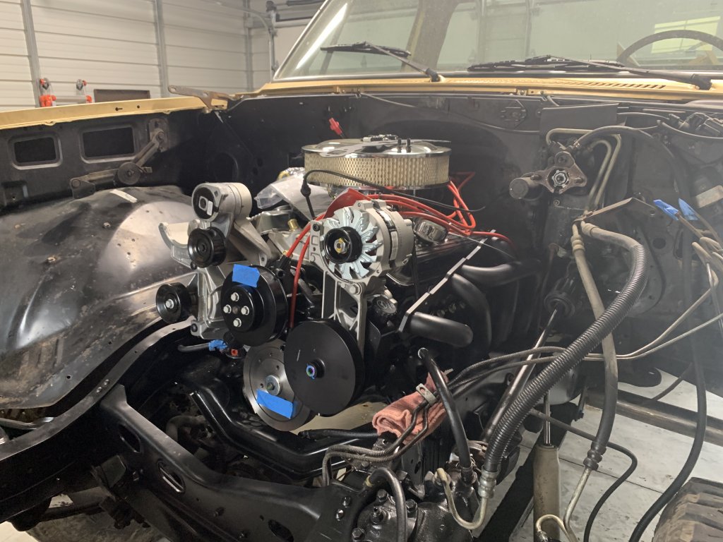

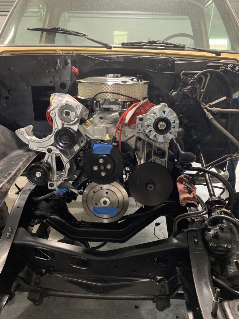

I did it recently, I changed fuel tanks, senders, motor and fuel pump obviously. The biggest thing I didn’t change that I should have was the fuel lines. I put in an inline filter and clogged three of them before I got it on the road. I also didn’t change my fuel tank change component inside the frame rails. If you have any specific questions let me know I’m happy to share as requested.
Btw… it was a full restore so also a painless harness.

Need pics?
