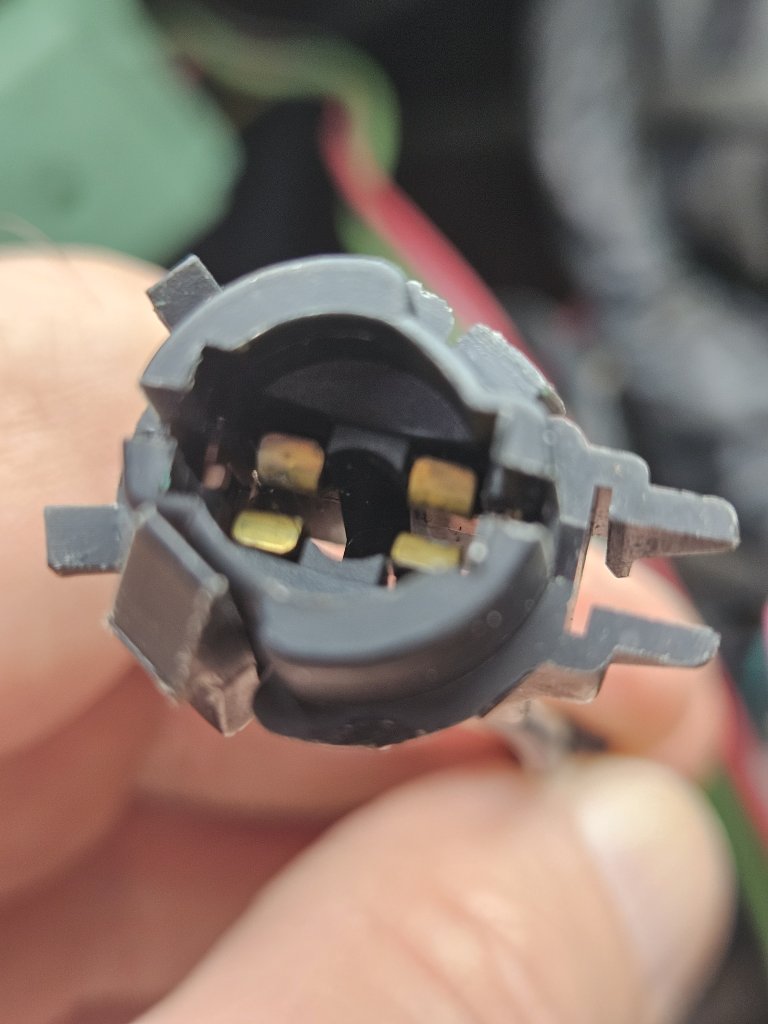

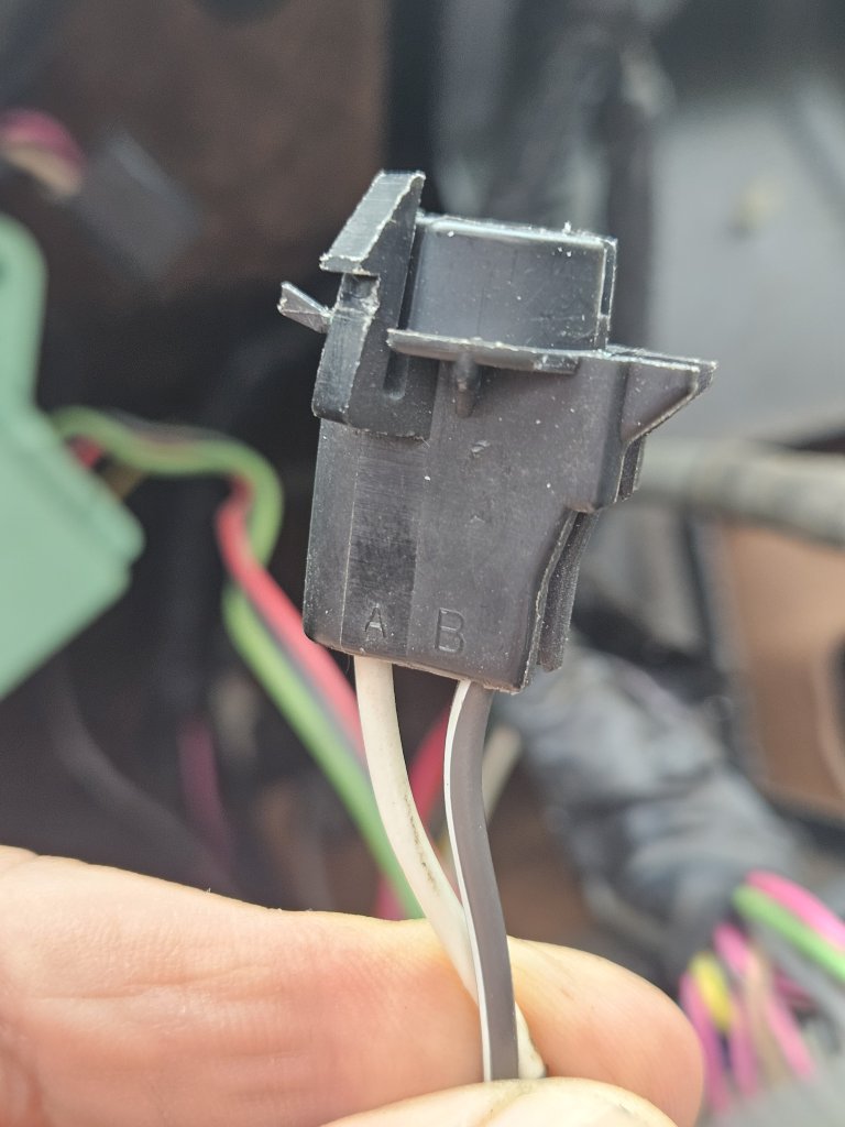

Are you sure its not the light that goes in the 4wd shift bezel to light it up when your lights are on?. Kind of easy to tell, if you turn your headlights on and it comes on with them then its not the 4wd indicator. if it stays on all the time, it isn't either (unless you drive in 4wd all the time). If it only comes on when you go into 4wd then of course it is the indicatorm, but there usually isnt a way for it to be showing from the dash unless someone did some redneck engineering... But why???. Just thought it might be worth pointing out there is an actual light that goes into the shift boot bezel so you can see it at night or low light conditions....

The light comes on and off when 4wheel drive is engaged and disengaged. It’s not an issue really just bugs me that it’s just dangling under the dash. I bave it wrapped around the e-brake pedal to keep it out of the way.
