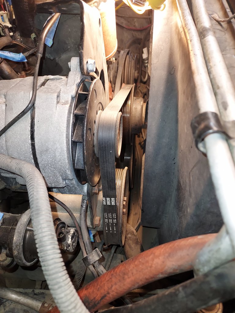

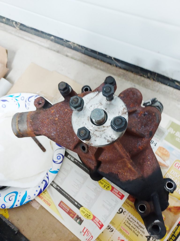

I saw a thread, but didn't know what protocol is.
I have an ACDelco water pump fixing to put in the rebuilt engine.
1) Clean-up and install? Worry about age.
2) Get a rebuilt? Same ACDelco, they don't seem to make a rebuilt kit...I know I don't need HP.
3) So, is this std. Or reverse? Yes, think newb, toddler running around with arms in the air. My head hurts.

I would swap it just to get rid of that rust. Just try to find a new pump vs. a remanufactured.
I'm not certain on big blocks, there may have been a longer version and a shorter version (definitely the case on SBC)
If it turns the same rotation as the crankshaft then its standard rotation.

Depending on how long it's been sitting on a shelf and the climate you may be better off just buying new. Here in the hot, dry desert I have bought new parts and not got around to installing them for years. The seals and gaskets dry out and shrink. The first time you use it, it leaks.

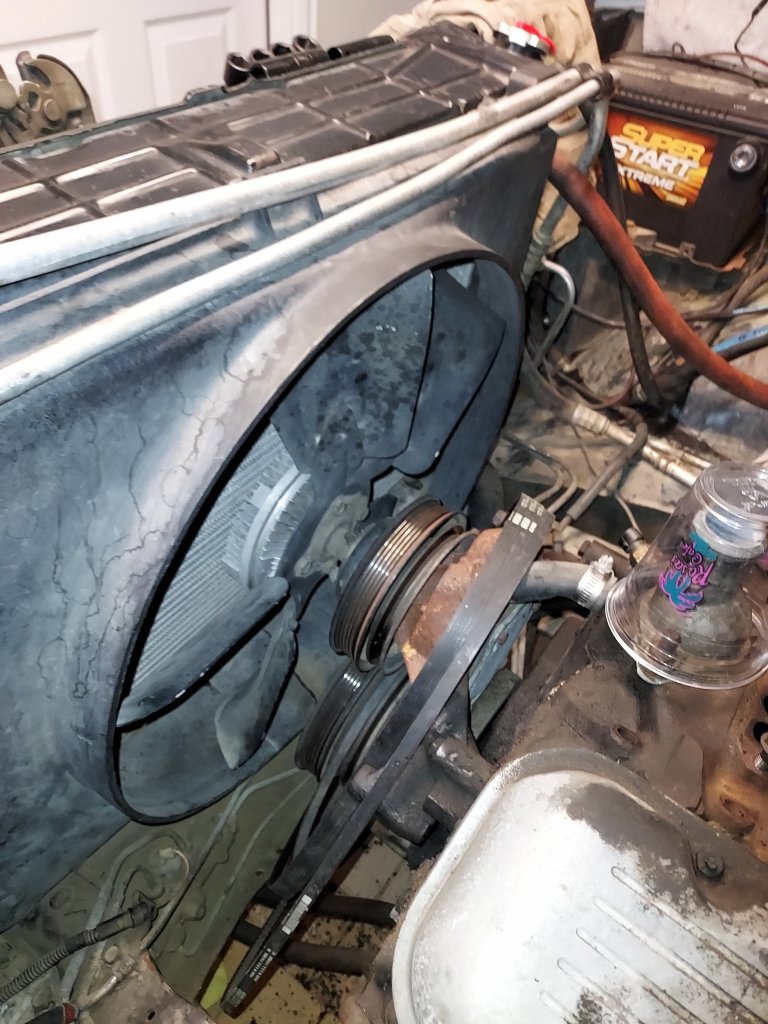

Standard.
Did you also see fan blades in pic? So, it rotates clockwise in drivers seat? So that pushes air into radiator vs pulling?

There are reverse rotation fans and clutches as well. They are usually used in serpentine belt systems where the belt snakes around the pulley and spins it backwards. On the pump, the only positive way to know is to pull the back cover off and look at the fins on the impeller. But yes, they all need to match.

The belt set up pictured should be standard rotation, there is a multi groove belt there but it's not routed like a true reverse rotation serpentine belt.
As far as long and short pumps, that is a real thing however the set up pictured is a long type. The short pumps were 60's applications with very different brackets.
Buy a new pump. Don't gamble the cost of a rebuild on an old pump that costs $50.

Cool, got the long pump, and going new.
I have the acdelco model#'s. Any prob with new duralast? Otherwise parts express has acdelco at $200 + shipping.
