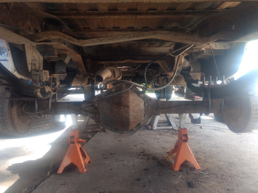

OK, little steps towards getting this back together.
Finally had enough time and felt good enough to finish removing the passenger's side spring and shock, took about every saw blade I just bought to get the front spring bolt out. New springs are in place, everything's ready to torque down, everything lined up fine.
Now I just need a break in the weather, it's either been way too hot or storming (like right now). My goal is to have it back on the rear wheels before the end of the weekend, weather permitting. Then I have to deal with a valve cover gasket that didn't seal up on the driver's side and do a transmission fluid/filter change, at that point I think I can use it far more than before the issues. Here's a shot of the progress so far -- thanks to everyone that has given me advice so far. Getting this "to do" list wrapped up will allow me to get back on the 85 GMC project!

SUCCESS!
Everything is reassembled, torqued, and ready to reinstall the tires. Thanks again to everyone that provided advice, it was a royal PITA but having a good, SAFE, rear suspension setup is well worth it.
I had already replaced the front shocks, when I took the rears off I realize that it needed all four -- glad I bought the full set when I did. Now on to that valve cover gasket and transmission filter change.
