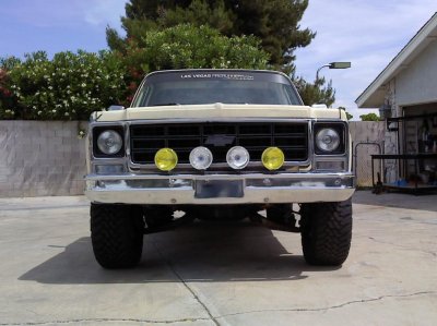

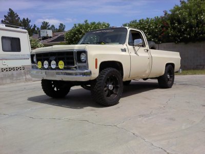

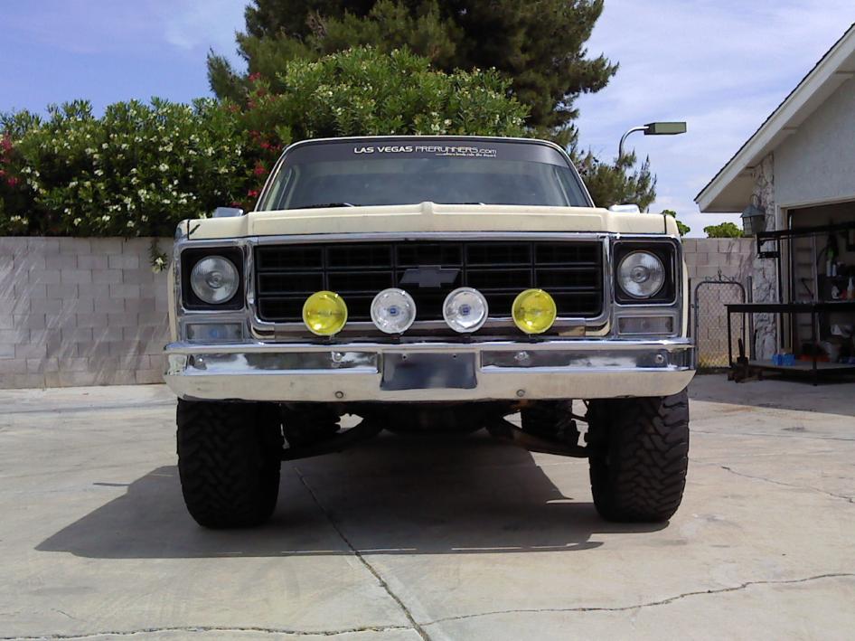

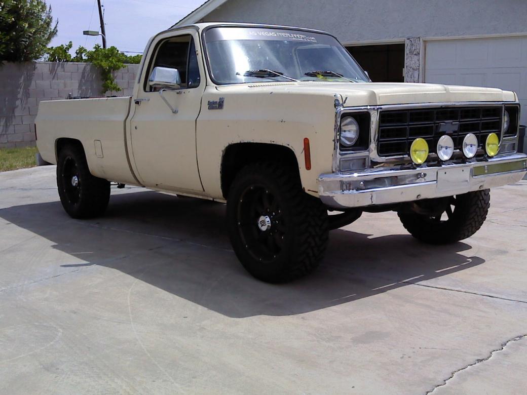

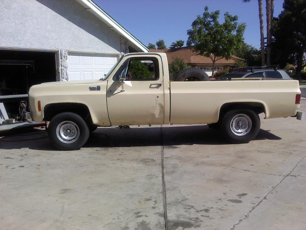

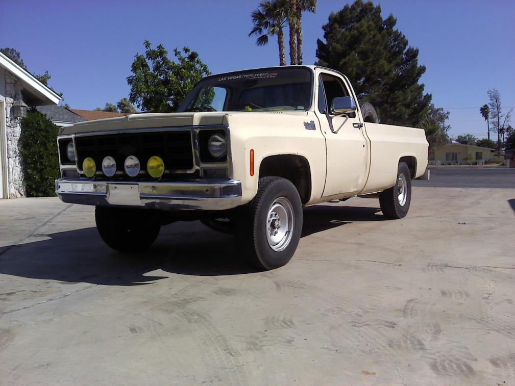

Henri
my '79 C20 was lifted with a set of (no longer made) Fabtech front springs (my buddy had them still in the box new sitting on a shelf for years). I used a set of spacers for the upper ball joints that i got from airbagit.com (I HATE THESE GUYS! and i will never order from them again). but anyways, i added some replacement Rancho 5000 front shocks. but, these springs over power the shocks in rebound easily so I'm trying to figure out a shock that will control the rebound as the spring rate is a bit much. adding weight did make it ride better as i added a dual battery set up to the front and i think that the weight of a new heavy duty bumper and winch would also help. if you are running a big block i think it would ride just fine. but i have a small block.
next i plan on adapting a set of front lift spindles from a newer body style chevy as i hear that they will fit the ball joints of my 3/4 ton suspension. this should give me another 4 inches of lift over the almost 3 inches that the springs gave me. the rear will be getting some new 6 inch rear springs/shocks. my goal of running military hummer tires on modified military hummer wheels. but they are 37x12.50/16.5's so a body lift may be in my future.
here is my truck with 33x12.50/20 tire on 20x9 wheel. the front has the Fabtech springs and spaced ball joints. the rear is factory stock including the shocks. also i added a picture of the truck sitting on stock wheels/tires.

Wow, not bad. No steering issues? Or ride issues? 7" of lift, damn, like a pre-runner setup. :popcorn:
AntiBling
Oct 27, 2012
6
Las Vegas Nevada
Henri
I'm in the desert so i guess it looks a prerunner type set up. I use this truck to haul my quad out to the dunes and desert. it rides a little firm but not bad at all. the rebound is a bit of a problem (because of the high spring rate) if you hit a dip at speed it will launch you a little bit. no steering problems at all. i took it in for an alignment after the install and everything adjusted just fine with just a couple shims in the upper arm cross bars and a toe adjustment. i really want to run a larger diameter tire to combat the washboard dirt roads i drive on and military hummer tires are dirt cheep ($100 each @ 100dollorman.com) just getting them to fit is going to be the challenge with out going to a straight axle set up. that why I'm going with the lift spindles. i haven't touched the rear suspension yet. that is why it sits the way it does (prerunner style) because this is a budget build i am thinking of doing a shackle flip in the rear and a 2 inch block.

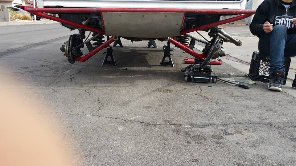

i have 7inch mid travel arms with a 3inch coil
